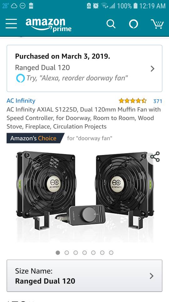

Our lopi had one of the motors burnt up on the blower when we moved in. I replaced them both with some fan motors I tracked down that matched. It is quieter than when we moved in, it's still annoying. I turned the blower on while my 5 year old was watching cartoons, he asked me "why you do turn that loud thing on all the time?"
I ordered these after reading someone's comment about computer fan type thing. If they blow enough and are quiet I will make a plenum for them with my metal break (brake?). Screenshot_20190304-001932_Amazon%20Shopping.jpeg
