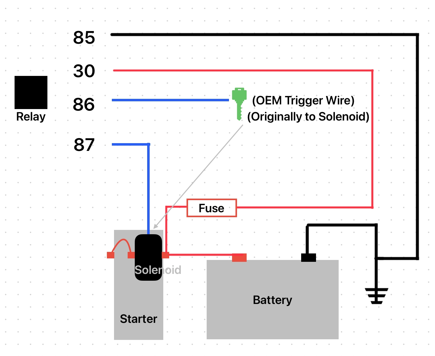

Likely not enough voltage to the solenoid, generally caused by resistance in the low amperage ignition wiring and / or safety switches. Check the voltage at the solenoid while trying to start the machine.
A popular fix is to add a starter relay, so the relay is activated by the OEM wiring, then the relay provides power to the solenoid directly from the battery.
A popular fix is to add a starter relay, so the relay is activated by the OEM wiring, then the relay provides power to the solenoid directly from the battery.View attachment 871930
Thank you for the diagram. Well explained. Yes battery is well charged and terminals are clean and tight. Nine grounds to clean on that tractor from engine to body and other electrical components. I did every one of them both sides. So that's like 18 points of grounds to clean paint off and make a good connection. A common problem with tractors made in India is the frame is already painted before anything electrical is attached. Therefore poor grounds off the hop.

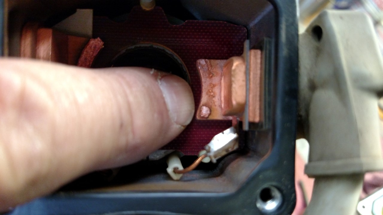

Is it the solenoid that's clicking or something else? Press your finger on the solenoid body and try to start it, you'll feel the clicking if it's that. If it is, it's the solenoid at fault. You can take them apart and clean up the copper contacts but it's probably better to just replace.
   / Starting problem click click #9

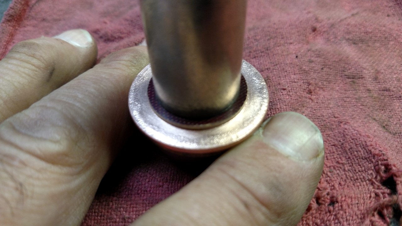

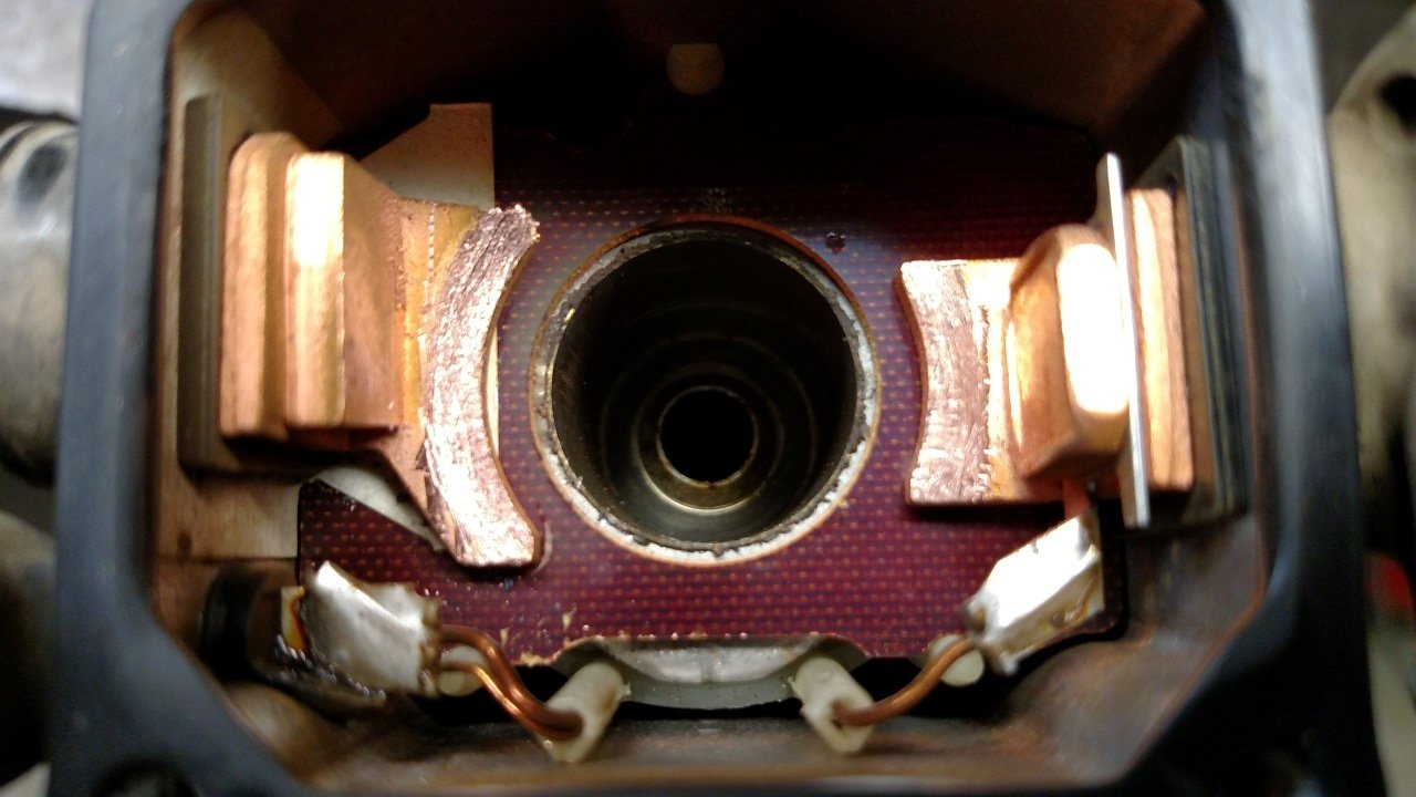

I had that problem with my BX a whiles back. Took the starter off, took the solenoid apart and found a little tit of copper had grown on one of the contacts. Used a Dremel to remove it, cleaned up the contact plate and both contacts, put it together and put it back on. Started right up.
The round contact on the plunger cannot tip so it can make contact when the little tit builds up and prevents the plate from contacting both contacts, so the starter won't engage. Nor can it be removed and flipped over, unlike those on a lot of Delco starters could, so you just have to clean it up and reinstall it.
