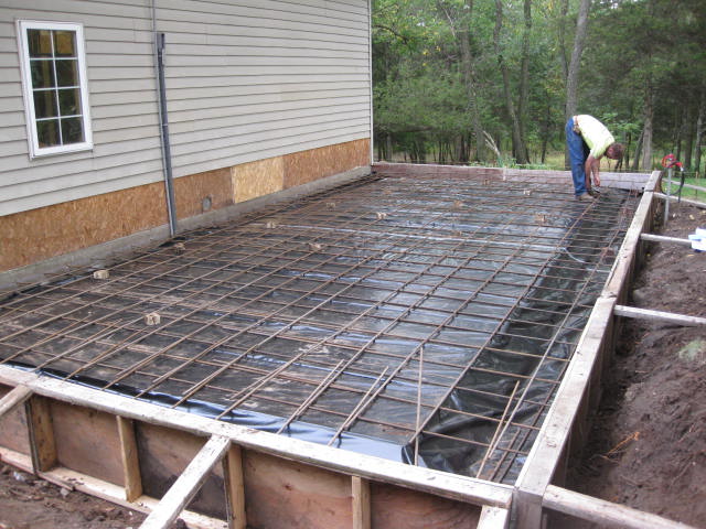

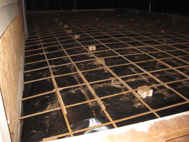

I used mesh for the approach on on my garage, used chairs, and like every one said you can't keep it pulled up. Adding on to garage and used #4 rebar 1' oc, on chairs, looking back seems a little over kill.
I don't see any chairs, just bricks.
