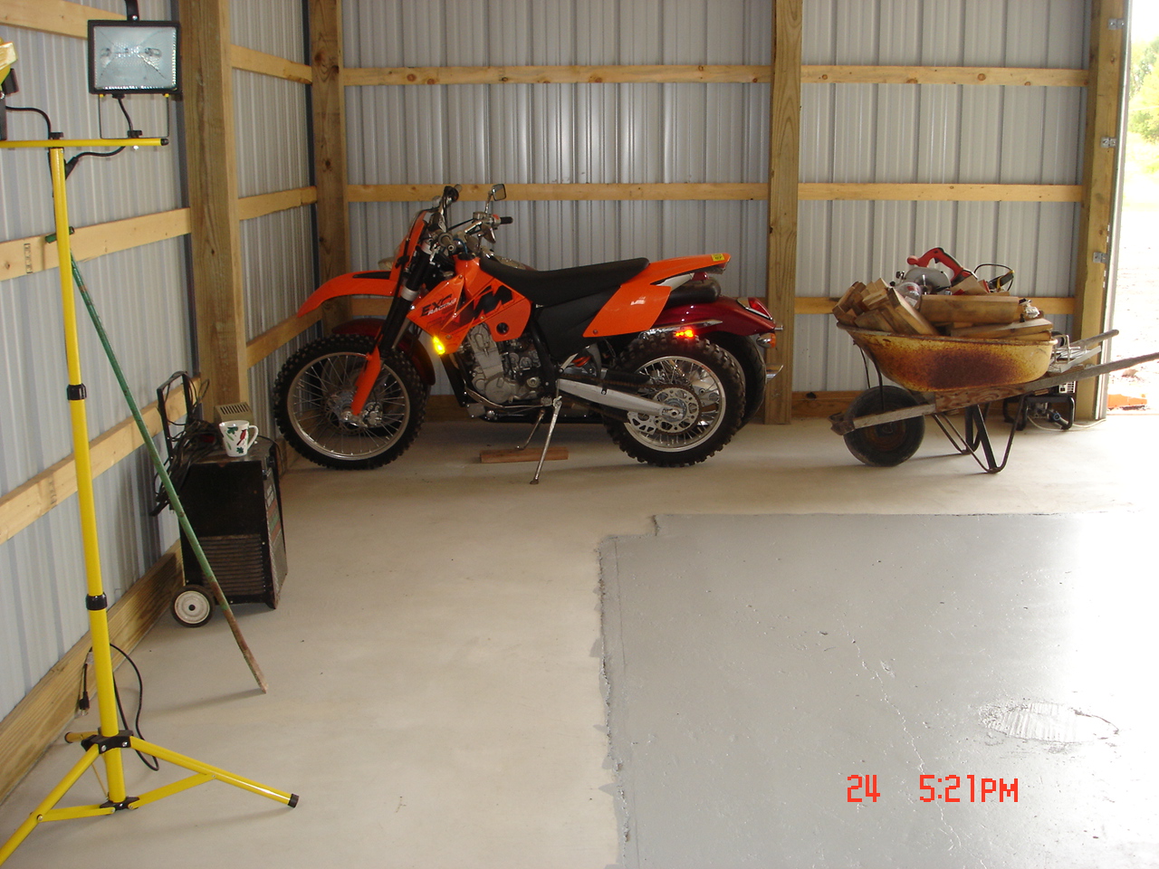

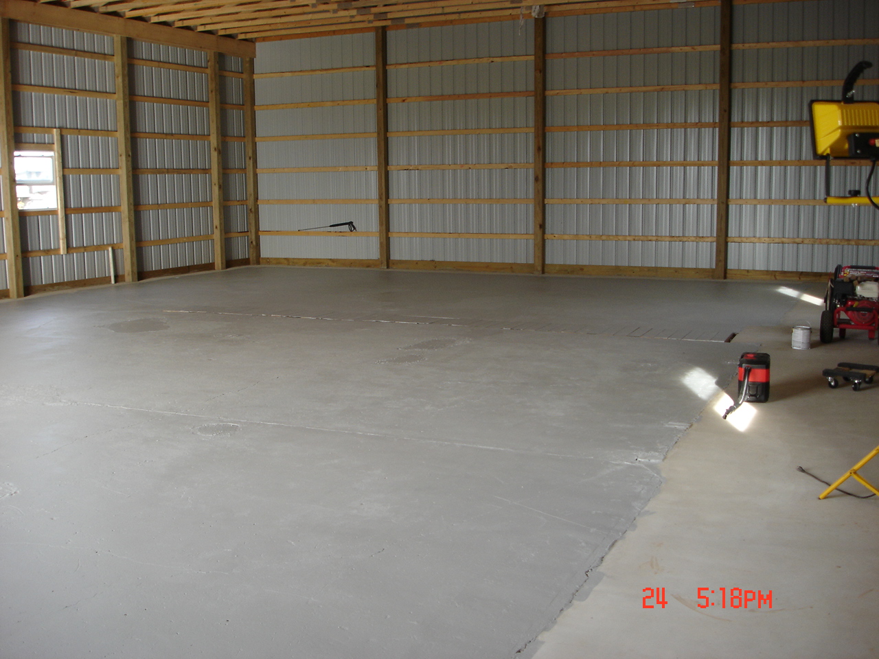

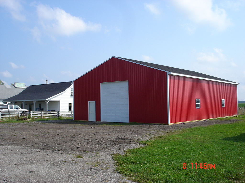

I guess that the point I was trying to make to the origioanl poster is that in my opinion if you had to make a choice between steel mesh or fiber in concrete, I would use the fiber on thin pours. I got a little carried away in my explanation of why I would do that.
I just tried to show the reasoning behind my personal choice if I had to pick between those 2 options. (steel mesh or fiber in concrete)
If I had the latidude to do something else I would use both steel and fiber on thin pours, the fiber for the strength and the steel for the insurance of maintaining the elevation of the slab if it does happen to crack. In fact that is what I did on my barn rebuild project.
