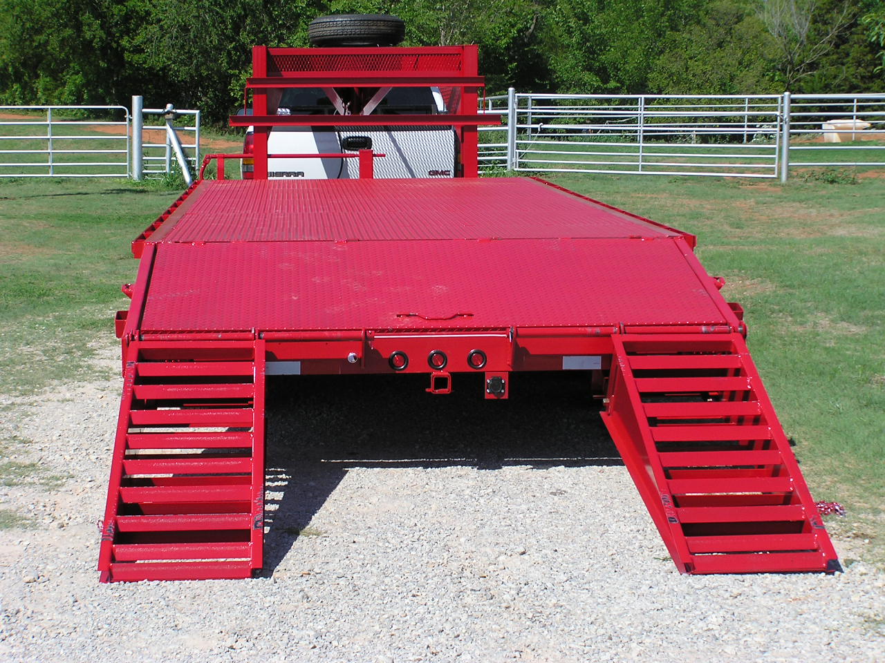

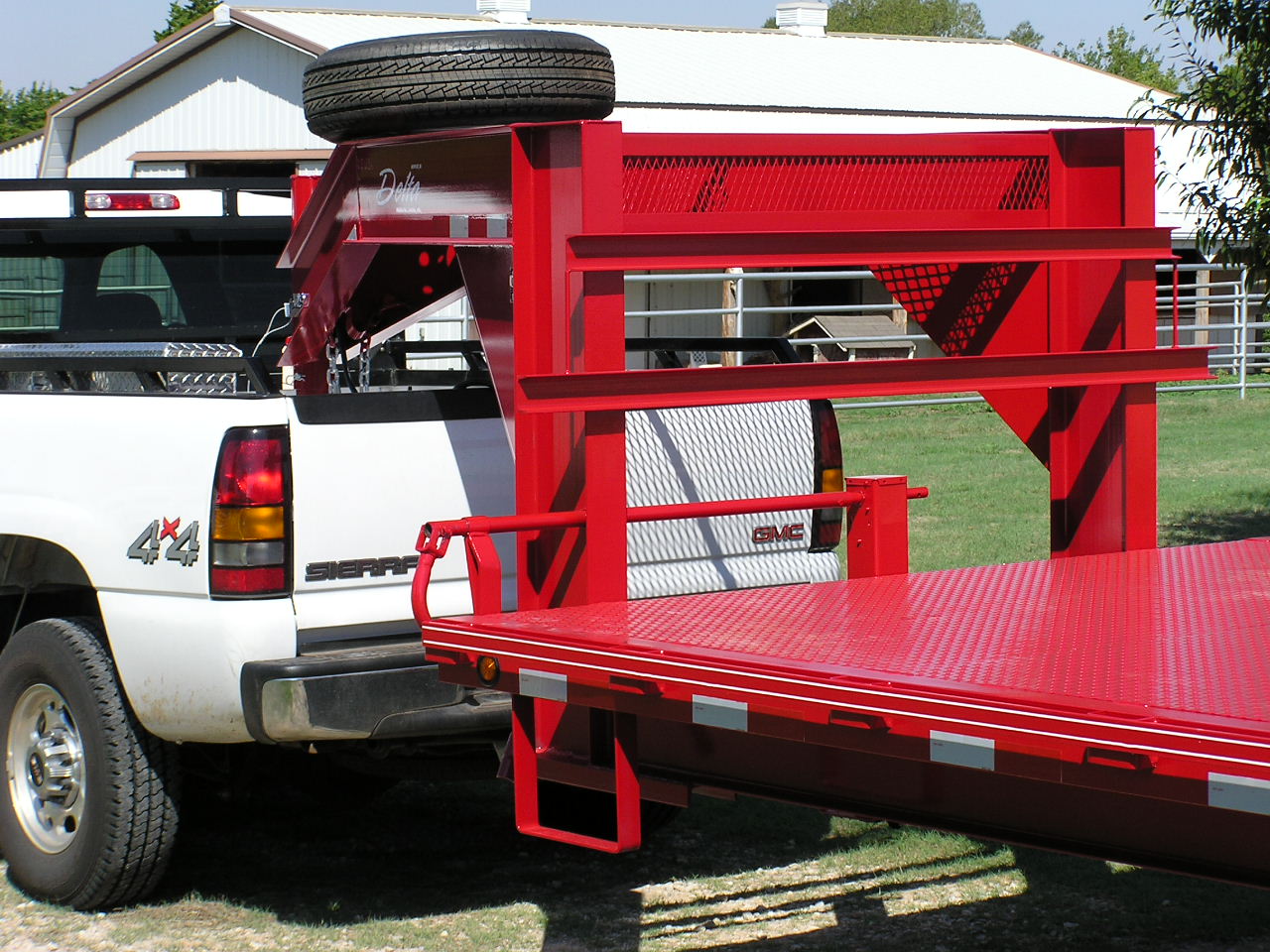

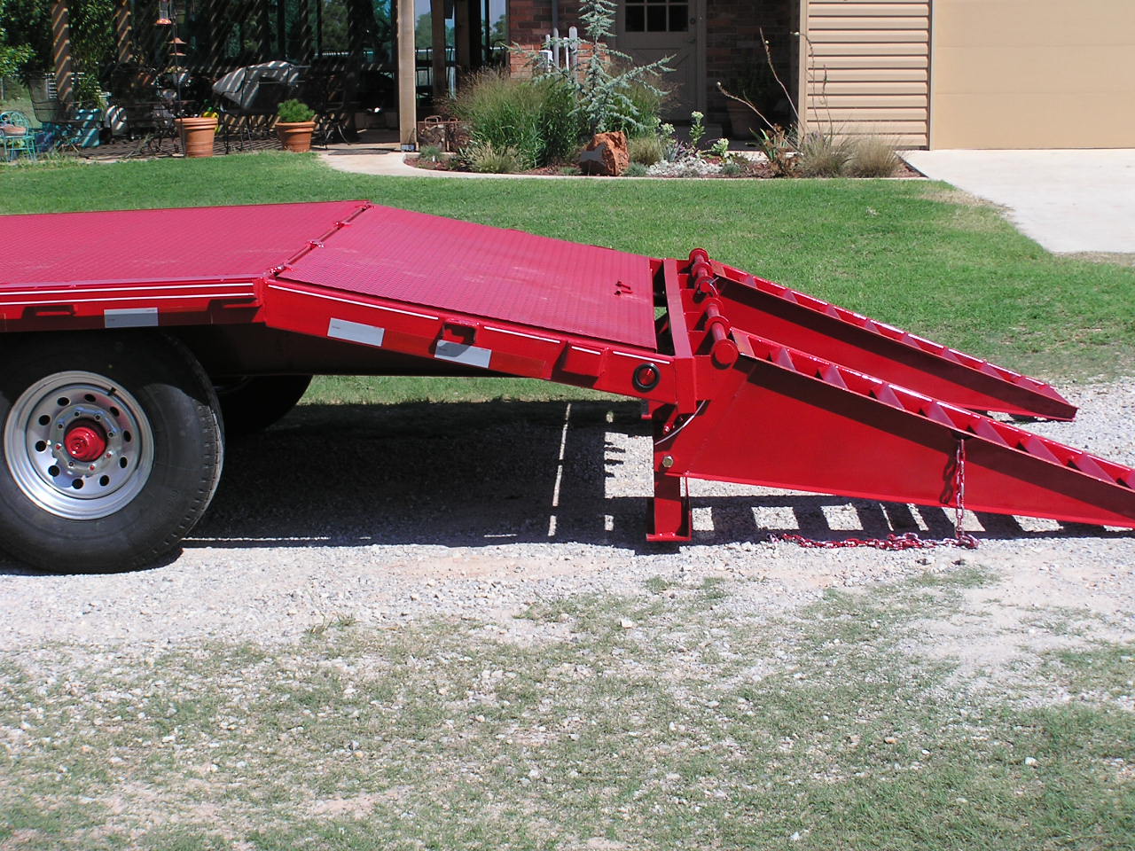

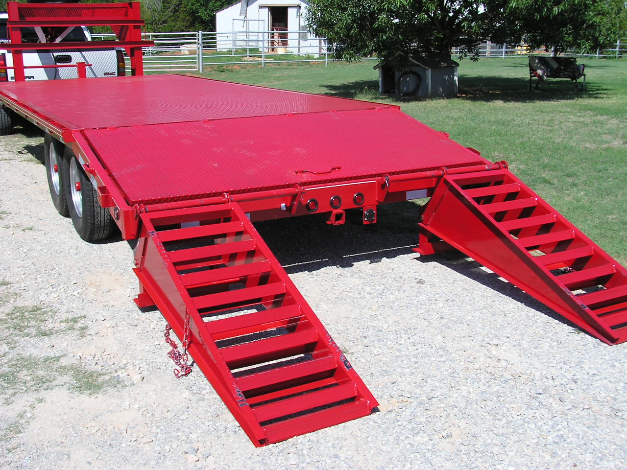

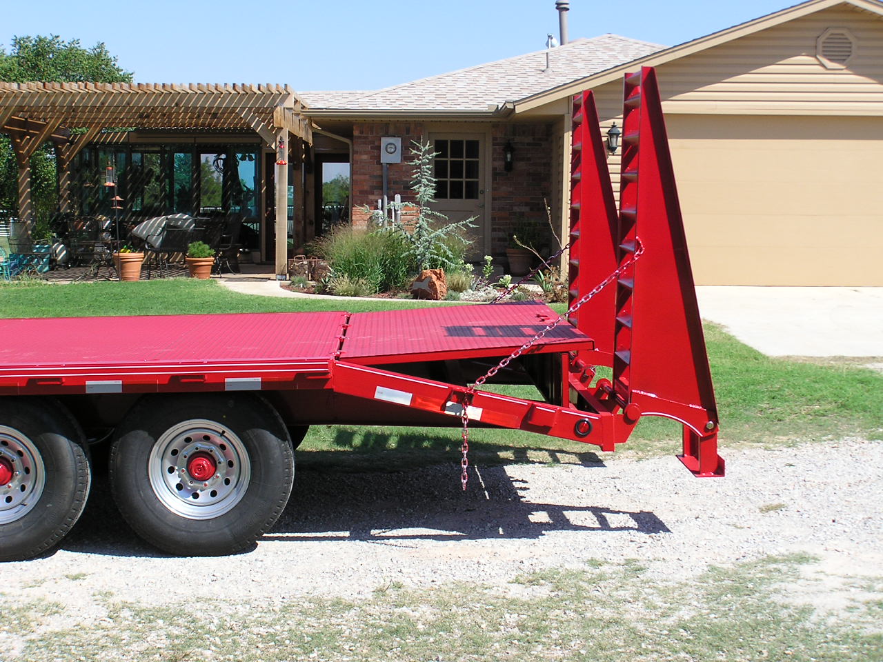

I have had many wood deck trailers over the years, now I have two that are steel deck. I will never go back to wood.
Bought this one in September, 2006, 14,000 GVWR. It has LED lights :thumbsup:
Now just curious, why do you like the steel deck so much?

Because I will never have to replace the deck! :D I had one 8x16 deckover that I had to replace the wood deck 3 times. :(

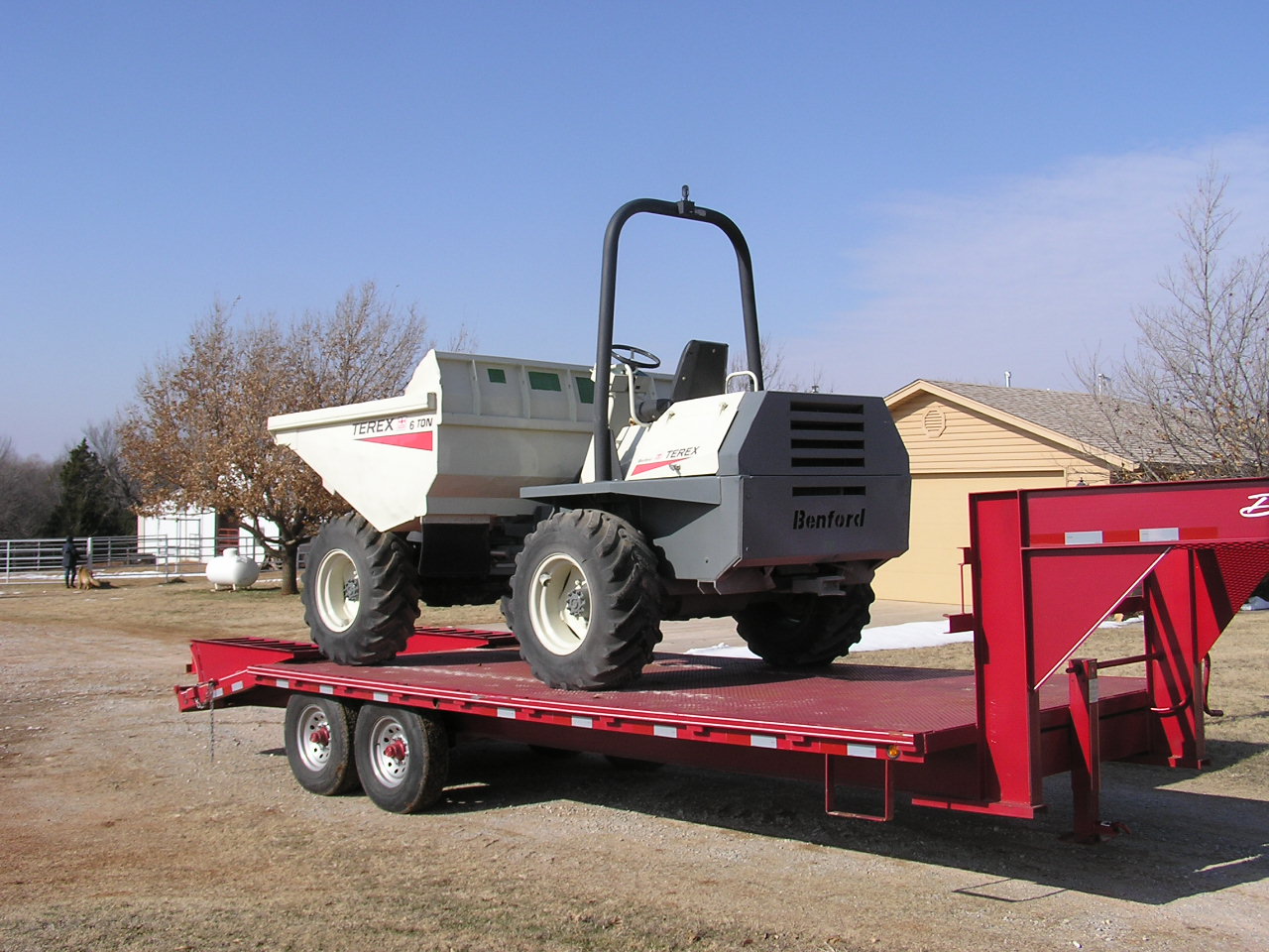

Those must be 2006 pics, not a scratch on it. :laughing:
Curious what you haul on it? Anything with steel tracks?
Yep, taken the day after I pulled it home from Delta, in northwest Arkansas.

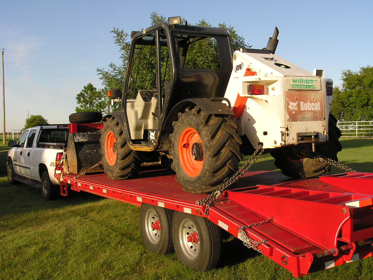

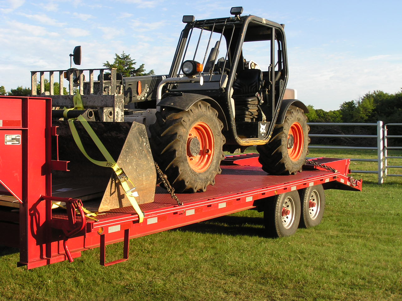

Nothing with steel tracks. This was the heaviest load, 12,640 on the deck, 3,440 ball, 14,200 axles.
This is just under 10,000

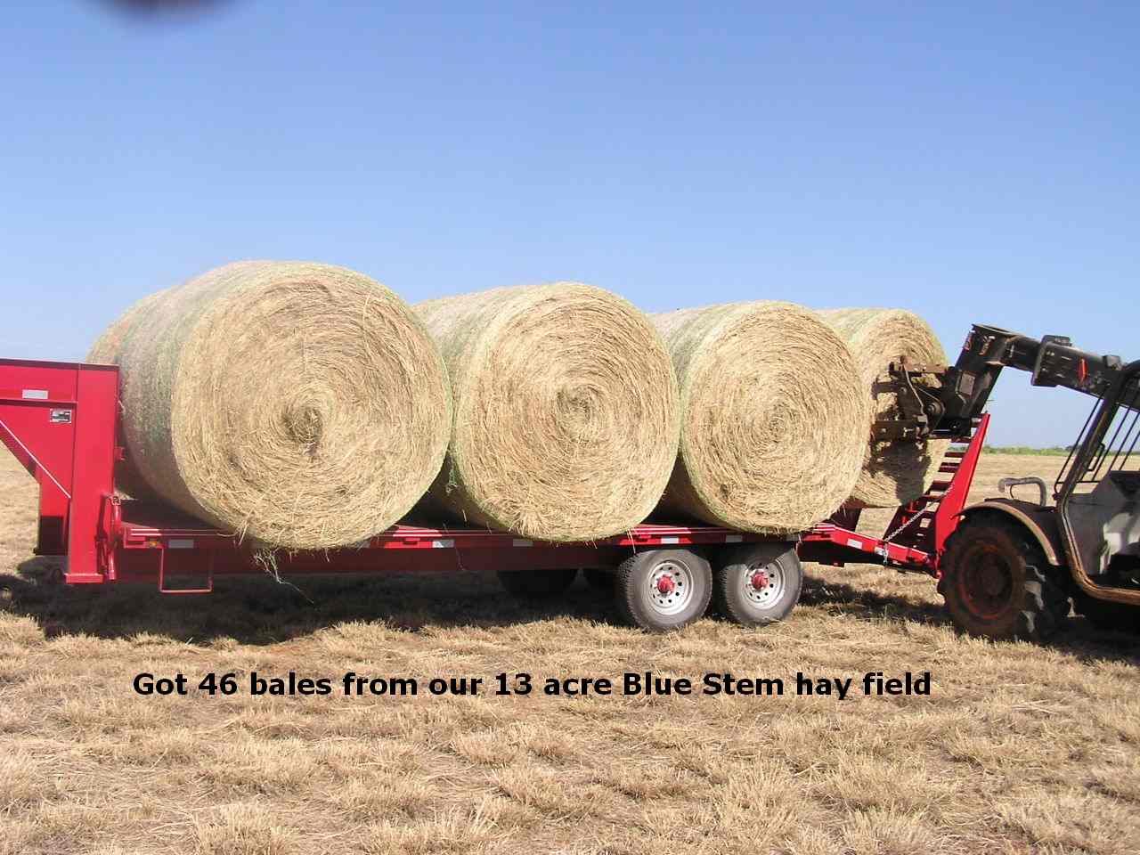

Mostly it as hauled hay, 8, 5x6 round bales, or 120 square bales.
