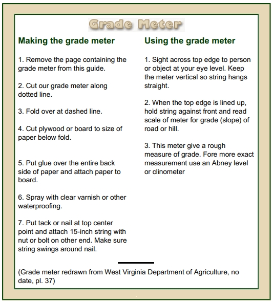

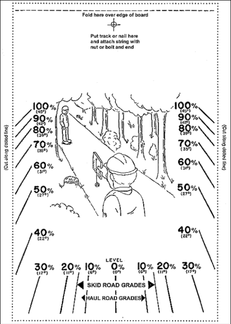

About 2 decades ago I found a jpeg image on a government website to make a grade measuring tool. It was nothing more than a sheet of paper on a board with a weight that was on a string. You simply put the board on the ground and where the string pointed was the grade. It was part of a document on making forest roads. It really took the guess work out of "how steep is that".
Here it is. The directions say to just glue it to a board and use a 15" piece of string. I used a shorter piece and put a long skinny board on the bottom. This allows me to just place it on the ground to get a quick reading. It's durable enough so I can carry it on my tractor and accurate enough, as we always said as kids, "for government work".

GREAT device ! Elegant in its' simplicity. Neat find. Seems to me all of us dealing with steep slopes can use it every once in a while. Thanks for posting it.

I'm definitely going to make one. I plan to use a LONG thin piece of wood that will serve better for aiming purposes than a short one the size of an 8 1/2 by 11 piece of paper. Maybe a good long scrap of plywood ? Sighting over the top at the same angle as the soil of the hillside is the key to even halfway decent accuracy.
One concern: the width of the paper between the dotted lines could be off quite a bit [proportion in width versus length] in the translation during posting the picture, printing the thing and then using it. Distortion and error might get pretty large. However, the rough accuracy is easy to spot check with a common drafting tool to measure degrees. A 30-60-90 triangle is really common among drafting tools and will provide a great check device. The 30 degree point is quite handy, being around 58% slope and essentially at my upper limit for operating a tractor on, even in the best of soil conditions and with great tires and equipment.
Also, you only need to check one angle with a drafting tool because if one is correct then they all will be.

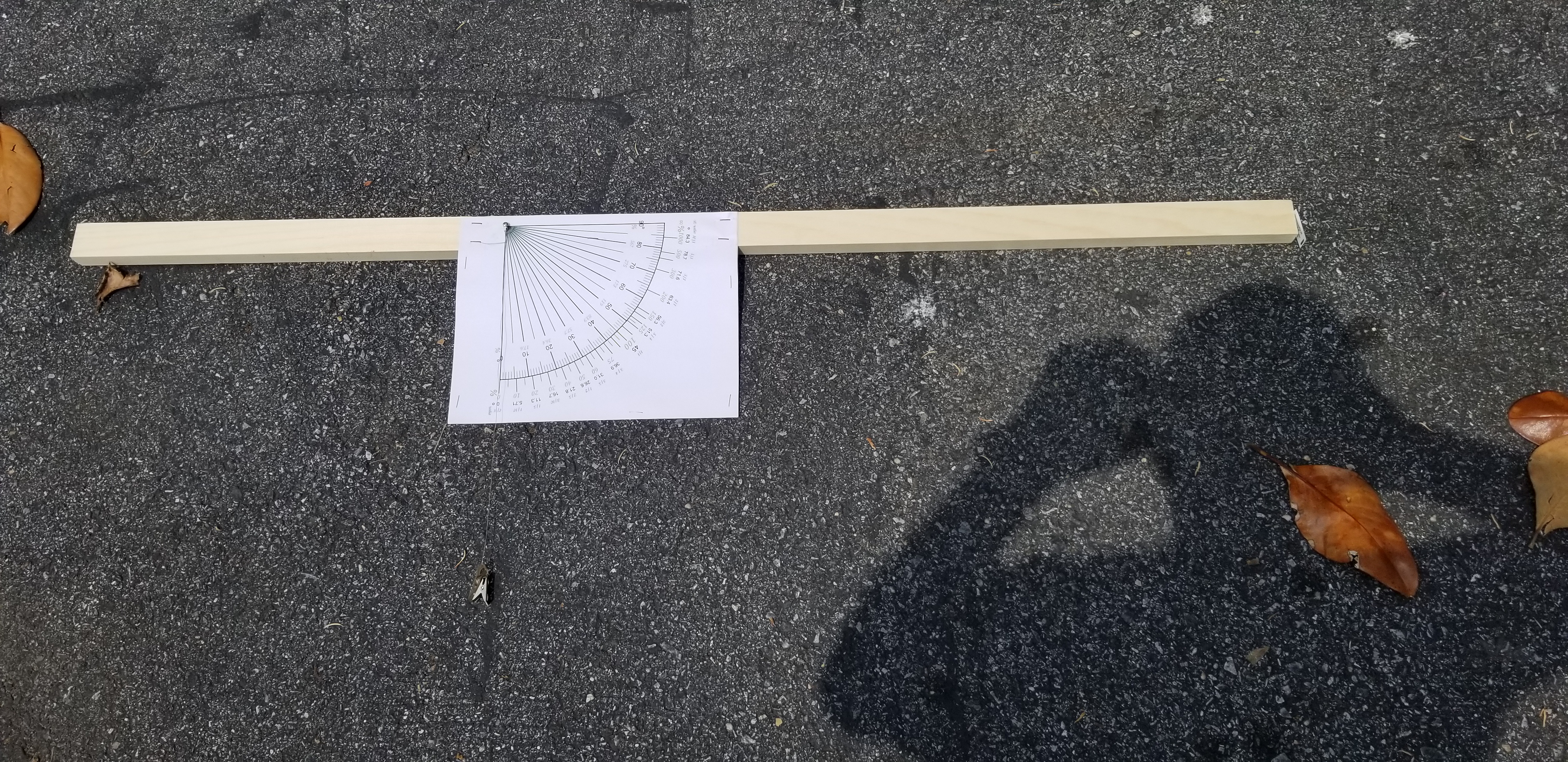

I haven't gotten out to the shed to make one yet but this comes to mind:
This old image provides degrees, % slope and ratio of slope all 3. I think % slope works best for us steep ground chasers.
Just print this out on your pc printer. Trim off the excess paper and mount it on anything stiffer than paper like a piece of thin plexiglas or just a sheet of heavy construction paper and screw or staple that to a yard stick -- the wooden kind you used to get free from the hardware stores. Put the screw for attaching the string in the apex of all the angles. The string will need a tiny weight (I'm thinking black sewing thread with a paperclip on one end...) Maybe a foot of thread. This rig will be a bit more universal than the WVa AG Dept. pictorial template. Same result. [An inclinometer...]
Not something you mount on your tractor but certainly something you walk out to your favorite "I call this one steep" slope and see what it really is.
I did check on my PC screen and (at least as shown on my screen) the earlier posted WVa AG Dept image from kenmbz is NOT distorted and agrees well with a drafting tool.
