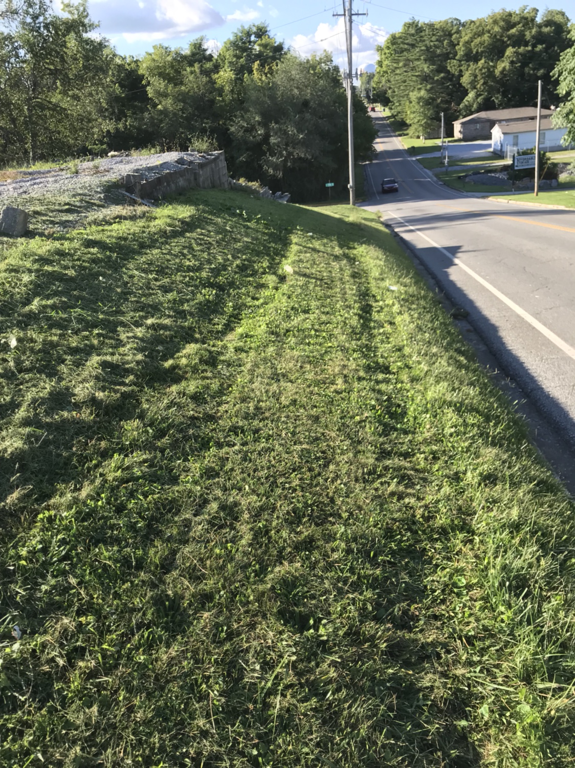

^^ I have places I can't even walk in winter when it's snowy, icy or just plain mud slick. I leave footprints in the grass just from my own weight (which isn't a lot). There is nearly no real level ground beyond 10-15' away from the house, garage and driveway. Just walking to the mailbox can be an experience in winter.
The picture above shows an embankment of about 12' from bottom to top. That almost has to be mowed sideways because of the road below and wall above, meaning no place to turn. Like I said, once I start the climb from the bottom towards the top, it's at least 70 linear feet before it begins to level off at all. And it isn't even. There are low and high spots so sidemowing is really out. Even if I had a machine that could handle the side slope angle, dropping a tire into one of those low spots changes everything REAL quick. One of the things I've been doing this week is filling in some of those lows.
I could do it with the small mowers but the small transaxles didn't like it at all. The SCUT handles it better, but I'm still a bit hesitant until I get more acclimated to using it.

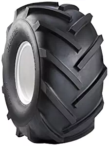

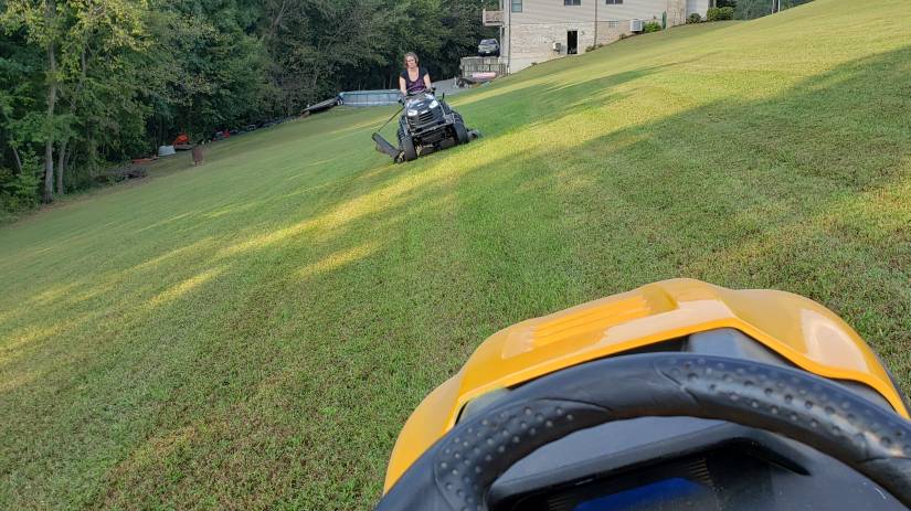

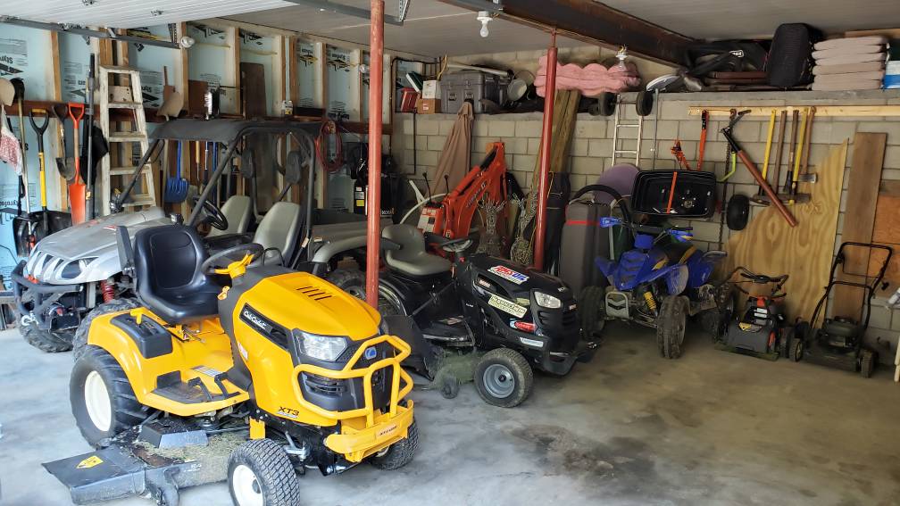

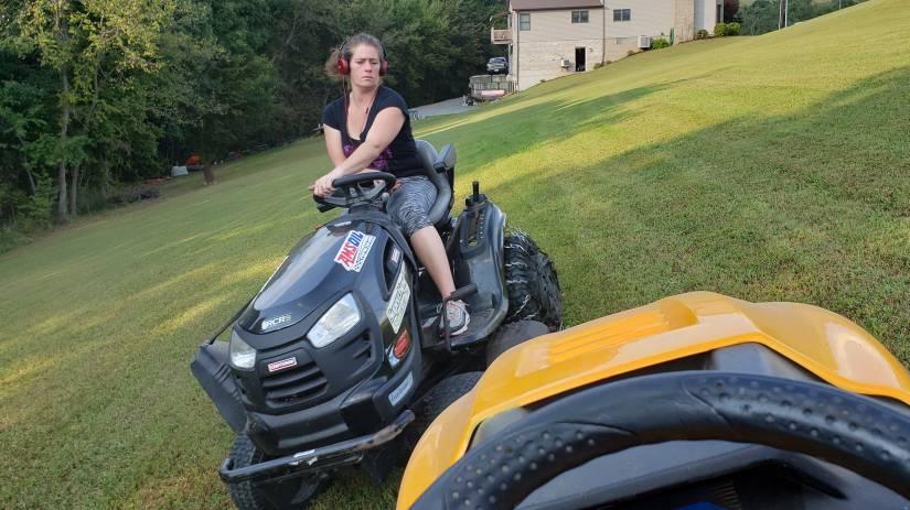

a regular garden tractor cannot go up and down because the rear wheels slide
My lawn tractor was terrible on the steep part of our lawn until I swapped out the rear tires, to something like this:
With these tires, despite not having a diff lock, as long as both rears are on the ground I can climb the hill mowing where it previously couldn't get anywhere near. I still have one spot that's extra steep which I either use the trimmer or I approach from the top and only go down.
Mind you I don't mow to golf course quality, but I haven't noticed any damage from the ag-style treads - but I suspect the low weight of the lawn tractor (vs the weight of a real tractor) will keep damage down.
If you have normal turfs, I'd consider swapping the tires before spending thousands on a different mower - I love my big tractor, but I wouldn't get rid of the lawn tractor because it mows so well and also pulls its cart for many tasks very well.
For my lawn tractor, I bought "Carlisle Super Lug Lawn & Garden Tire - 20X10-8". They were very easy to swap with no special tools (used a ratchet strap around the diameter to seat the bead when inflating).
