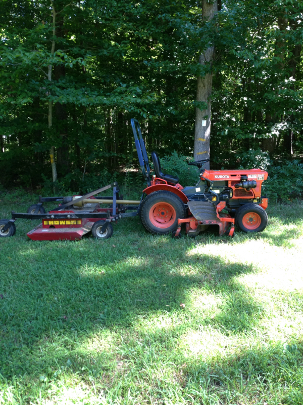

I rarely if ever use them on tractors with loaders. On my B7200 I use them a lot because it's too front end light to steer.
That is kinda what I am expecting,, I will need weight,,,
Hmmmmm,,,
Maybe fluid in the front tires,, the wheels are drilled for weights,,,
I do have three front end suitcase weights setting around doing nothing,, 100 pounds each,,,

I suspect that 300 lbs. on the front would be about perfect on the 4105.

That is kinda what I am expecting,, I will need weight,,, Hmmmmm,,, Maybe fluid in the front tires,, the wheels are drilled for weights,,, I do have three front end suitcase weights setting around doing nothing,, 100 pounds each,,,
If all you're trying to do is pull a 72" mower I think you'll be fine. My L3240 base tractor outweighs it by about 400 pounds and it doesn't have any trouble with a finish mower. I've never tried it without the loader on which would make a substantial difference but I still expect I could handle it fine. My B7200 even handles a 750 pound mower moderately ok. It handles the lighter 400 pound mower like a champ. With a 3 foot rotary cutter on the b7200 my steering is pretty bad. A finish mower rides on its own wheels and doesn't lift up the front of the tractor.
