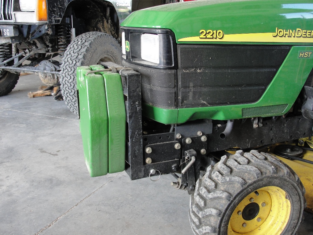

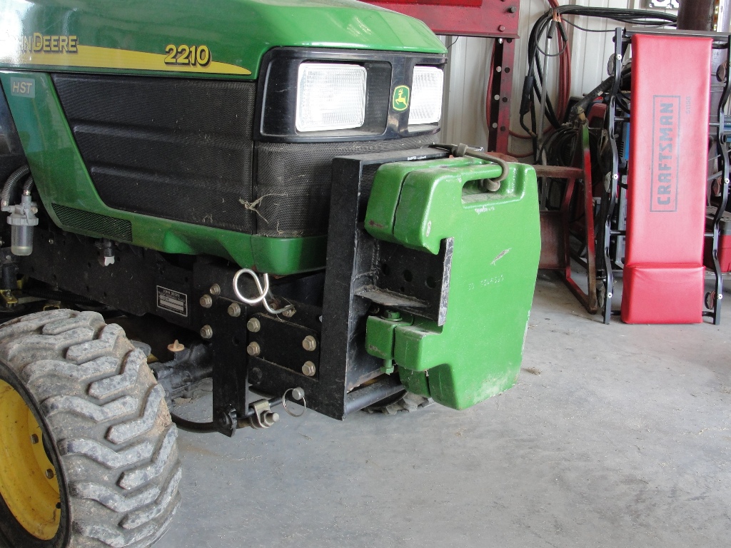

Congrats on your purchase!!!! Good project tractor that I believe will serve you well!!!!
As for front weights. I'd build a rack for your suitcase weights. Might consider turning them sideways so they don't stick out so far. Something similar to this.
