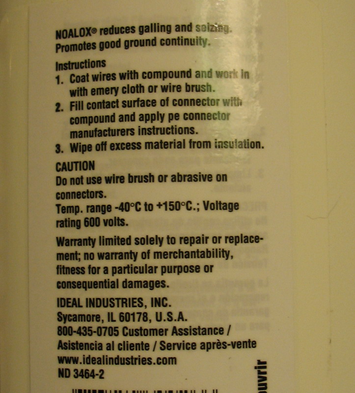

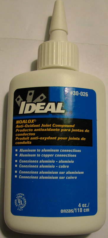

I am not a licensed electrician, just a DIY homeowner.:eek: I believe that you can hookup Aluminum conductors to a panel using an anti-oxidation compound. Here is what I plan on using:
Wire Installation - Noalox Table
I attached some pic's of the product.
Comments?:confused:

dave you might check and make sure you can do that. I do know that when I am in lowes looking for stuff some of the breakers and boxes say that they are made to use with aluminum. You might want to check into that
