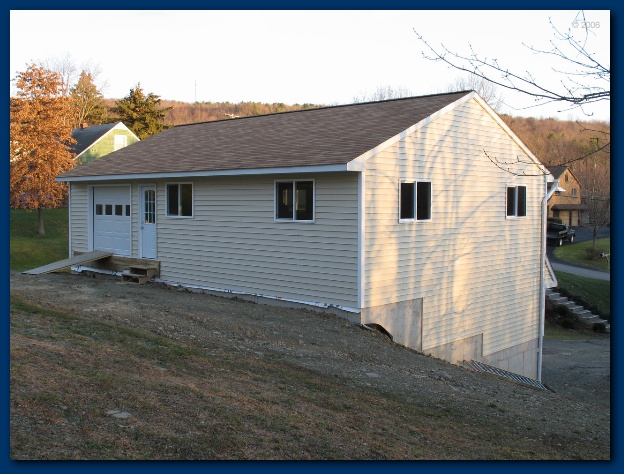

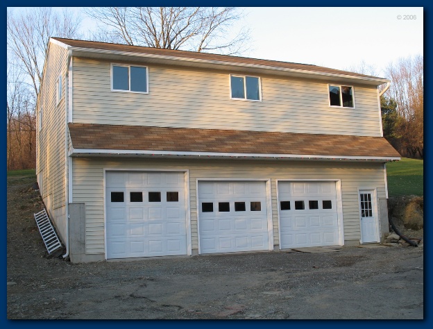

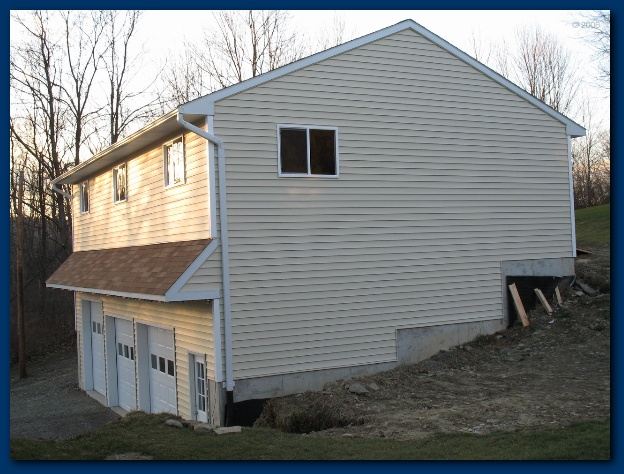

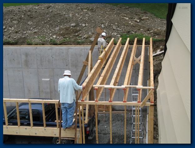

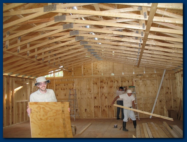

Roger,
Nice job, and fast!
I just designed and built a 28'x40' garage with a second story, so I think I can weigh in on your trusses.
I looked at the engineering drawing for your fink trusses. If you install a drywall ceiling (1/2" or thicker), you are good to go for bracing. If you will be delayed in the ceiling installation by a month or so, I would install 2x4 bracing on the bottom chord of the truss, 10' (or less) on center. My trusses required similar bracing as yours. I used scissor trusses which gave me additional height and they required more permanent bracing than your fink trusses do. The roof sheathing (OSB) is sufficient to prevent the "domino" effect, provided you followed a nailing schedule. If I remember right, 1' OC and 6" OC at the edges with 8d nails.
I will eventually insulate the attic space of my building. Until then, I've run 2x4's
perpendicular to the trusses from gable to gable so that I meet the requirements and pass inspection. My trusses have a 28' span. I divided the span into 1/3rds and put my bracing there. With your 24' span, you could go 8' from the truss supporting walls.
I am waiting to insulate and drywall the ceiling because I wanted to be able to watch for roof leaks without climbing into the attic space. We have had some serious storms blow through and so far, no leaks.

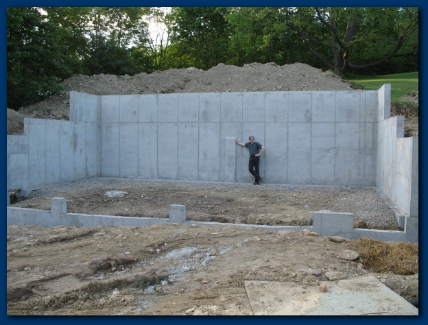

We (my family and I) did all the work with the exception of the concrete. My Wife, and FIL were my primary helpers and I had some additional In-Laws come over for some of the larger tasks such as setting the trusses. I also set my building into a hill, but my back wall is 12' high. That was just too much concrete for me to handle with my limited help.
As far as your panel bracing - I believe you should use 1/2" or thicker exterior plywood (a full 4x8 panel) at the corners of your building. Without it, you should use a "T" brace or 1x4 let into the studs at a diagonal at each corner. That is difficult considering the width of your overhead door. I don't think OSB is a valid panel brace - you really need more bracing.
Before you put up siding, you should wrap the wood with a house wrap. I used Tyvek, but you could use other products - even tar paper. Be aware that siding is not waterproof. To keep your building dry, you need a water resistant barrier between your siding and sheathing.
I've attached some pics of my project.
Good luck with yours!

   / Step by step photos of new garage #155
Fullmetal, that is nice!
How will you be using the second floor. I noticed the overhead door there?
   / Step by step photos of new garage #156
Thanks weldingisfun!
The second floor is for my woodworking shop. I've been wanting one for many years. I got tired of doing that in the driveway.
I'll partition off some of it for storage, and a room for finishing.
I put in the overhead door to keep it simple. A sliding door would have limited me on entry door placement, windows, etc. I wanted a door large enough to get a boat in/out of. :)
I want to wire the building this winter. This weekend I'll be updating the service on my house to 200 amp. After that is done, I can run a 100A feeder underground to the garage.
Hopefully I will have the time to rebuild the motor in my tractor this winter. It is low on compression...
Dave aka fullmetal

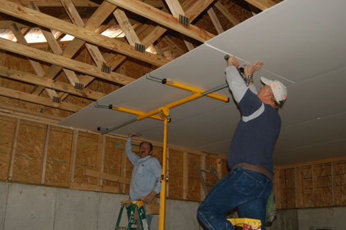

Well today we hung 860 sq.ft of sheet rock. Last week I help my brother in-law hang his ceiling. 12 footers. It almost did me in. Today I rented a sheet rock jack which he said would be to slow and clumsy. Well it took us half the time to hang mine than his and his garage was smaller. Yea.

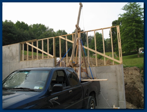

I have a new question. I have 10 ft ceilings. The concrete wall in the picture is 7 foot tall. With 3 ft stud wall on top. The question is how would you build a wall to cover up the concrete. 1. build all the way to the top, insulate, wire and 7/16 osb.
2. build a wall only to the top of the 7ft top of the concrete. Then a plate over the ledge of the wall.
This way I spend less on studs and osb. Plus I will then have about 4 inches of lip and then the stud wall of 3 ½ inches total of 7 inch lip. Which could hold ladders and other items with peg boards behind it.
What do you all think.
Thanks
Roger

Why the OSB board?
Consider full length metal studs and drywall??
The lip will srely be a good place to lose things for short fellows like me. It may also tend to accumulate dust.

I would paint the concrete. I'm not sure why you want to cover it. Insulation?
If that's the case, I'd go with a straight wall all the way up and use OSB. I'm always banging into walls with something.
Dave
