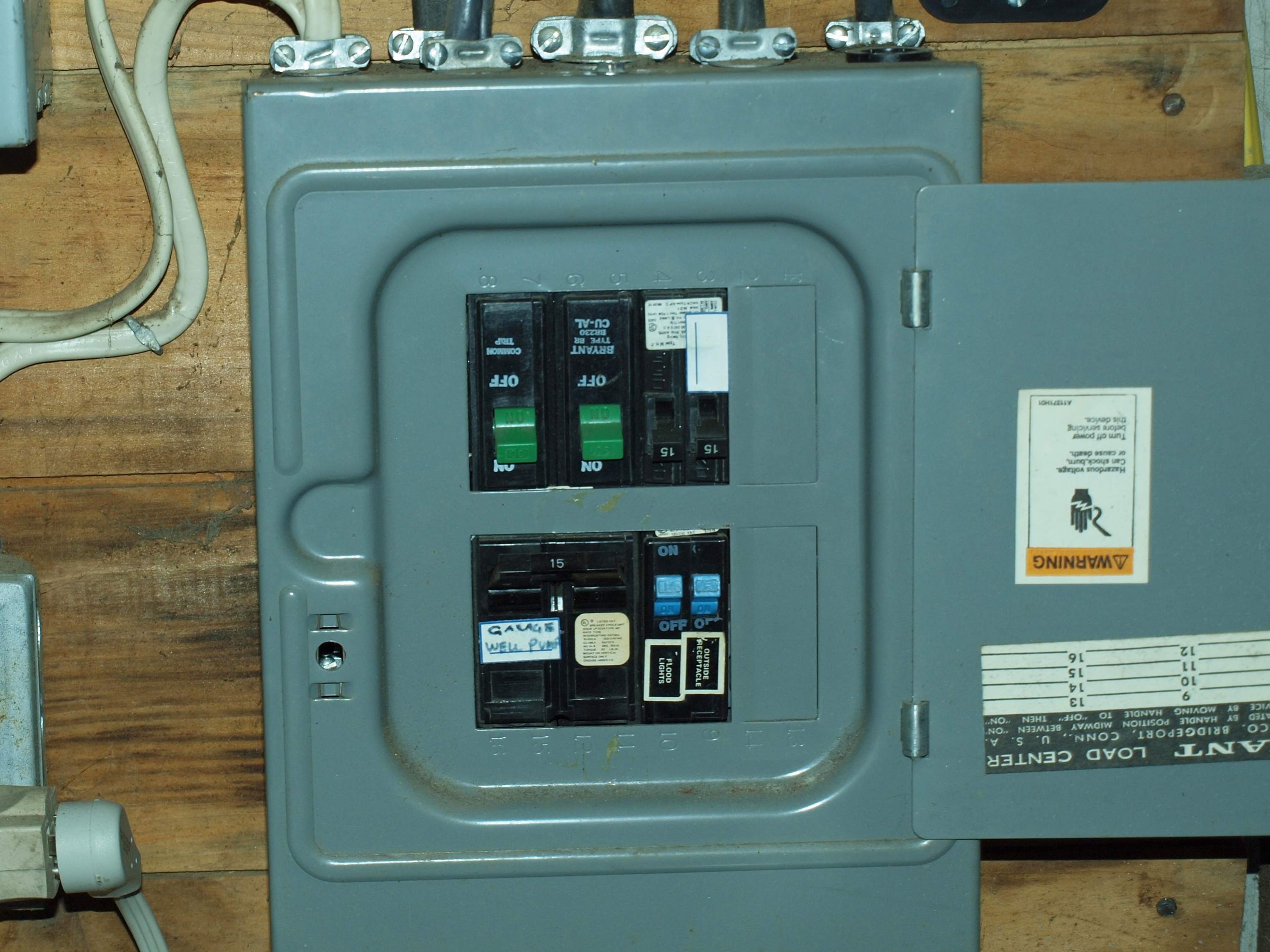

Since I m a "visual" learner, allow me to proceed. Here you see the box at the house going to the garage. The two 30 amp breakers are connected to the #10 wire going to the garage being fed from the main with a 50 amp breaker acting as a service disconnect. Why is this not 220 already? The box in the garage is all 110 volt with 20 and 15 amp outlets connected. If indeed I have 220 going out to the garage, isn't it simply a matter of putting in a 220 30 amp breaker at the garage with a wire lead dedicated to the welder outlet?

Since I m a "visual" learner, allow me to proceed. Here you see the box at the house going to the garage. The 2 30 amp breakers are connected to the #10 wire going to the garage being fed from the main with a 50 amp breaker acting as a service disconnect. Why is this not 220 already? The box in the garage is all 110 volt with 20 and 15 amp outlets connected. If indeed I have 220 going out to the garage, isn't it simply a matter of putting in a 220 30 amp breaker at the garage with a wire lead dedicated to the welder outlet?
Arrow, go out to the garage, and open the electrical box. Take your voltmeter set on an AC scale over 240 volts. Measure between the 2 wires coming into the box from the house. If they are between 220 and 240 volts you have your answer. If they are between 110 and 120 volts, you still have your answer, just not the one you wanted to see.
