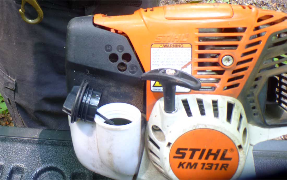

Here is a couple of things we found we didn't like on the machine.
The cap string is too short and the cap remains in the way.

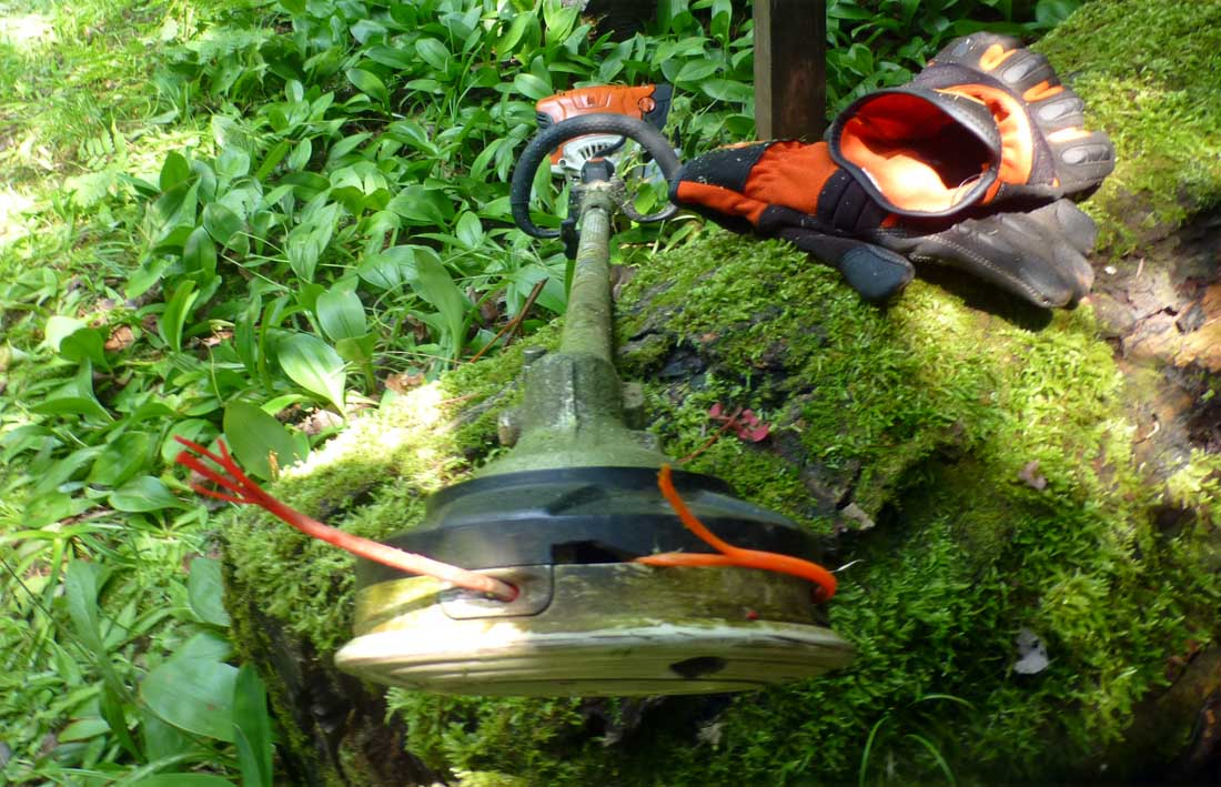

The 4 string head seems to have thin sections and the strings are breaking it. I'll ask our dealer about these issues.
I put the echo/shindaiwa speed feed on mine. Best decision I made for my Kombi so far.
We do not use spool feed strings for brush claering since the largest you can load it with is 095. We run .155 string but we are trying to switch up to 170. Bigger is indeed better..

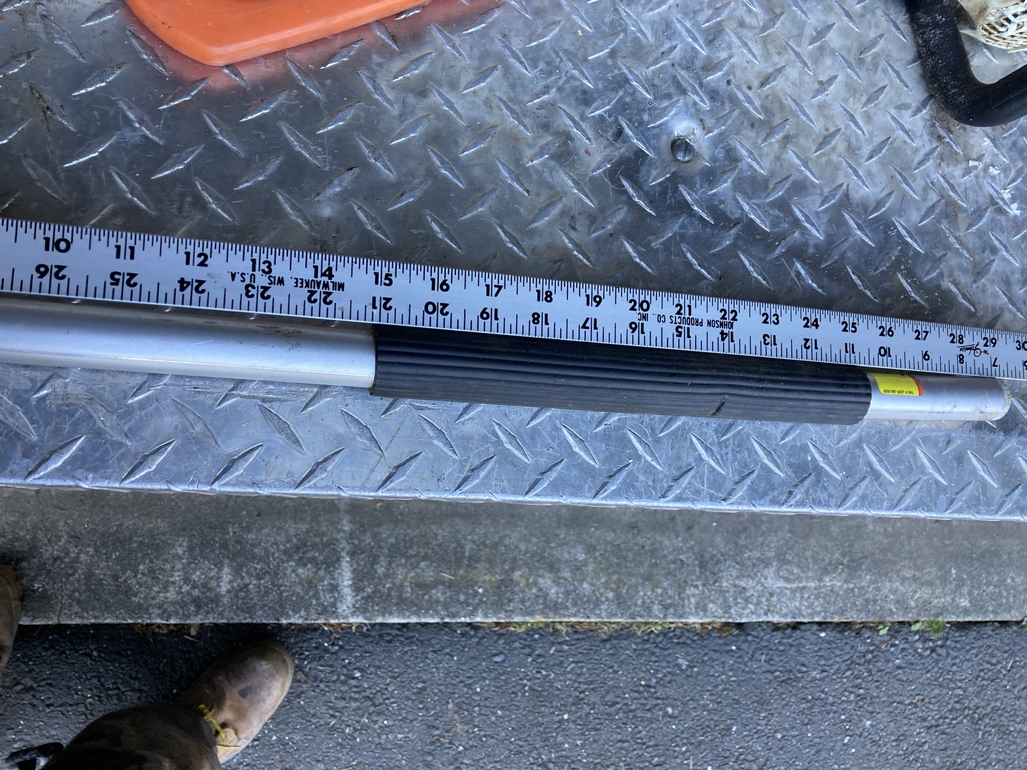

I have an older unit and bent the shaft to my polesaw. It still works but I need to fix it. The tube looks easy to replace? Anyone done this?View attachment 736095
Yes we have! Find a tree with a fork in it, that's closely spaced to use as your anchor. In your case, looks like a smaller tree might be needed. Put the bent section between the tree forks first and have the kink on one of the forks and of course the short end of the pole against the other trunk. We do this in the field all the time.
I should add, our echo shafts we bent on a regular bases but the Stihl seems to be built stronger and we've not bent it yet. :unsure:
Great advice. Thanks for sharing!
Luckily, I haven’t bent or had any issues with the pole saw, extension or any of the components for my 131R. The 131R is the best tool I own and gets used and abused regularly.
