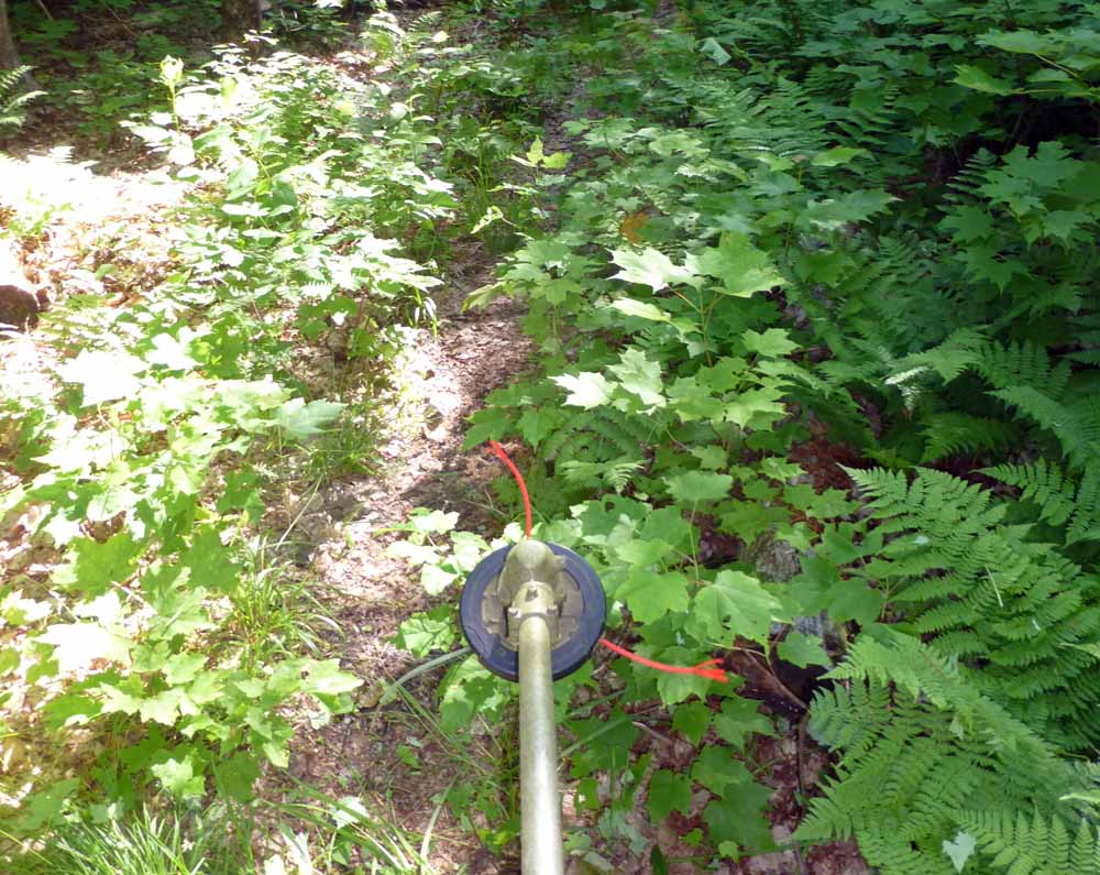

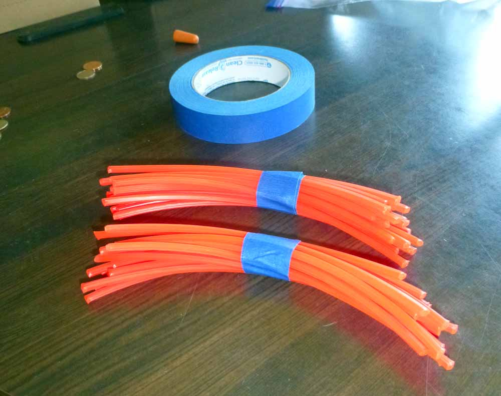

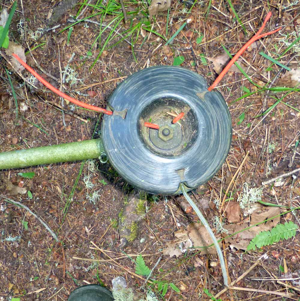

Below is the head style I'm speaking of. These will take out shoots nearly pencil sized. If it doesn't cut them off, they are beat to death anyway. The middle photo is the string bundles we carry with us. This is .155 string but Stihl is suppose to be coming out with a head to hold 180. We're going to get that asap.

That looks promising!
The one benefit of the metal mulching blade...is the ability to mulch the material on the ground once it lands. It really cleans things up really well.
Mike
