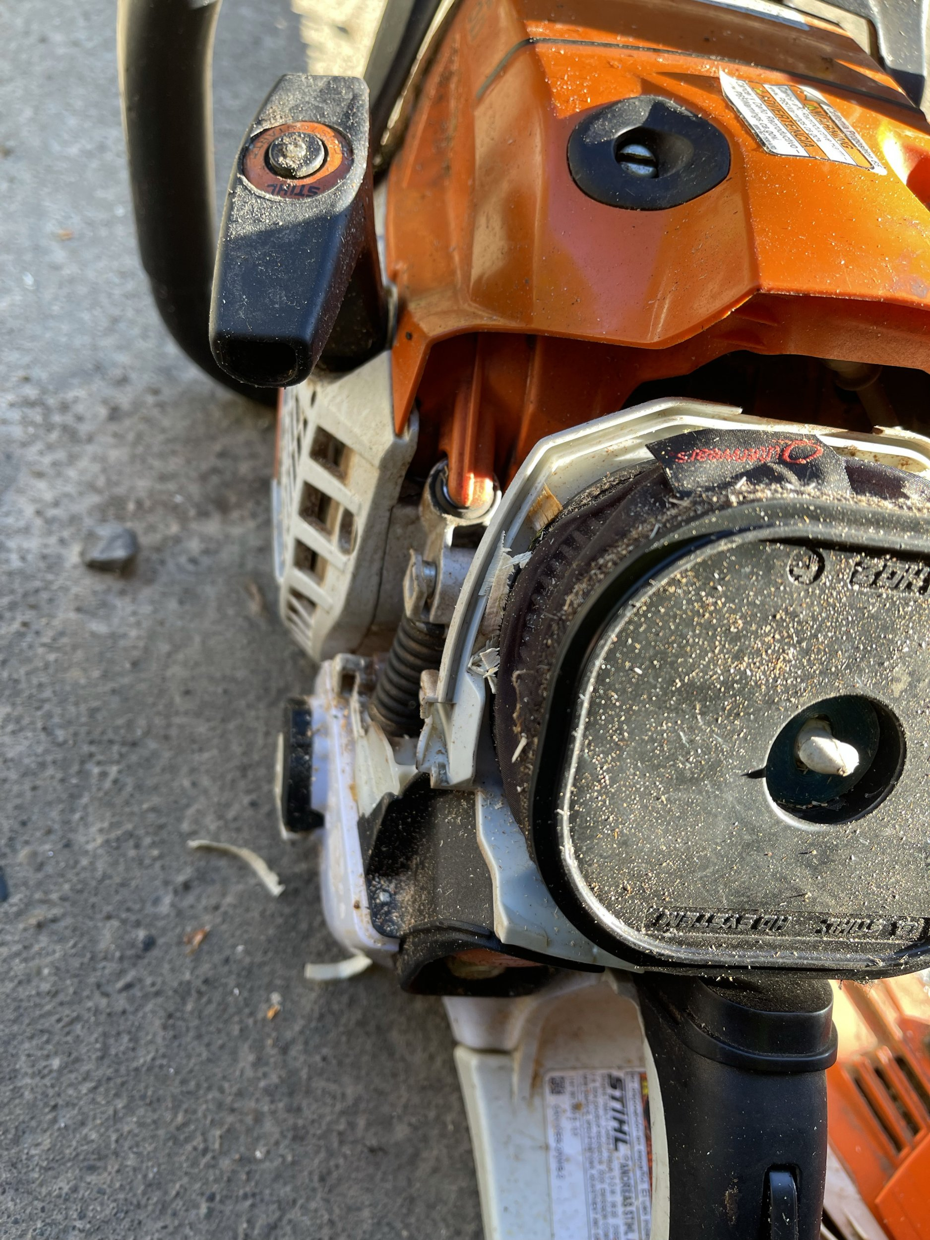

Been running one almost daily since the first of the year without a lick of issues running 32’s and 36’s. One thing I’ve noticed with it is this isn’t a short bar saw they love cutters and aggressive grind chains. If you’re interested in a short bar saw look into the 462 it’s happiest with a 28 with a max of a 32 with semi skip chain.
My complaints with the 500 and 462 both air filters plug quickly as well as the anti vibration springs are soft for west coast work, plus the pull start handle are garbage.
This is of a 500 after a 6 hour day of cutting timber.
