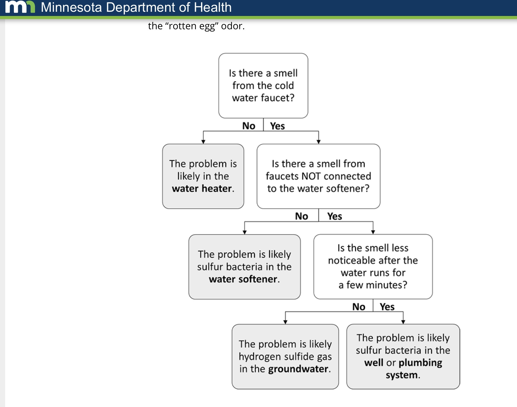

/ Stinky Water Fixed #4
Handy chart...
/ Stinky Water Fixed #6
Iron eating bacteria are a big problem in parts of MN and they make the water taste like rotten eggs. The northern part of the state is know as the Iron Range for all the iron mining that has been ongoing for decades, so not a big surprise. People assume it is sulfur in the water but it is the result of the iron bacteria.
