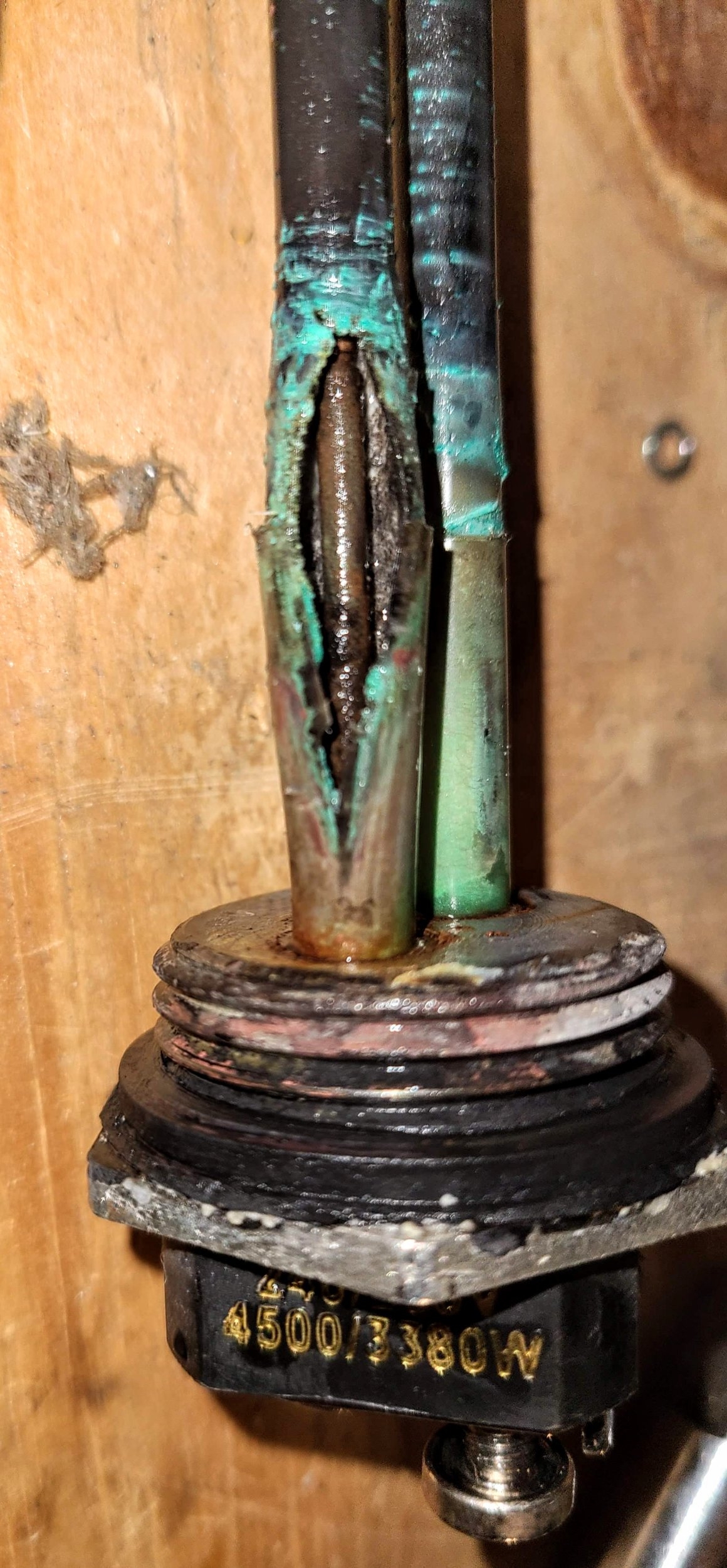

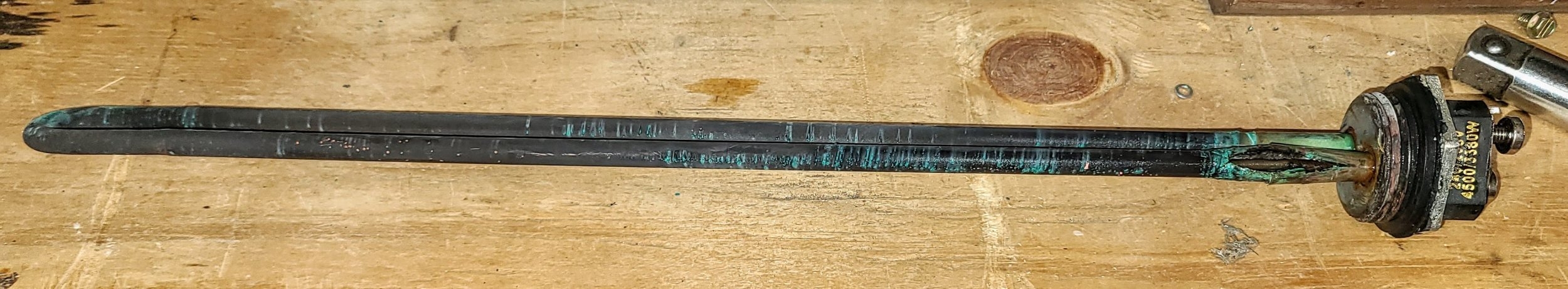

OK,, here are the pics of the lower element out of the hot water heater.
Not too bad looking for being 17 years old,, well, except for that little "split"
My daughter only had one element left, so I ordered a couple more
The lower element was the one I replaced.
Possibly, that split spot exposed enough of the nichrome wire to cause the water to turn into oxygen and hydrogen?

Congratulations on finding the blown electrode. I hope that fixes your gas issue. Did you by chance check the anode as well?

I have the second element coming Tuesday,, AND,,,
also, I ordered a powered anode, which is also coming Tuesday.
The powered anode does the same thing as the metal one, except it uses your house electrical current.
I think it said it uses $3 worth of electricity a year,, something like that.
It is made out of titanium.
