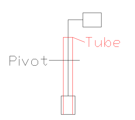

I welded a piece of 2" square tubing on top of the reverse pedal...made it a lot easier.
I don't understand... or see how that would help...
The two are too far apart. I would prefer a simple rocker pedal.

It's still a rocker pedal...it allows me to go forward or reverse without taking my foot off the pedal...the piece of tubing is used to decrease the distance fore and aft.

So I guess a top view would look sorta like this:...?

Close...same principle...it also decreased the amount of force required to engage...for some reason (never really dug into it) reverse travel seems a little stiffer and it helped with that (right knee is arthritic).
