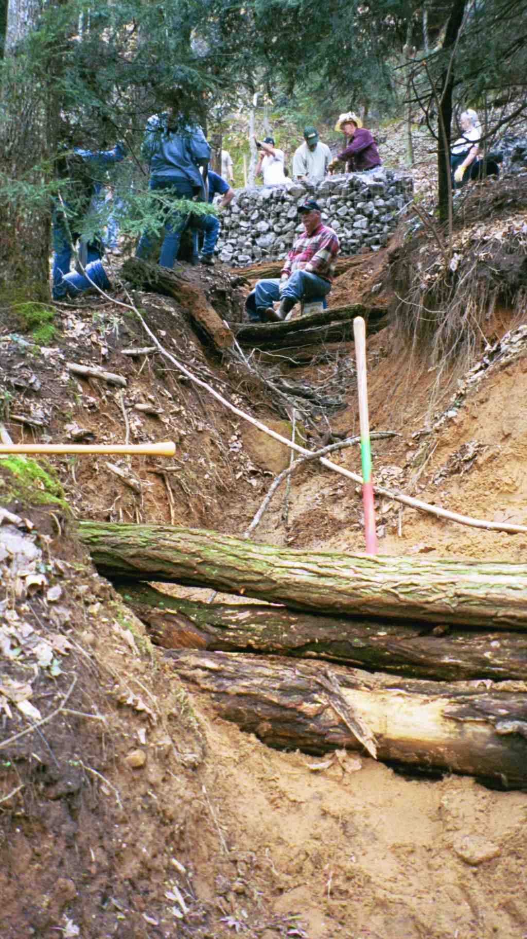

I used rocks, and bricks gathered up around here to put in a wash, down below the dam on the pond. Always a good place to get rid of those pesky things..!! Of course it is in a wooded area, so the leaves help plug the holes some, to catch the dirt. Works great..!!
If you don't have that many rocks, you can try this. We made a log dam in a washout on a trail project. Seems to be working, but will take several years to fill I'd imagine. But again the leaves help catch the sediment. You can always add to it, as it fills, or make another downstream, and catch some of what the first didn't...
