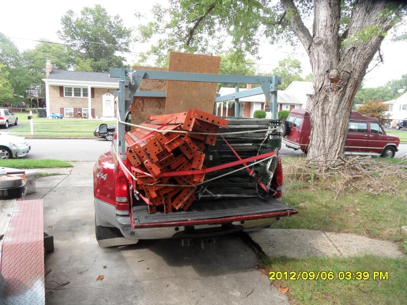

I agree on pallet racks.
I found a crank up lift similar to this one on craigslist.
<img src="http://www.tractorbynet.com/forums/attachment.php?attachmentid=333136"/>
Mine is rated for 650 lbs. to 16' high.
My friend, Wylee has something very similar by Genie. He replaced the hand crank with a 12vdc HF winch. We both used it building our houses - man what a tool. I've used it to place 21 ft 6X16s and 24 ft 4X10s and 4x12s.

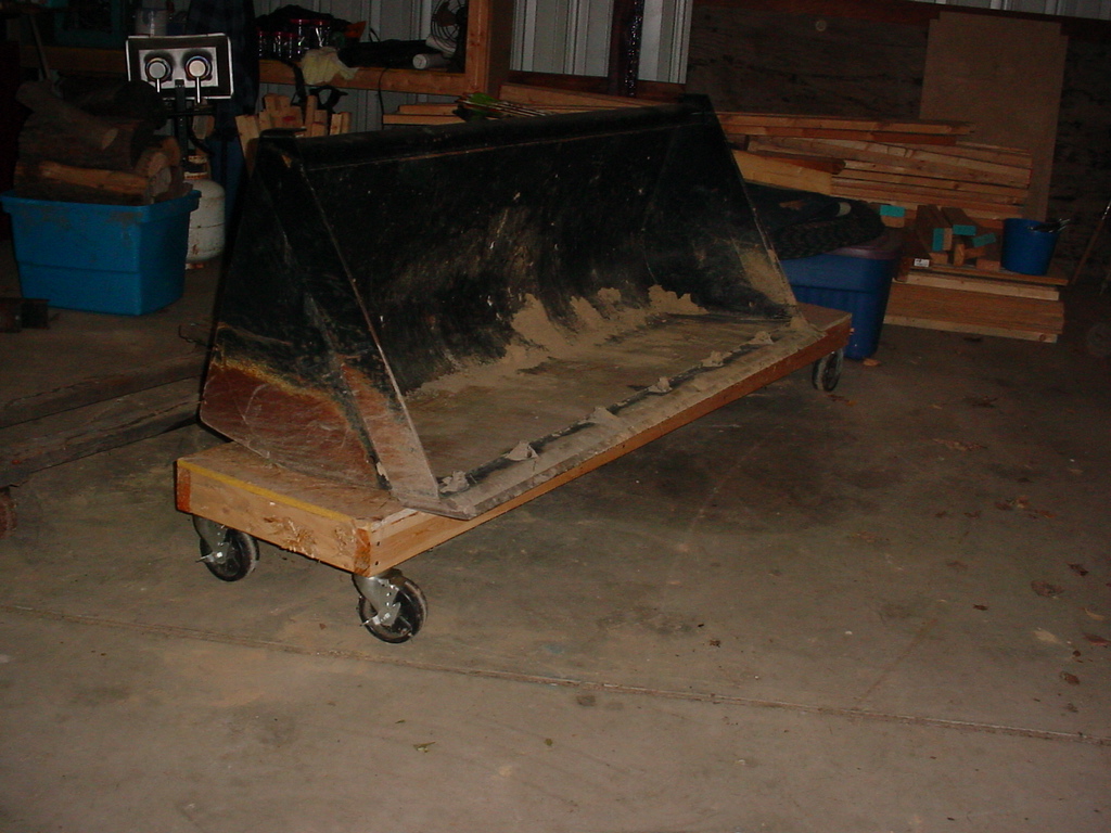

Here is few photos of my set-up, it works. Stay away from the HF light duty caster, the heavy duty caster might be a better choice. The light duty caster are very difficult to move around.

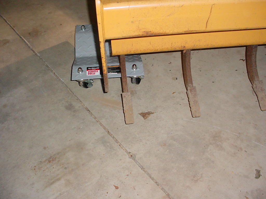

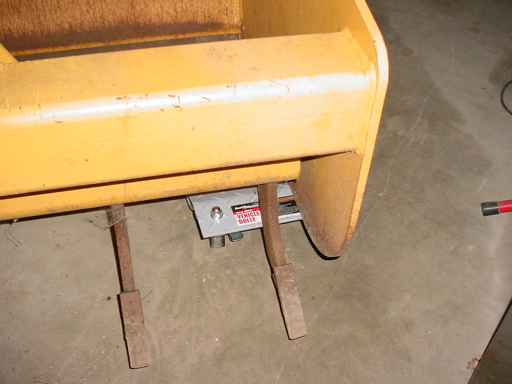

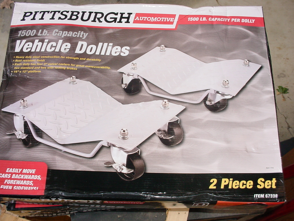

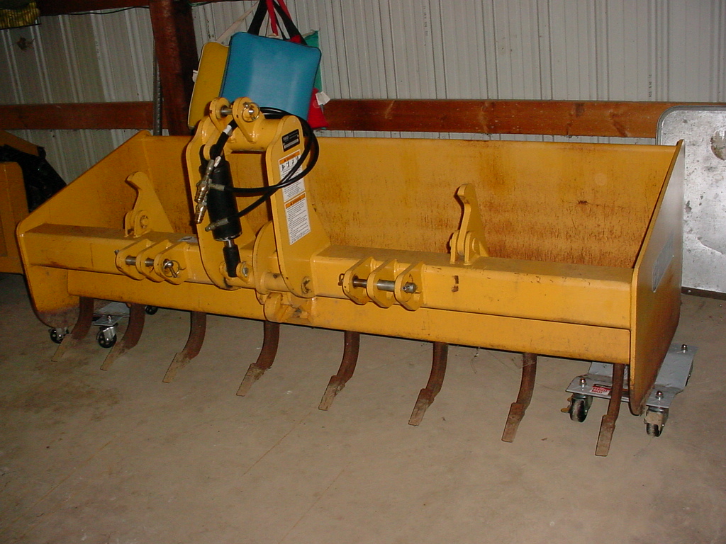

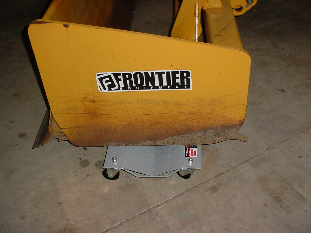

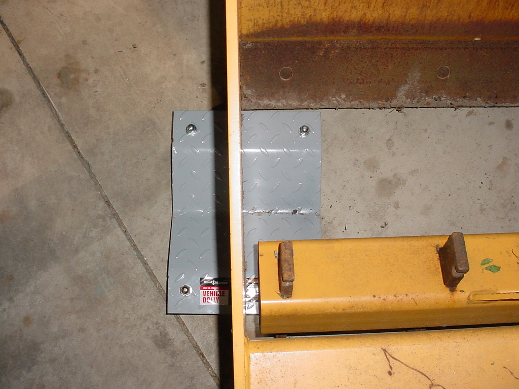

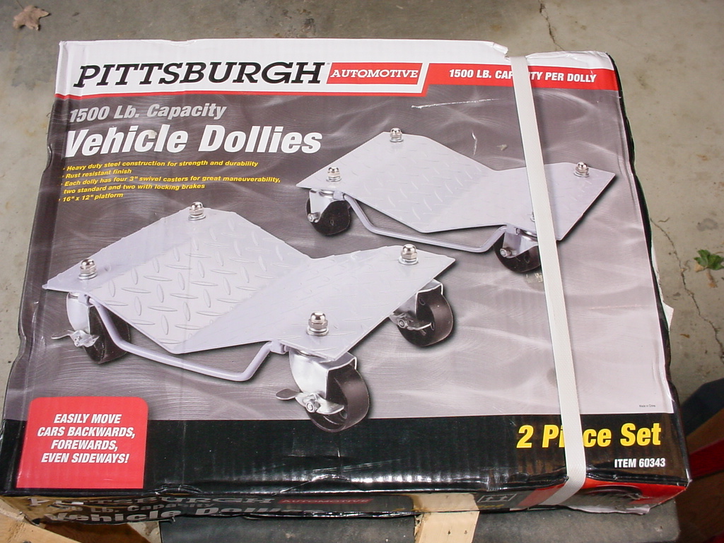

Just an update: Picked up a set of 1500 lb vehicle wheel dollies from HFT. They work great, the box blade rolls with very little effort, not bad for 1260 lb box blade. ($49.95 with coupon for a set of 2) Just remember the 67338 have steel wheels and the 60343 have plastic wheels. (I have the steel wheels)
Vehicle Dollies 006.JPG Vehicle Dollies 007.JPG Vehicle Dollies 008.JPG Vehicle Dollies 005.JPG Vehicle Dollies 012.JPG

I use the same dollies on some of my heavier equipment.IMHO they work great on cement floors.

Looks great.
I used the wooden dollies from HF to make mine. Think that is posted somewhere on TBN.
I still need dolly for my backhoe, will have to look at these.

Are you using the 67338 with steel wheels or the 60343 with plastic wheels.
I have one pair with plastic wheels and two pair with steel wheels.Both have held up well.

Anybody have opinions on whether the wooden or automotive (shown) dollies are superior? I am using the wooden ones for my land plane and am wondering whether the ones shown above are superior. Does more expensive = better? :laughing:
