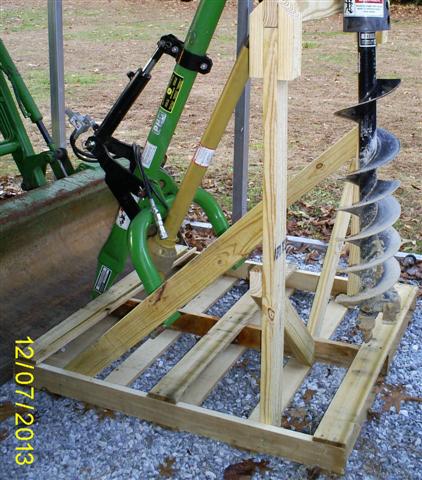

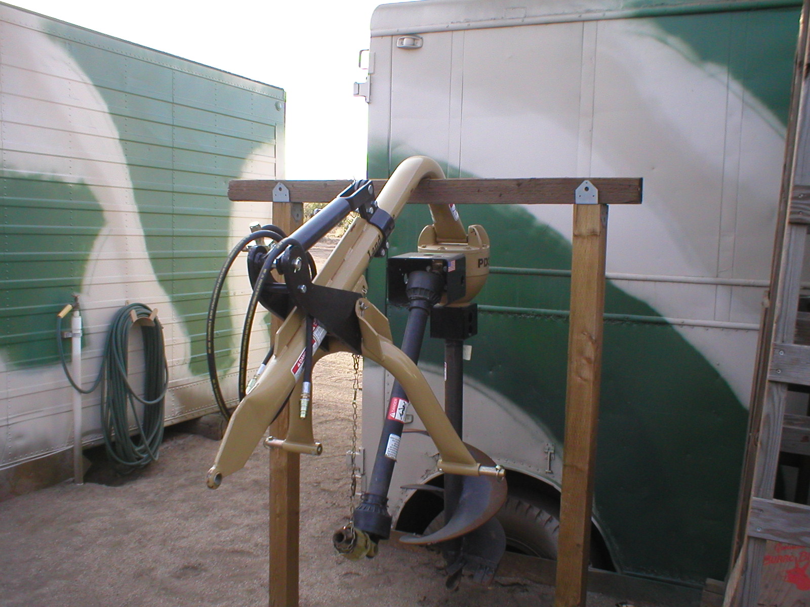

What's the best way to store a post hole auger if you don't have an equipment shed? I have to think that just leaving it sprawled out on the ground can't be good for it. Anybody have pix of a simple stand they made?

you just make a steel Aframe stand like a swing set frame.an make it tall enough to get the auger off the ground.
   / Storing post hole auger? #3

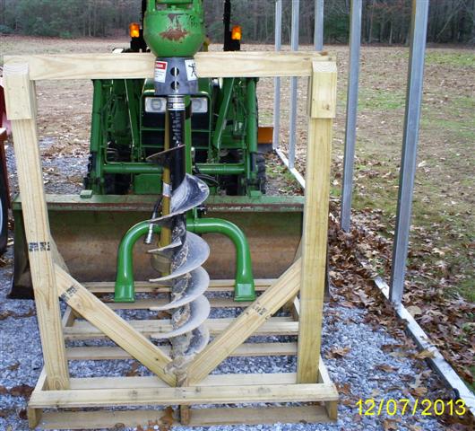

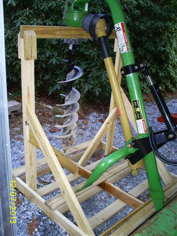

4x4s & some H brackets. About $20 and you would be all set. ;)
Brian;
I assume that the horizontal member is put in place before lowering the post hole digger?
Looks like a great idea.
Rick
   / Storing post hole auger? #7
Brian;
Rick
The horizontal piece is removable and just sits in the saddles. This setup works VERY good and usually only takes about 5 minutes to get all hooked up with ZERO fighting of the implement. ;)
   / Storing post hole auger? #8
Thanks Brian, need to build this to make installation easier. Is the hydraulic cylinder for down force on auger?
Rick
   / Storing post hole auger? #9
Yes, the down pressure kit has saved me days in drilling time. ;)
