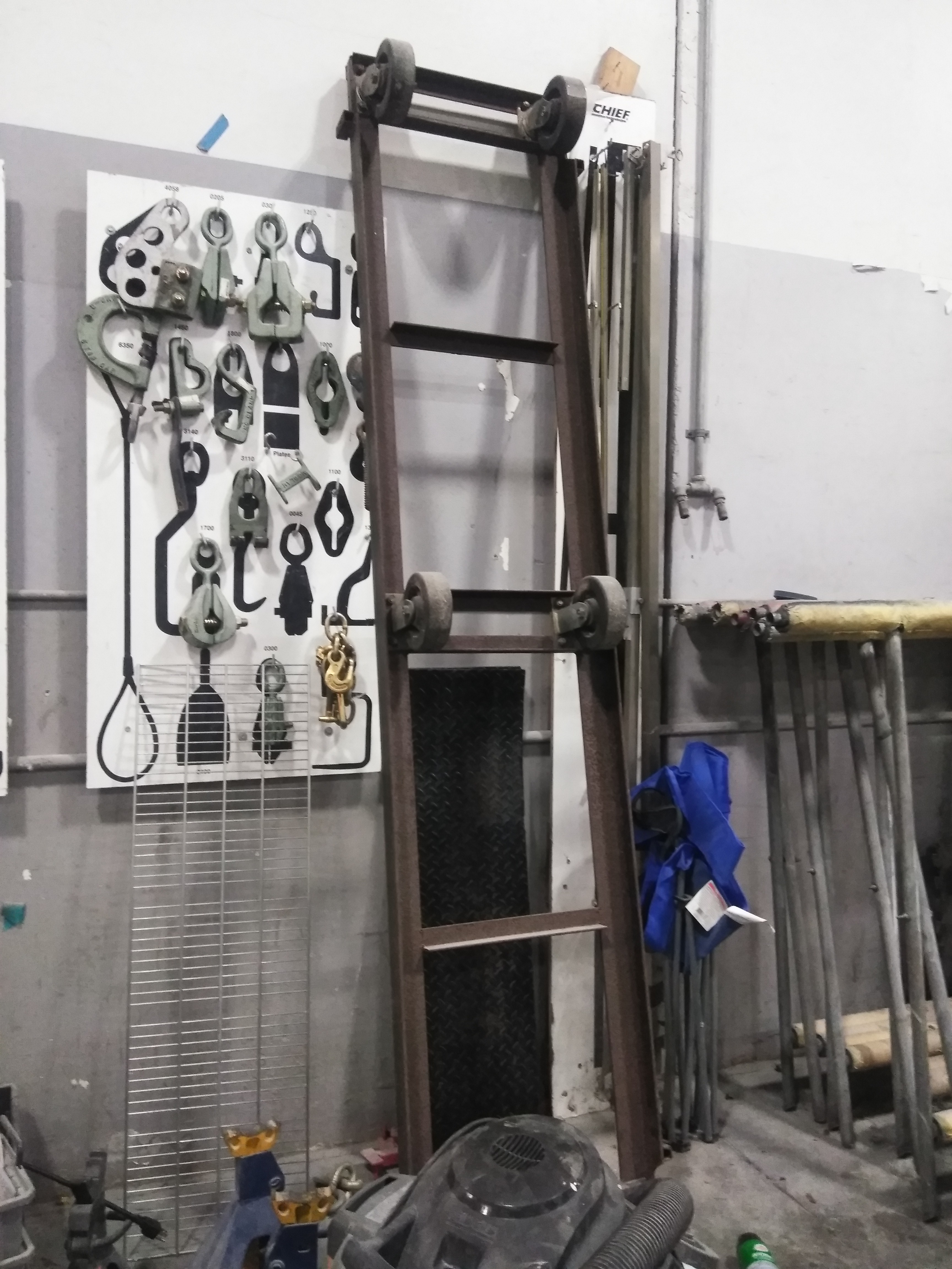

I need to build a dolly for my backhoe, it's a couple of hours away unfortunately.
Can someone give me some rough dimensions of their dolly.
I know some of you guys have built them.
We had an old dolly sitting out back that is 20 inches wide by 8 feet long, I'm thinking I can make the backhoe dolly and the fel dolly out of this so it would be easier to position the things.
Thanks

I think you are making a mistake by asking for dimensions of someone else's dolly. The backhoes are different sizes and mount differently, so what works for me may not work for you. The storage size of my backhoe is about 14' x 3' with the stabilizers raised and weighs around 1500#. The dolly I'm making is only 2' x 10' so the backhoe will hang over it by a lot - so now it becomes a COG and balance issue. I've given a lot of thought to that and feel that I have a good handle on it and it will be safe to move around once it's all put together.
/ Storing your backhoe #3
I had one that I made using two furniture moving dollies and some 2x4’s. Made attaching a lot easier but was a b to move on a cement floor that sand on it.
Make sure you match the wheels to the total weight of the the bh.

I put this together in about 1/2 an hour (and it shows) after the second time removing and installing my backhoe. The frame doesn’t have to be exceptionally strong if the wheels are directly under the load.
Height and securely holding the backhoe in place are the big issues and really, you can only figure this out by having both the tractor and backhoe in front of you. I’m not sure how others have theirs held on but with this one dropped in the cutouts I couldn’t tip it or push it off if I tried.
I was in a hurry and just added material to get the height I wanted and can take it off using only the 3pt lift, installing sometimes requires a little adjustment with the outriggers. Hope this helps, I know when I was putting this together I was looking for detailed pictures and found little.
