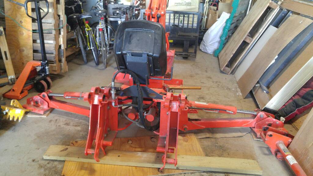

Tipping over is an issue if the outriggers are stored up. As I leave mine on the ground outside, I leave them down, with the base sitting on blocks to keep the whole thing from settling. If I put it on a pallet that can be moved, I'll find a way to block or brace it for balance.

I keep them down when stored now, but would keep up if i had a dolly Screenshot_2019-09-01-22-42-45.jpeg

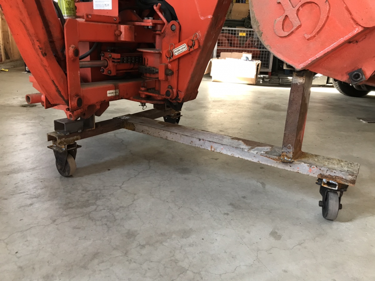

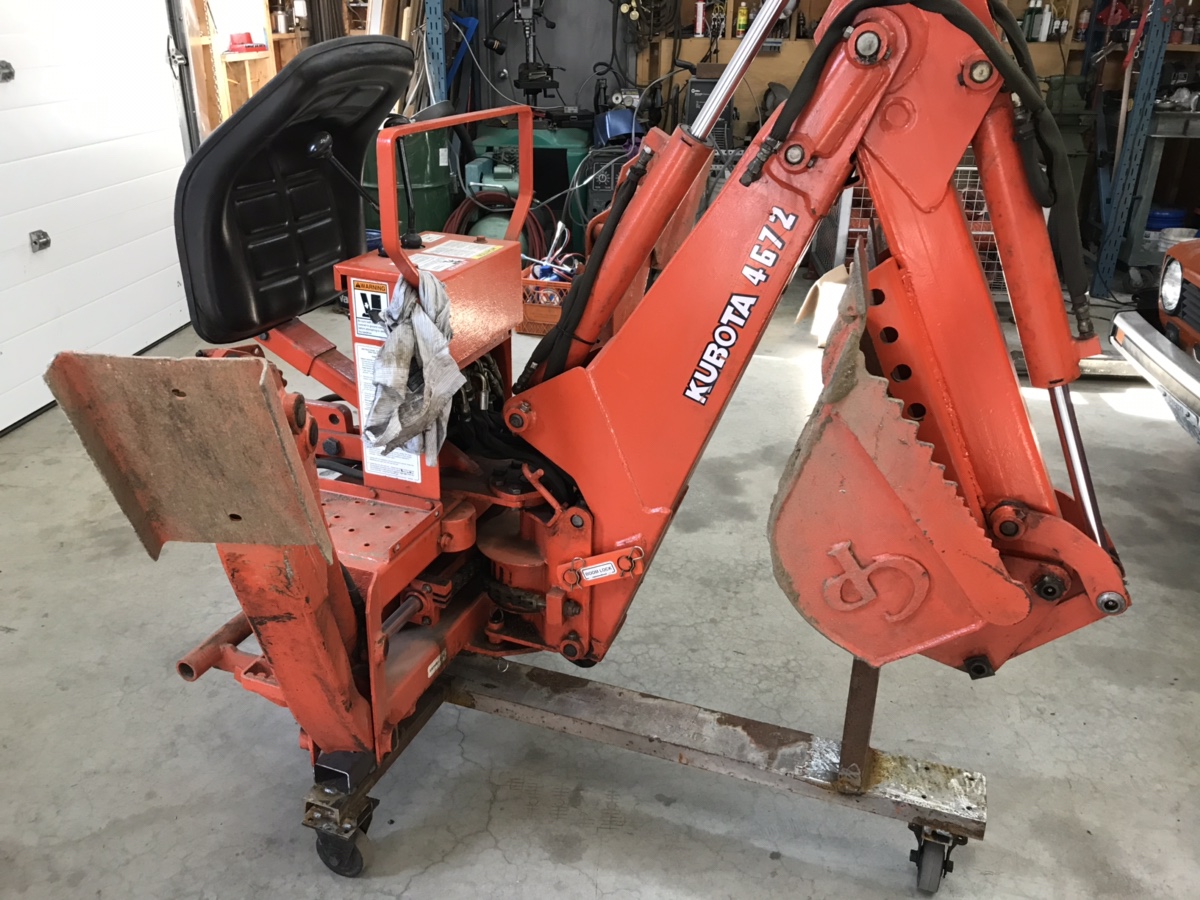

I put this together in about 1/2 an hour (and it shows) after the second time removing and installing my backhoe. The frame doesn’t have to be exceptionally strong if the wheels are directly under the load.
Height and securely holding the backhoe in place are the big issues and really, you can only figure this out by having both the tractor and backhoe in front of you. I’m not sure how others have theirs held on but with this one dropped in the cutouts I couldn’t tip it or push it off if I tried.
I was in a hurry and just added material to get the height I wanted and can take it off using only the 3pt lift, installing sometimes requires a little adjustment with the outriggers. Hope this helps, I know when I was putting this together I was looking for detailed pictures and found little.
On a side note, I just added some additional covered storage to the tractor shed and will store the backhoe there and struggling to decide whether to build a dolly with pneumatic tires to deal with the gravel ground cover or just put in a 4x6 concrete pad that I can roll it on. Seems the only tires I can find for this kind of weight are at least 10” diameter and would interfere with dropping the outriggers.
