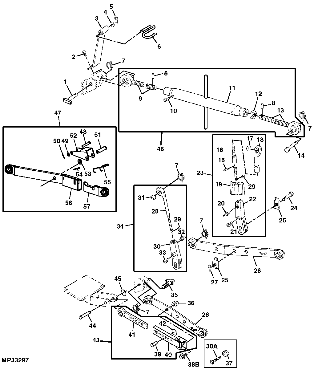

I bent the top link on my DK35 yesterday while mowing with my rotary mower. I took it with me today when I went to get the filters for my upcoming 50 hr service thinking the dealer might have the right hand threaded part that I had bent.
I was amazed how he straightened it on his press in about 1 minute. No heating, he just supported the non-threaded end and cylinder on two small metal blocks and used an small aluminum block over the threads where he pressed it. Did one operation with the press, eye-balled it, did one more press, and it was straight. Then he used a triangular file to touch up the one thread that was damaged.
My Kioti dealer is also a machine shop (Timberstar in Vernon) so they are used to doing that type of work. But it is really neat to see how easy it is for people who have the skills. It's no big deal to them. I imagine it is the same for spyderlk.
   / straightening a threaded rod #32
:thumbsup: Yeah. Im guessing your bend was not severe? - lo straightening risk. Do you know what happened to make it bend? Im asking because if it bent from compressive force [buckling] it would be termed more a failure since this is a normal function called upon in use. If it bent from accidental side force I would call it damage. Id rather be fixing the accident, but upgrading the failure. See what I mean?
I will always use heat when straightening any non trivial threaded part that is bent enuf to impede a nut. The reason is notch strain. Virtually all bending movement takes place in the very small area at the bottoms of the threads - an extremely intense situation when you think about it. Heat eases the abuse by softening things up a bit. The harmless limit is around 600F. This is where shiny steel colors blue/purple. A straw-brown color precedes this, occuring around 400F. Any heat helps. The colder the metal the more difficult and abusive bending is. Threads/notches are just a worst case.

I'm quite sure I bent it with compressive force, likely transitioning at the bottom of a sharp rise. That is, going from flat to rising or even straddling a concave section. It's a fairly tough 4' mower and does not move side to side. I mow some steep, winding, and rocky walking paths.
The link that came with the DK35 is longer and thinner than the one I previously used with my old L275 DT. I will leave one of my old heavier links on the rotary mower. I'll likely make a similar modification.
It is a quite tough (and ugly) International Machinery mower from China and has a plate that swivels at the top link attachment that has two arms attaching to the rear of the mower to provide some up/down play of the rear of the deck. But I guess not enough play for my use.
I saw on another thread where someone had replaced the two bars that support the rear of the mower with chains, thus allowing more movement when the rear wheel must move higher as in a concave situation.
I did some equally mindless, and more expensive, damage last year when mowing with my Kubota L275 and going over a rounded hump. The mower lowered enough that the driveshaft contacted the drawbar, severing the driveshaft guard. That won't happen on this Kioti--as long as I remember to remove the shackel that I normally have in the drawbar.:D
There was very little bend in the threaded part of the top link and it was barely noticeable by eye and a bit of damage on about 1/8" of one thread.
