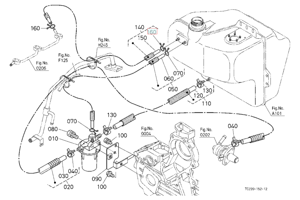

Here is the diagram. Definitely not related to injector return. The injector return runs into a separate input to the top of the tank. Filter return simply returns straight back to its own connection to the top of tank and no restrictor is shown (it could be built into fuel filter housing though).

Thanks for the parts illustration. It appears there are two lines returning to the top of the fuel tank and they are not combined as I thought they might be
One line from the injectors and another, right beside it, from the fuel filter.
This question just has to do with my own curiosity.
Can you see into the tank in the area where the two return lines are?
If you can, I would like to know if the two lines just end inside the upper part of the tank or if the one from the filter goes down into the tank near the bottom so its end i always in fuel.
I recall a comment you made earlier about the mechanical fuel pump suction port being on the outlet port of the filter and this is visible in the parts illustration.

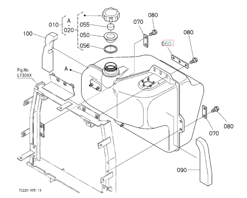

Thanks Dave!
I just went and looked in the tank. There aren't any tubes in the tank that go down to the bottom. Just a little bump with a hole in it. Walls were smooth and didn't look to be any molded in channels. I would assume that if there were any tubes inside (or even channels) that they should show up on the fuel tank parts diagram below.
I'm thinking that the return from the fuel filter to the top of the tank is to allow air to escape the fuel filter to so that it can fill up with fuel when you change the filter element. Since it's on the suction side of the lift pump, I would have to guess that there is a check valve built into the fuel filter housing to prevent it from sucking air. I don't see any inline check valve and there are no inline devices shown on the fuel system parts diagram.
What are you thinking?

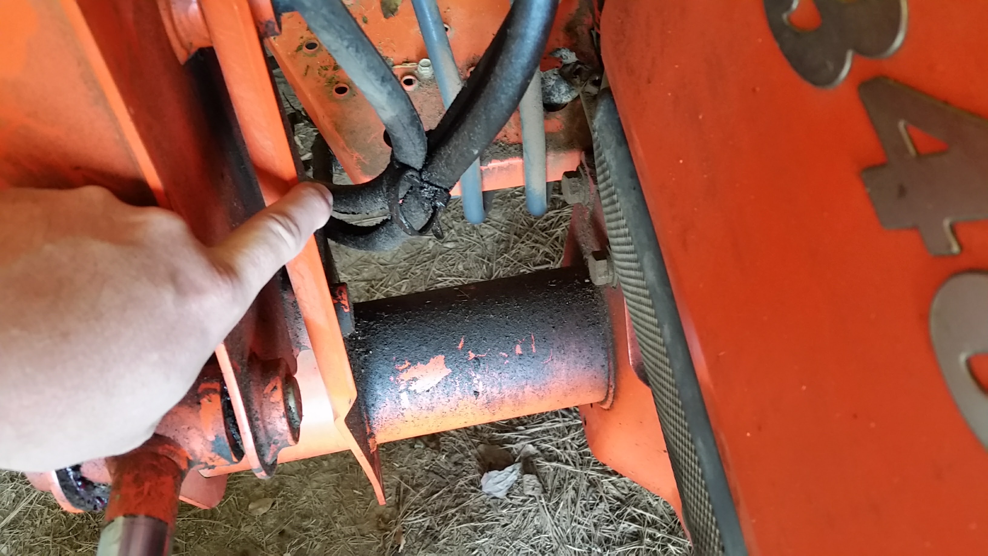

I'm also toying with mounting the Racor filter on the loader frame instead of making a custom bracket and replacing the existing filter. If I do that, then I can just leave the whole existing fuel filter in place. See where I'm pointing to a mounting point below. This would probably be more protected than where the existing fuel filter is, but it also may be hard to replace the Racor filter element. The loader hydraulic hoses are sort of in the way, but maybe I can make it work. Once filter gets here I'll hold it up there and see what it looks like.
