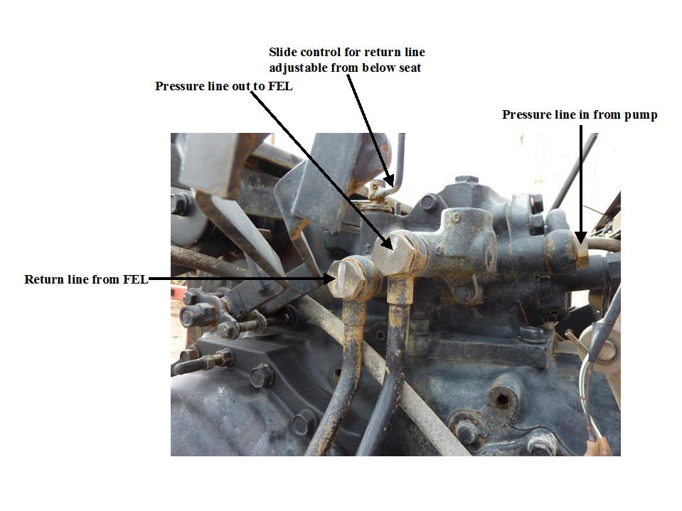

I routed the FEL return line into the sump fill opening and the all FEL functions worked fine including raising the bucket. Apparently, the return fluid is being restricted somewhere in the system causing some back pressure in the return port of the FEL controller. I pulled all the lines and couplings in the return and check for blockage. The return line goes through an adjustable control valve that I blew out with compressed air. The FEL is now lowering, but it raises somewhat slower. I can live with it though. Thank all for their input and help.
Could this be the pressure relief valve? The return would come off of it.
The return line normally goes directly to the reservoir.
Need pictures.

The link below is to a post on the forum by someone with the same tractor and loader that I have and shows pics of the hydraulic connections to/from the 3-pt cylinder housing. I took the liberty of taking a snippet capture of on pic showing these connections. I also added labels to the connections :
