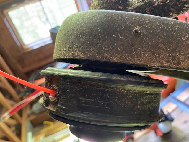

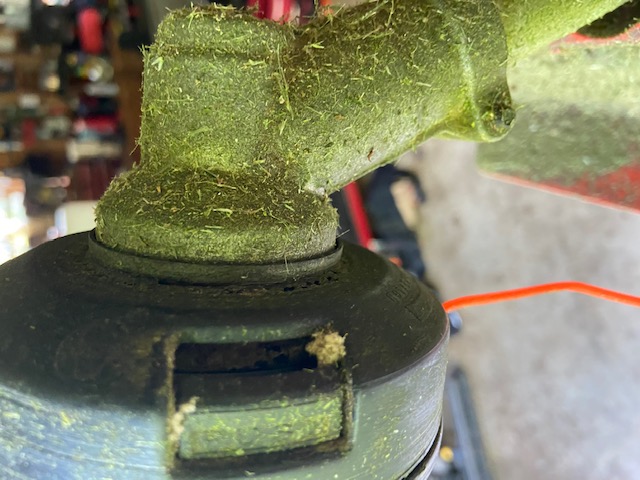

as TXdon says start high and work down on the material is what I do. But the other thing is the head design. I have an Echo and a Tanaka and the Echo head has a gap between the head and the spool which wraps grasses and vines in a few seconds - I was constantly stopping and unwrapping grass/vines.
The Tanaka which has a close tolerance head design and unless its really in thick material doesn't wrap much at all.
