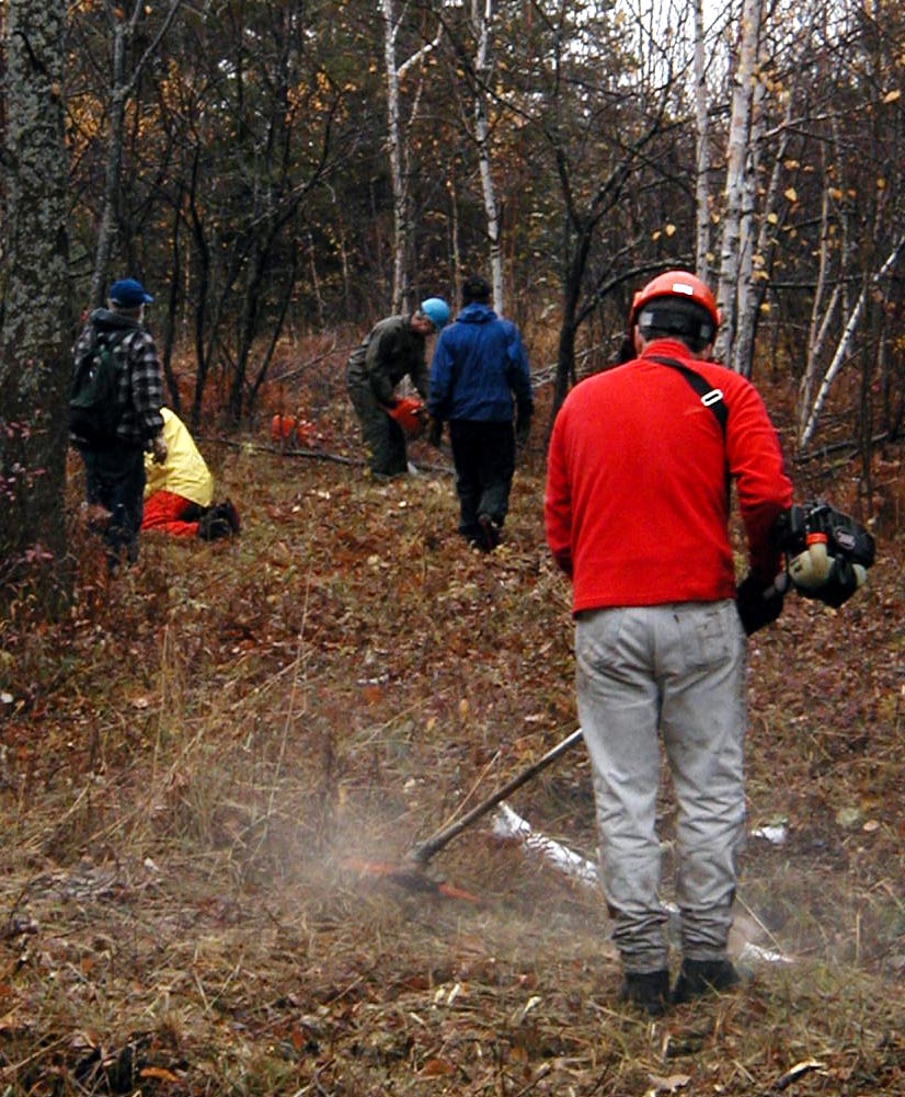

I find string trimmers to be tedious at best. I much prefer the Stihl Polycut head on my Stihl brush cutter. I can trim tall grass and weeds for hours and never fiddle with string at all. Not for woody stemmed junk. For that I install the metal saw blade.

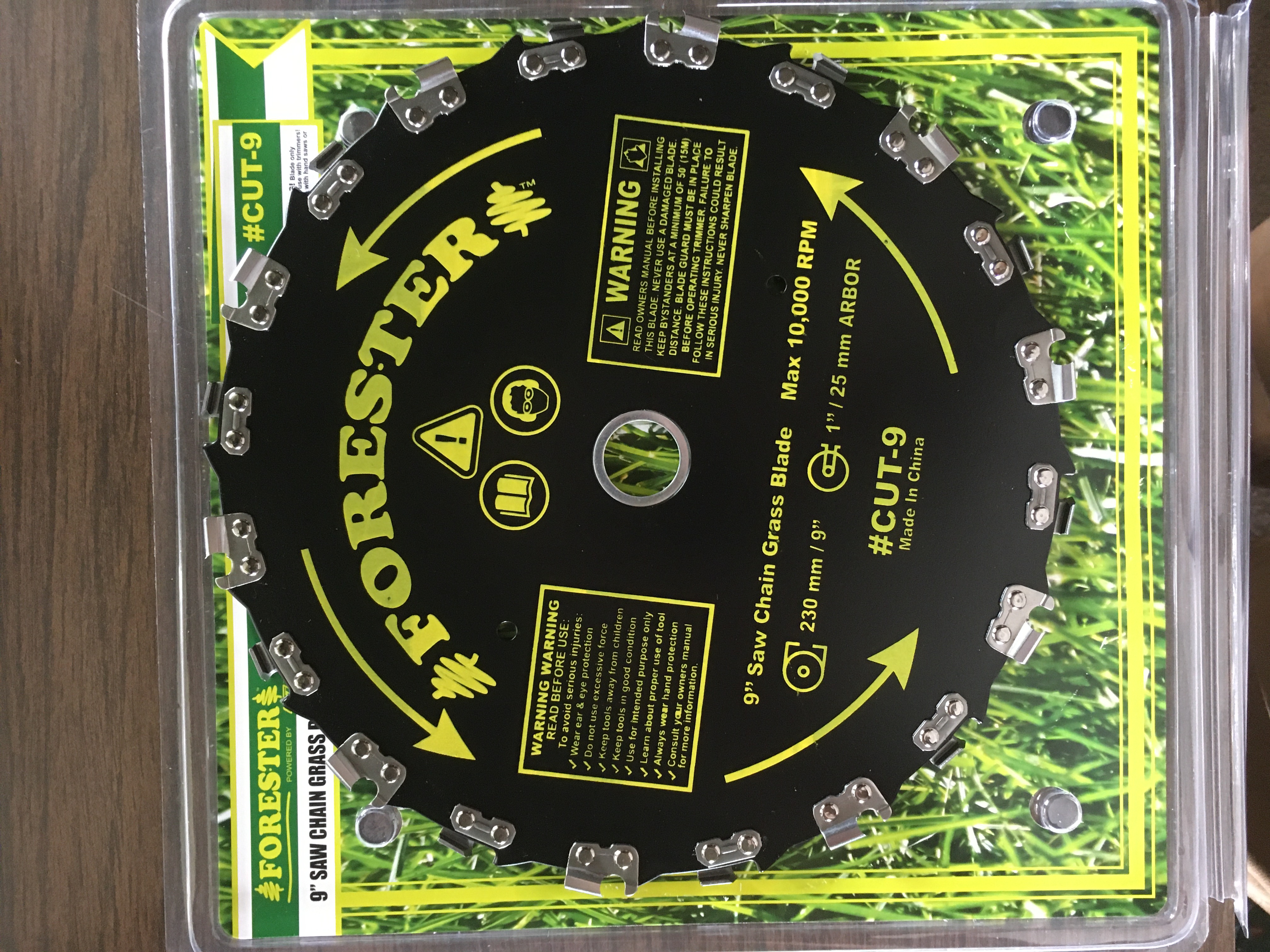

Got one with my Stihl new and it wasn't made in China either. German manufacture. I used it a couple times to remove saplings. Thats it. Just remember, they don't work with anything but a straight, solid drive shaft trimmer. One of those trimmers with the wire driveshaft will unwind inside. Cannot take the torque load.
/ String Trimmer Tricks? #39
Thanks for the reminder. I’ve got a Stihl that will run it. I’m interested in the blade you have and what brand it is.
Very first trimmer I bought over 30 years ago was a straight shaft. Wasn’t long until I had a saw tooth blade on it cutting saplings on a lot i was reworking for rental mobile home spaces. My brother chided me into getting this blade but I’m always looking.
Did you learn that the hard way? I imagine that a blade like that would impart significant shock-loads to the cable as well. Makes sense
that the cable can not take it. The ring/pinion gears on a straight-shaft trimmer may not last, either.
