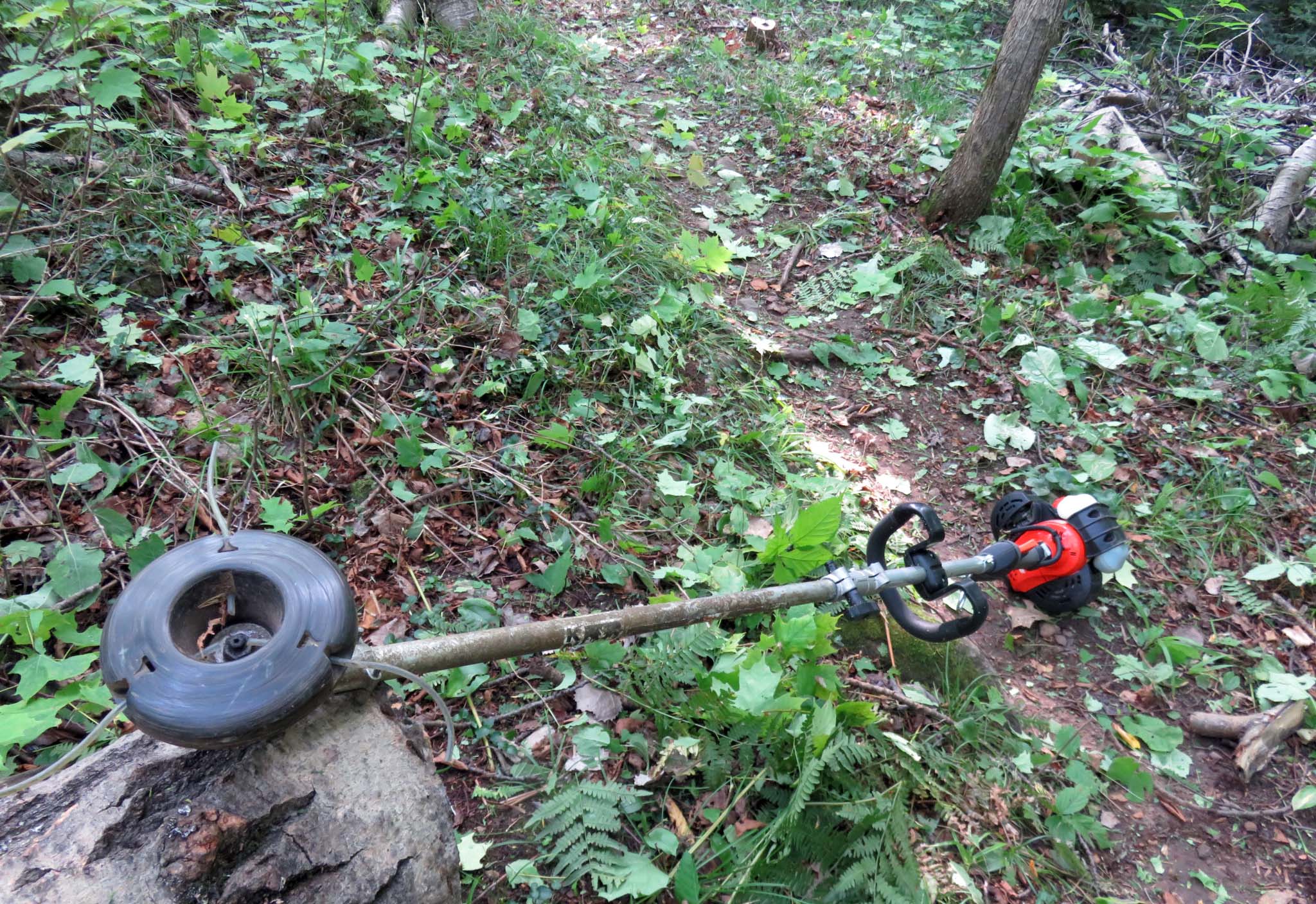

We've ran 155 string for years to clear trails with but Sthil came out with a head to run 180 in. I'm trying to get one. For taking out serious weeds, grass and and shoots bigger is better but they take power to spin.
