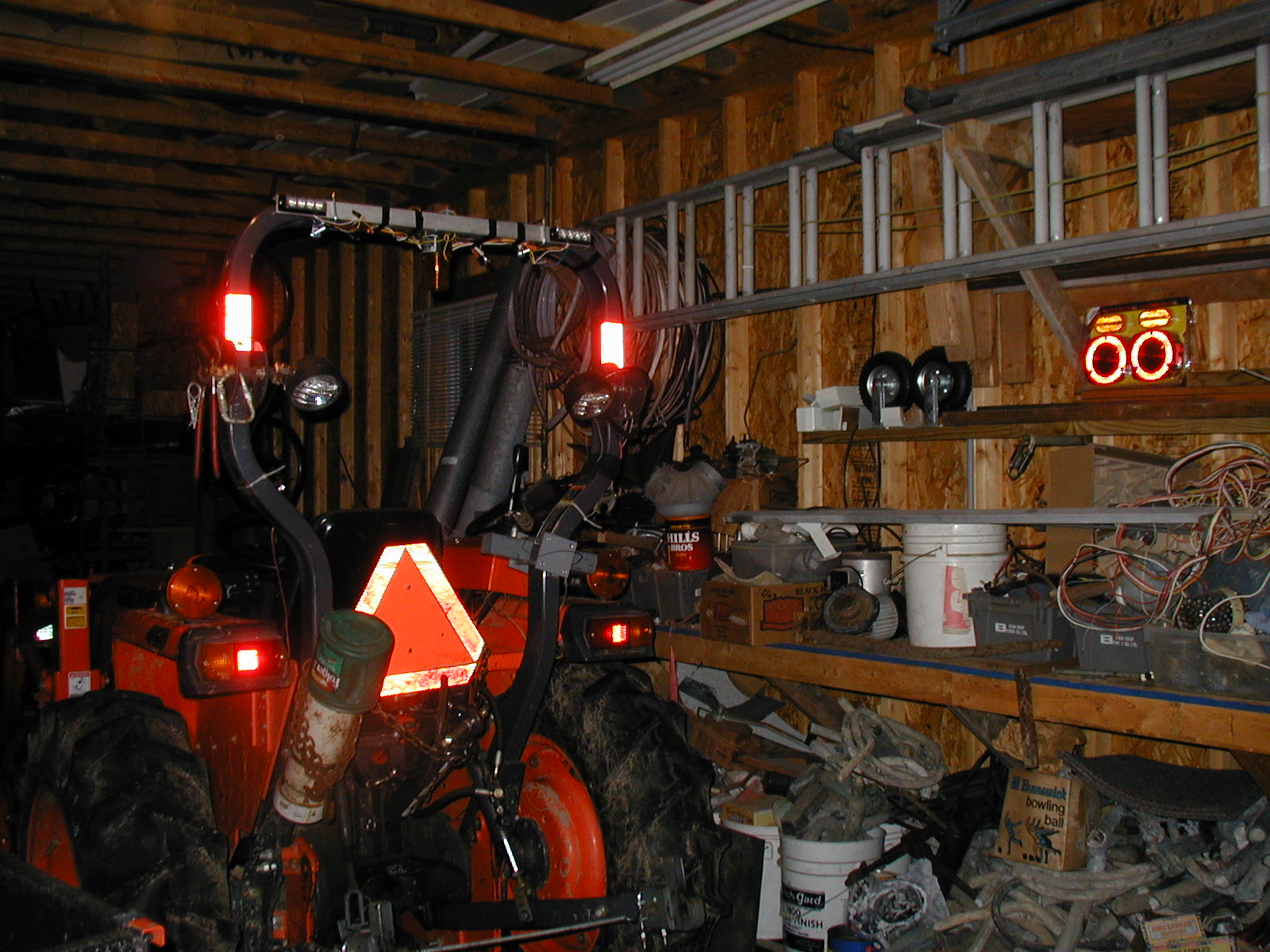

I ordered 6 of these. Two for the tractor, two for the Plow Truck, and two for the RTV 500.
Strobes N' More
They are bright and the Company ships pronto!
Beware of a Company "LED Outfitters" not a good consumer rating.
Enjoy their video and my pics. (Darn Reflectors have to light up Blahhh)
Also have a thread in the RTV section. Might get brave and do a yutube.

I have the rack made and mounted on the RTV 500 with the Strobes. Looks good in the low light conditions!
I will have to wait for the wife to use her computer Savy to post pics of both the L3400 and the RTV 500.

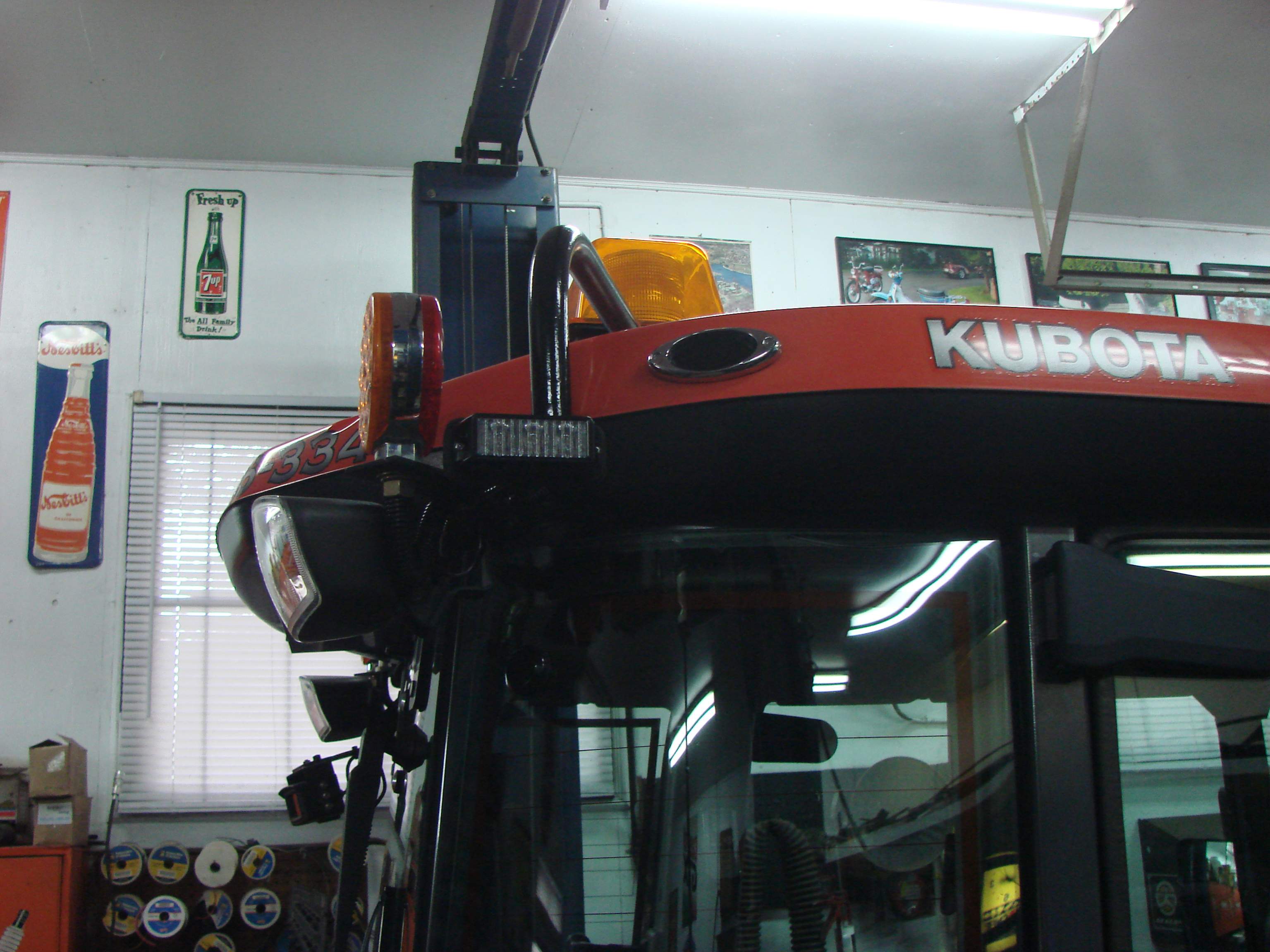

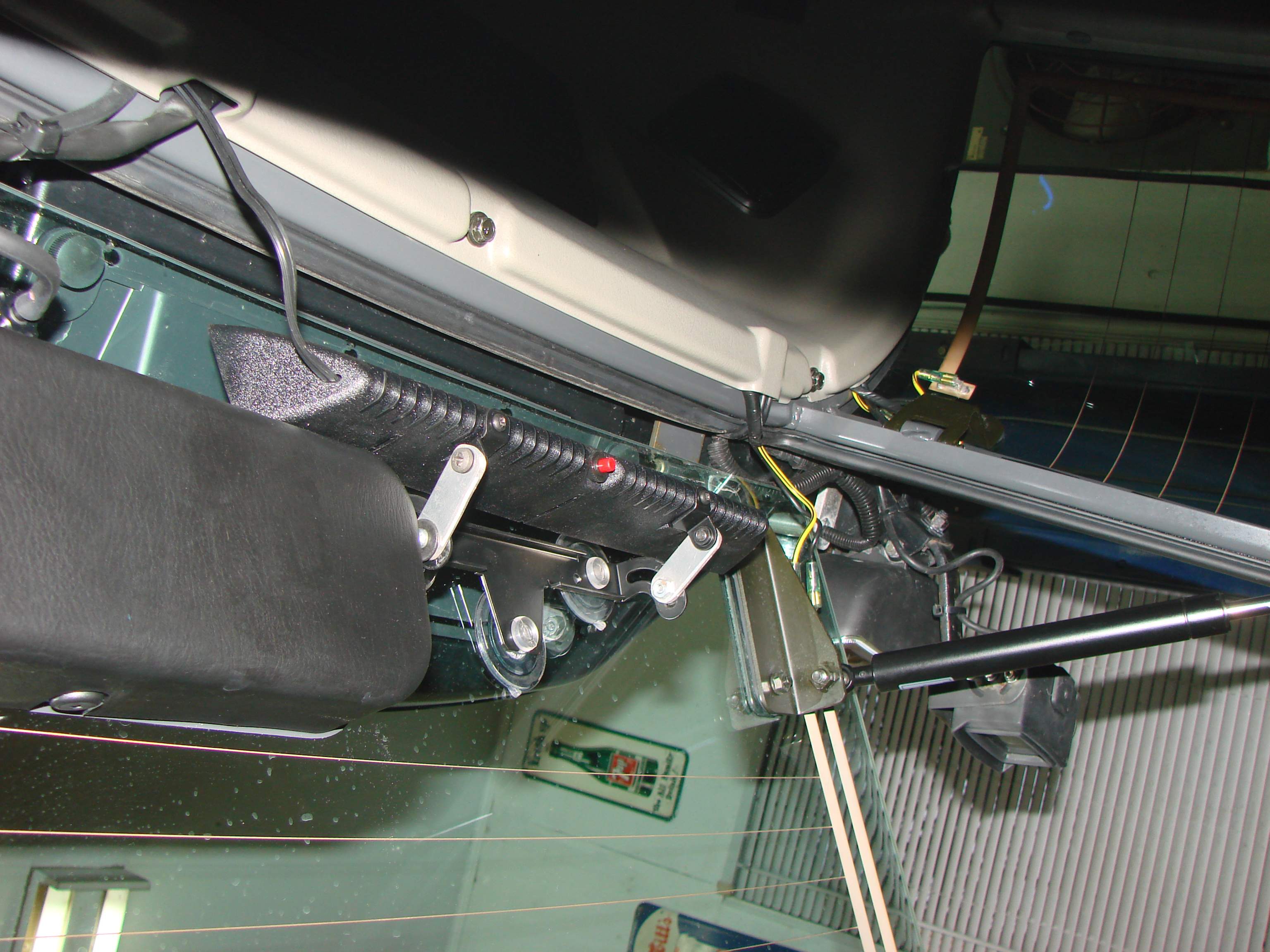

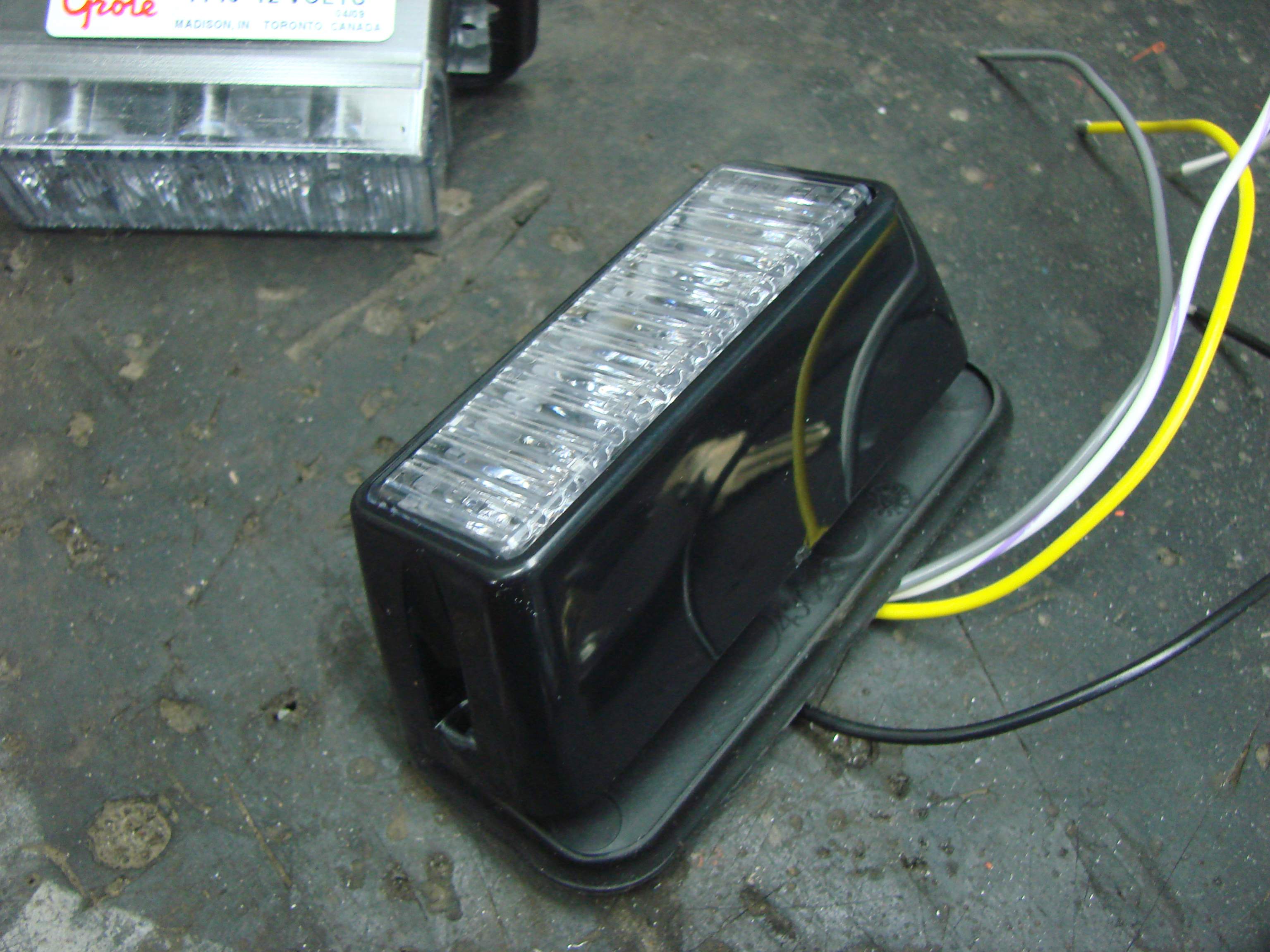

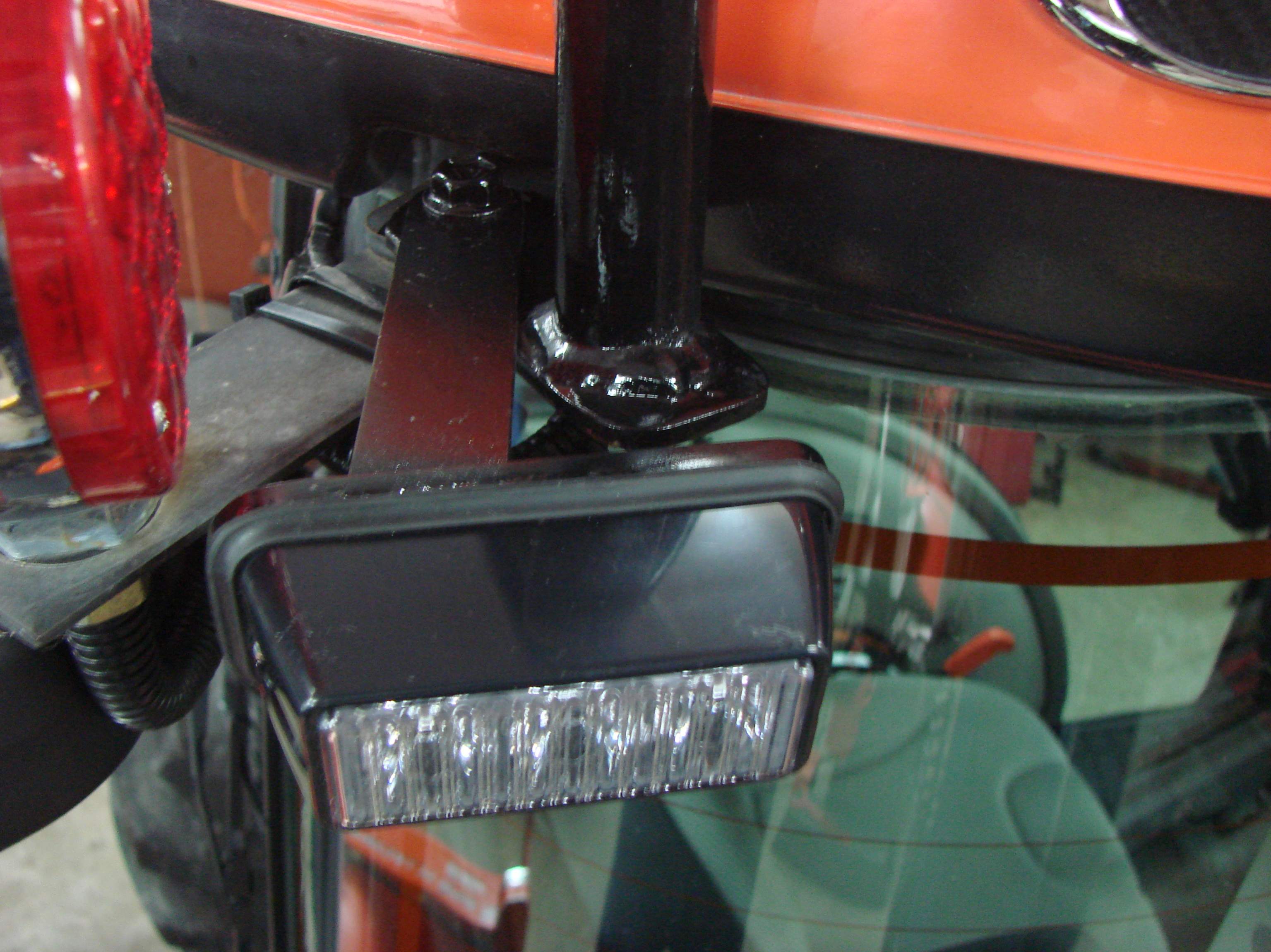

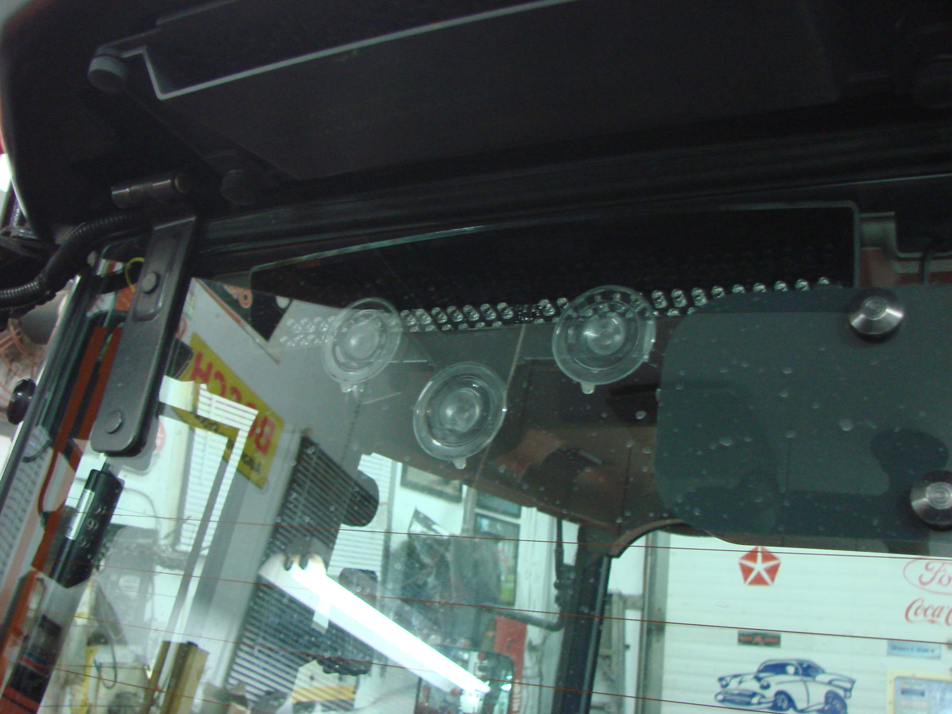

Well I got my strobe light from Strobes N More. Great quality and fantastic service. I know a few vendors that could learn from these guys. super fast shipping.
Anyway I mounted mine in the rear window. Modified the mounting system a little to make it work and it did. I also picked up some amber 4"strobes locally. They are made by Grote and fabricated a few aluminum brackets and mounted them on the side of the cab. They are quad flashing and very bight. Now I will be seen. :laughing:

4shorts... very nice lights, they are made by Whelen (RSA03zcr) even though the say Grote, they are a VERY nice light, hopefully you hooked the sync wires up?? We use a lot of them in the emergency vehicles we build. Lately we have been installing the Vertex units, VERY small and VERY bright... Whelen Engineering - Lightheads - Lightheads, Directional Strobe, Super-LED, LED, Halogen & Combination ,these are worth looking at if space is limited.. Jim
Hi Jim. Great info. The only light that didn't say Grote was the light in the rear window and that one said Whelen. Didn't know about Grote being Whelen. The upper four inch strobes I didn't sync because there on the opposite side of the tractor and both couldn't be seen at the same time. If they had been seen together I would have synced the two. I'm assuming I'm correct in thinking that's right :confused:
Great looking web site there sir. I got to head over and give it another look. Thanks for your comments and wisdom ;). Paul
