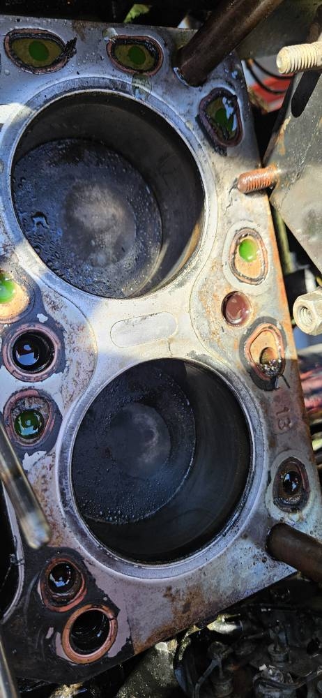

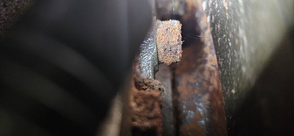

I don't think it's Cyl. problem. Just a Guess! I'm with Ca. I would be looking at trying to look inside the Bell housing. The Ford Clutch that was stuck and you could see were someone tried to use a Prybar on the Clutch itself to get it loose. The shop agreed as soon as he showed me it. Prybar!
I didn't see it split but kind of wish I did. To be stuck that bad my guess Rust!.. What are we looking at with your tractor? Major rust and corrosion.

If you're positive it's stuck rings, try white vinegar (cleaner, not salad dressing) in the cylinders, then when she moves, a good flush with seafoam/oil/atf/penetrating oil/etc./whatever to displace the vinegar. then oil change.

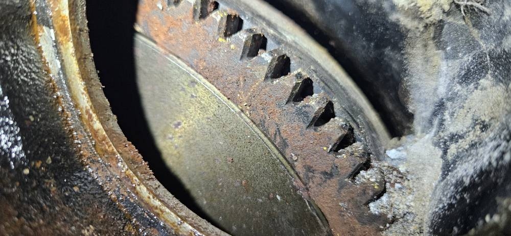

My neighbor was a Lieutenant with the Cedar Rapids Police Department and on his days off, he did landscaping. He babied this thing as he does with all of his stuff. He parked it in his machine shed when he retired from CRPD and also stopped his landscaping as well. Where he parked it, that's where it sat until we moved it. Since we are here in Iowa and have some pretty wicked humidity, that is likely what caused the flywheel to get like that.
I just got the remaining ATF/xylene mix out of cylinders (they were now about 2/3 full each) and drained the pan. So, a fair amount moved past the rings. So, I'm leaning more towards flywheel now. Put a fresh filter on and oil in it. Will talk to repair guy this week on my days off.

Anyway, it does't look like rings to me. I think you should take off the top of the transmission case and see if things turn. It is easy to remove the shifter cover. Just a few bolts. You can resuse the gasket with some sealant or even without. The gasket is above the fluid level.
Your trick of using the PTO only works to turn the engine if the transmssion is not stuck.

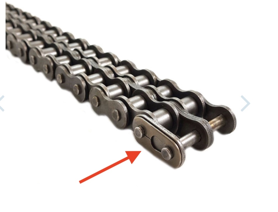

How do I disconnect the front hydro pulley from the master link? I want to give that a try
   / Stuck yanmar 165D #77

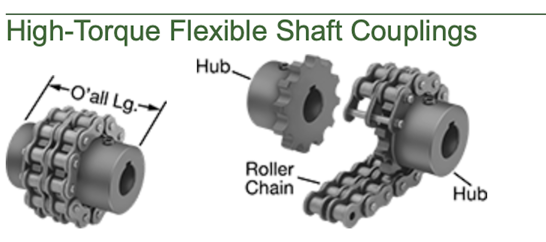

Well, the front hydraulic pump driven off of the crankshaft nose was an option for the YM165 loader. The loader could also be driven from a diverter valve connected to the tractor's own hydraulics.
So first thing is to see if yours even has the front pump. It may not. But if i does the pump is obvious there behind the front bumper. There are two hoses, the Cessna pump, and the chain coupling.
The master link may/may not be accessible. Normally one would turn the engine to gain access if the master link is hidden. If not, I have no easy ideas....But it is worth a look, and those pumps can sieze up.
The masterlink has a spring clip on one side. Just like a bicycle chain. You expand the clip by twisting a screwdriver in the slot and then with your other hand simultaeously move the clip laterally so that it comes off. Wear safety glasses.
