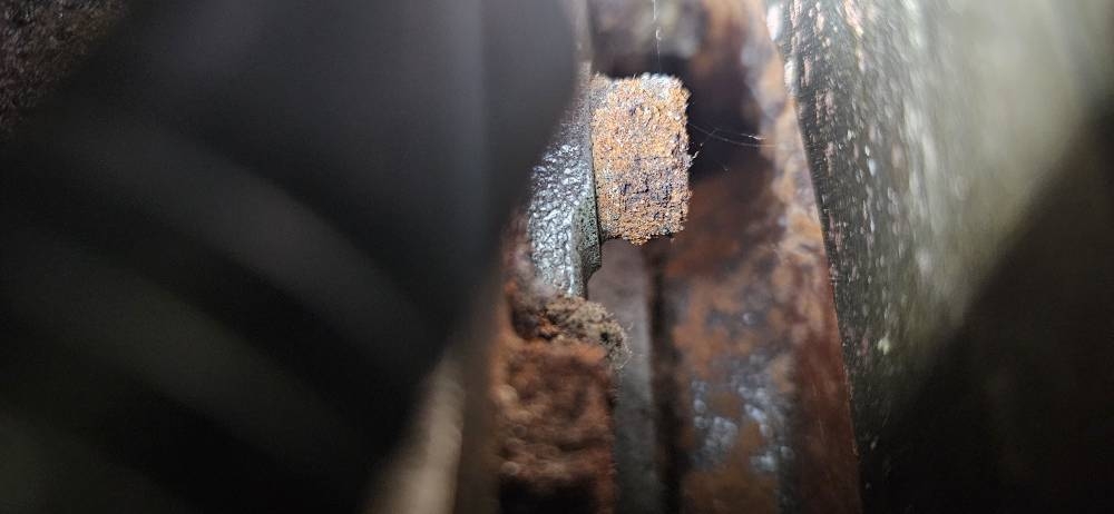

With nosigns of the rings being broken or a Broken Piston is a good thing. And the drip of oil on the Rod bearing is a good sign. No big Breaks or Gouges from the looks. The piston has Oil Rings and let a small amount of oil pass. Lubricates the Cyl. wall.

Put that head back on and pressure up a Cyl.. Then with all that pressure plus trying to to pry on something should do it. If the cylinder is good it's going to hold pressure and a huge amount of force.If that doesn't loosen it up your pulling Rod caps and Main crank bearings until you do find it. My guess from the looks of the Pics it might not even be the pistons I don't see any signs of a problem to lock it down. Bad thing about not being at the tractor. I guarantee you I would know for sure in Few minutes or a couple hrs. at the most!

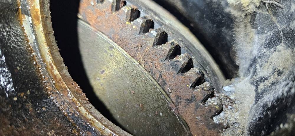

I'm not convinced splitting the tractor will help and it sure adds complexity. At most, maybe loosen a few bellhousing bolts at a time to see if one was jamming something.
In-frame additional investigation might solve the mystery - such as pulling the rod caps and pushing each piston up a little to confirm this is a stuck rings problem. Then if the crank won't rotate the slightest amount with the rods loose or detached, and you have checked inside the front cover, it's time for a specialist. The crank slides out the back of the block on most of these so I think working with that is getting into specialist territory.

Took the starter back off and tried advancing flywheel....no go. Here is a look inside
