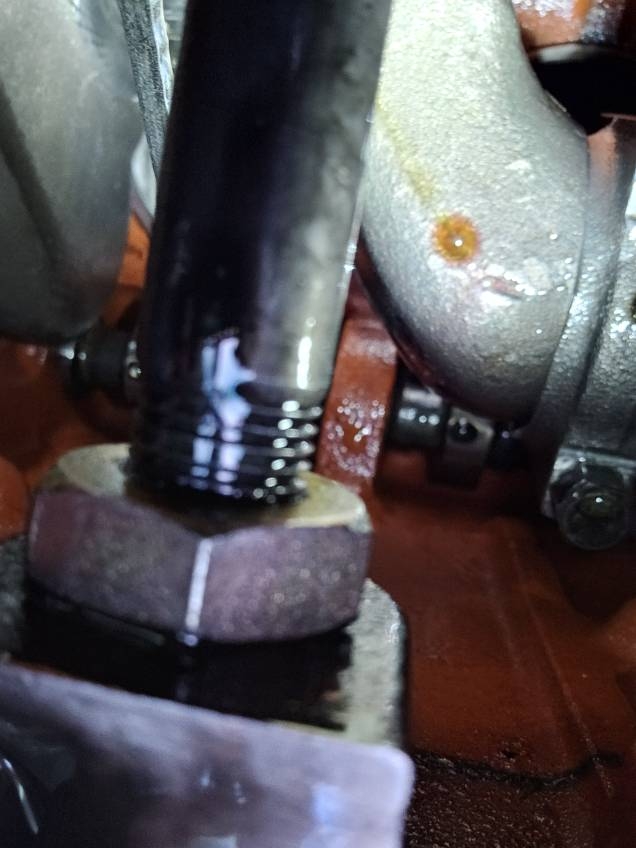

If the rod bearing caps were removed can they just be bolted back on and torqued properly? I ask because since the pan is off and the rod ends are exposed why not just unbolt the bearing caps and then try to push the pistons up. If they can't be moved then the problem is stuck pistons. It may even be possible to tap on the underside of the pistons if they are stuck to try to get them moving.

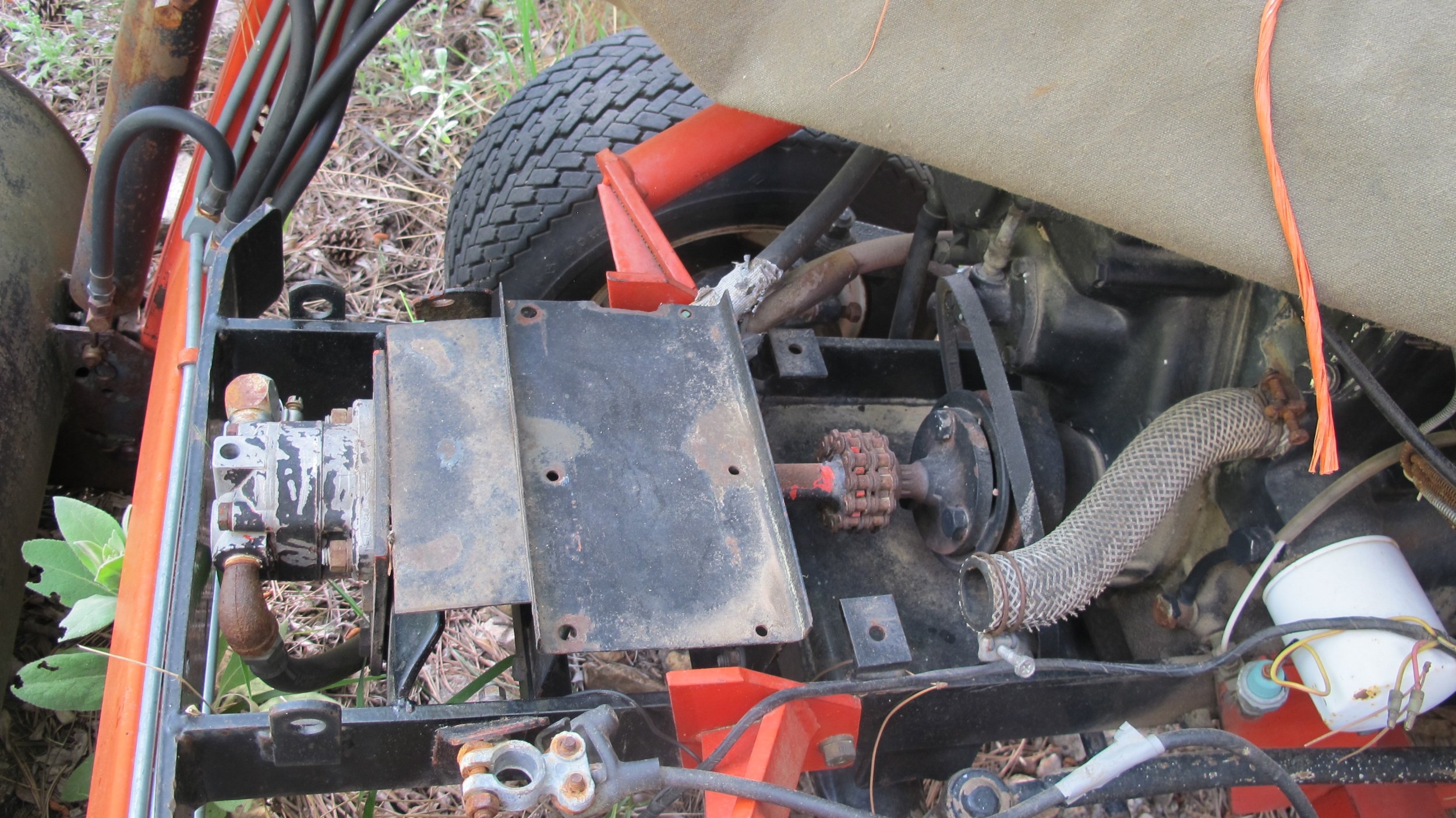

I seen a front pump for aYM276. It was nice looking. I have a front mount on my ford. What I couldn't find was the chain Driven YM165. Never seen that one before.
   / Stuck yanmar 165D #83
I wouldn't call it a chain drive, just an axial coupling using a duplex chain.
It is an oddball way to drive a pump, but mechanically it makes a lot of sense to couple two axial drive shafts that way. It allows for a bit of mismatch so the shafts do not have to be perfectly in line.
You see it a lot when coupling pumps of all kinds, irrigation pumps espeically.
I've got a tech paper from Yanmar somewhere that talks about chain couplers when they started using them. Mostly for the early two cylinder models that didn't have a high flow hydraulic pump. If there is any interest I can dig for it.
Here is a photo on our old YM165D. Can you see the chain coupler?
rScotty
Eric
Yes. I just didn't want to get into the tricks about removing and refitting used rod caps with someone that I'm not familiar with their mechanical confidence. Frankly, I don't like to ever remove rod caps on a new engine except as a very last resort.
   / Stuck yanmar 165D #85
I understand. That's why I asked. What about just planning on buying new bearings? I don't know what bearings cost but new bearings wouldn't be a bad thing. The OP needs to determine if it is the rings that are stuck. Pulling the bearing caps off would certainly be cheaper than sending the tractor to a shop. Easier too. I'm surprised someone didn't suggest this when he removed the pan. If the rings are indeed stuck then bumping the pistons up will need to be done anyway in order to replace them or to make sure they are moving freely in the ring grooves. And if the pistons move up freely then at least the OP knows the engine is in good shape. So far the poor guy has been reduced to guessing, he really needs to find out if the rings are stuck.

That is exactly what I have

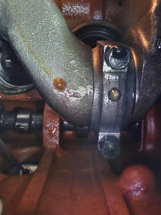

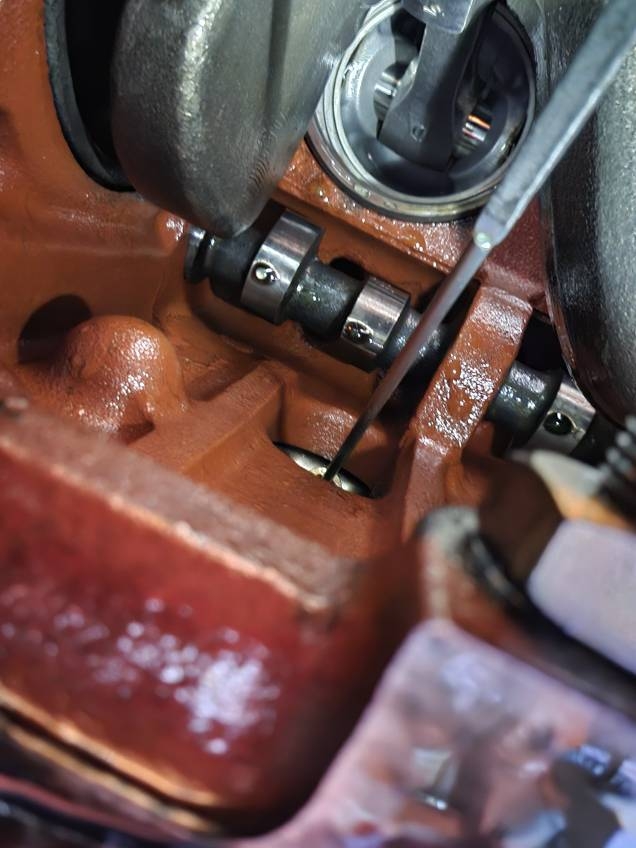

Looking at the top of the Cyl. No Scars. Then when you posted the Excellent Pics. of the Bottom End even on here there is no sigh of of piston problem or a broken ring. Chk. the Cyl. pressure going to find out if there is a problem. Your ordering at least one head gasket so might want to make it 2. JS,,

Honestly if it was me I would be looking at splitting the tractor. The top end and bottom end look really good from the pictures you sent. The flywheel area looks very corroded. I would be concentrating my efforts in that area.
And since you have enough smarts to remove the head you can easily split a small tractor like that. Unless it's really in the road I wouldn't even remove the fel. Just a jack stand under each fel mount and a floor jack from the rear under the transmission and you could easily roll the rear end away from the engine. If you don't have a concrete floor a sheet of steel or plywood under the floor jack would be sufficient.
All the best as I'm finding this thread really interesting.
Then as mentioned get that chain couple removed and the try rolling the engine over with the front pump disconnected.

I think tomorrow after I get up, I'm going to tackle the hydro pump couplers and get it off so I can rotate or try to rotate crank from the pulley. Honestly, I hope that does it and I hope the issue was with the hydro pump
You might consider leaving the hydraulic pump coupler just as it is - ignore my previous advice to disconnect it. The reason being that that coupler with the pump at the far end makes a well-supported place to try to rotate the engine. And it is simple.
If you have a strap wrench, you can wrap the strap right around that chain coupler, put a four foot cheater pipe onto the handle of the strap wrench, and have at it. A strap wrench with a strap made of a THICK piece of woven flat fabric would be my choice.
I believe that the running rotation of the engine is clockwise if you stand in front of the tractor and look at the front of the engine. Someone with a YM135/155/165 please check on that.....
