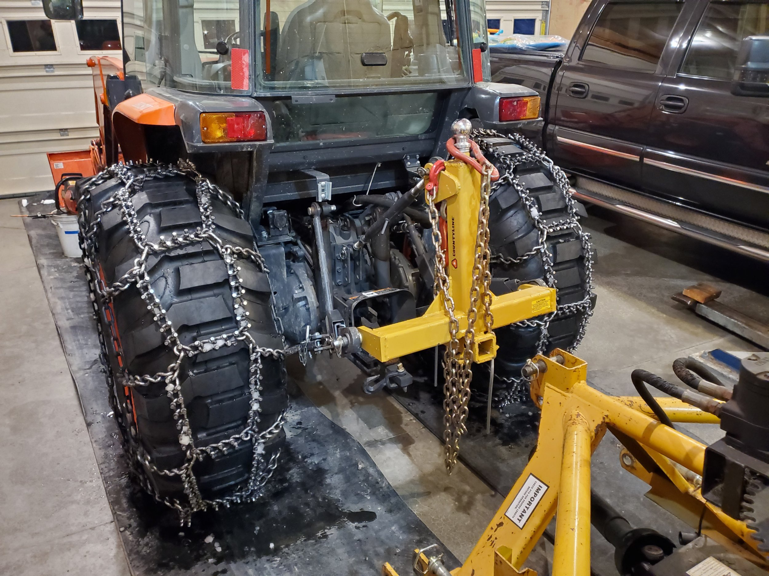

If you have hills and ice chains are needed. I run OFA EKO studded chains on my rear R4's and rarely need 4x4. I haul all my firewood out of the woods in the winter and have no issues with traction on glare ice or hard snow pack. Used conveyor belting from gravel pits works great to protect garage floors.
Can you comment further on chains vs studs on hills? I have Hills.. WV Mountain type of hills (up to 30%+).. I've seen you response in my other snow thread (have studded chains currently), but would like to understand your insight. I am guessing it's more likely studs get 'ripped out' on the hills, but studs should get plenty of stress pushing large amounts of snow on flat surfaces as well.
   / Studs for snow plowing #40
Studs work on hills up to a point but chains work better. Chains on asphalt on hills will tear up the asphalt if the tires do start spinning. The goal is to not let tires spin but sometimes you can't always meet all the goals.
