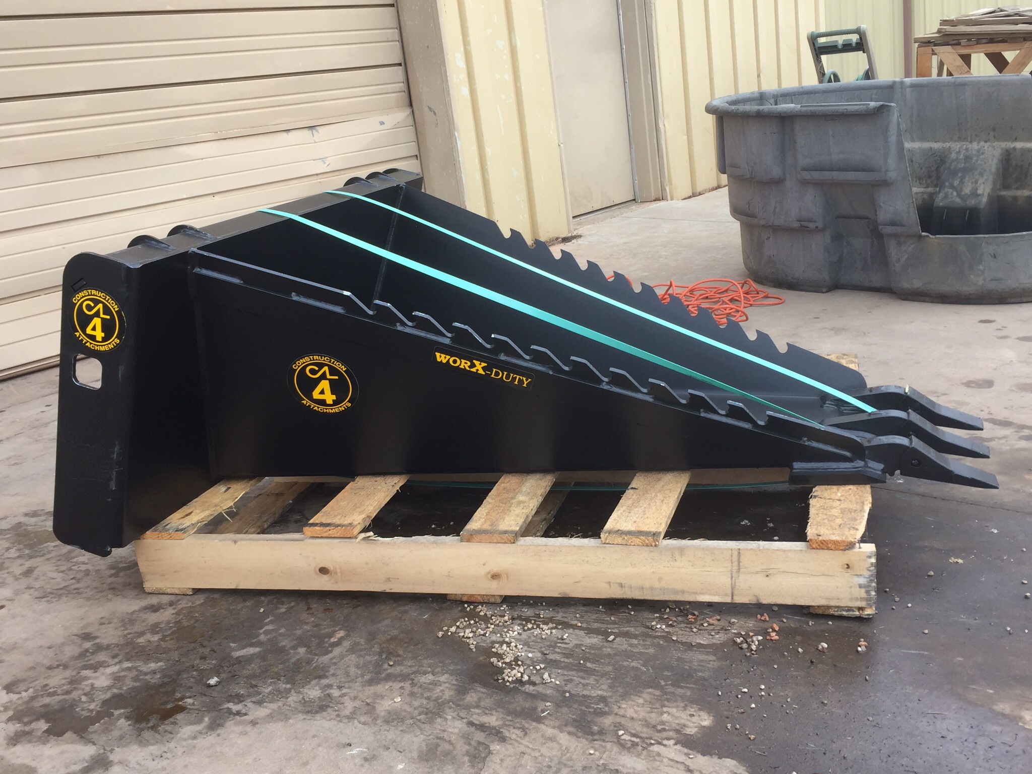

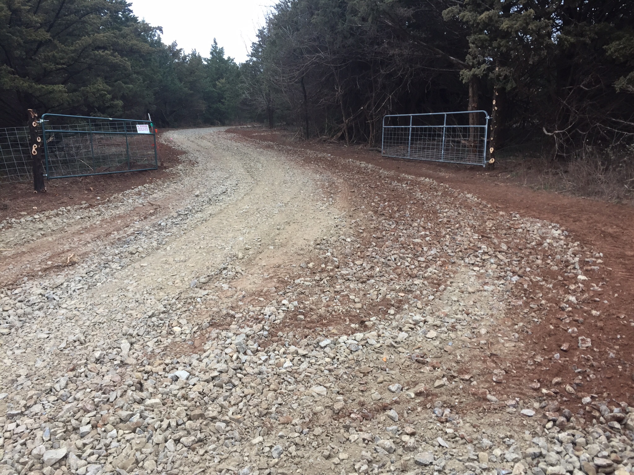

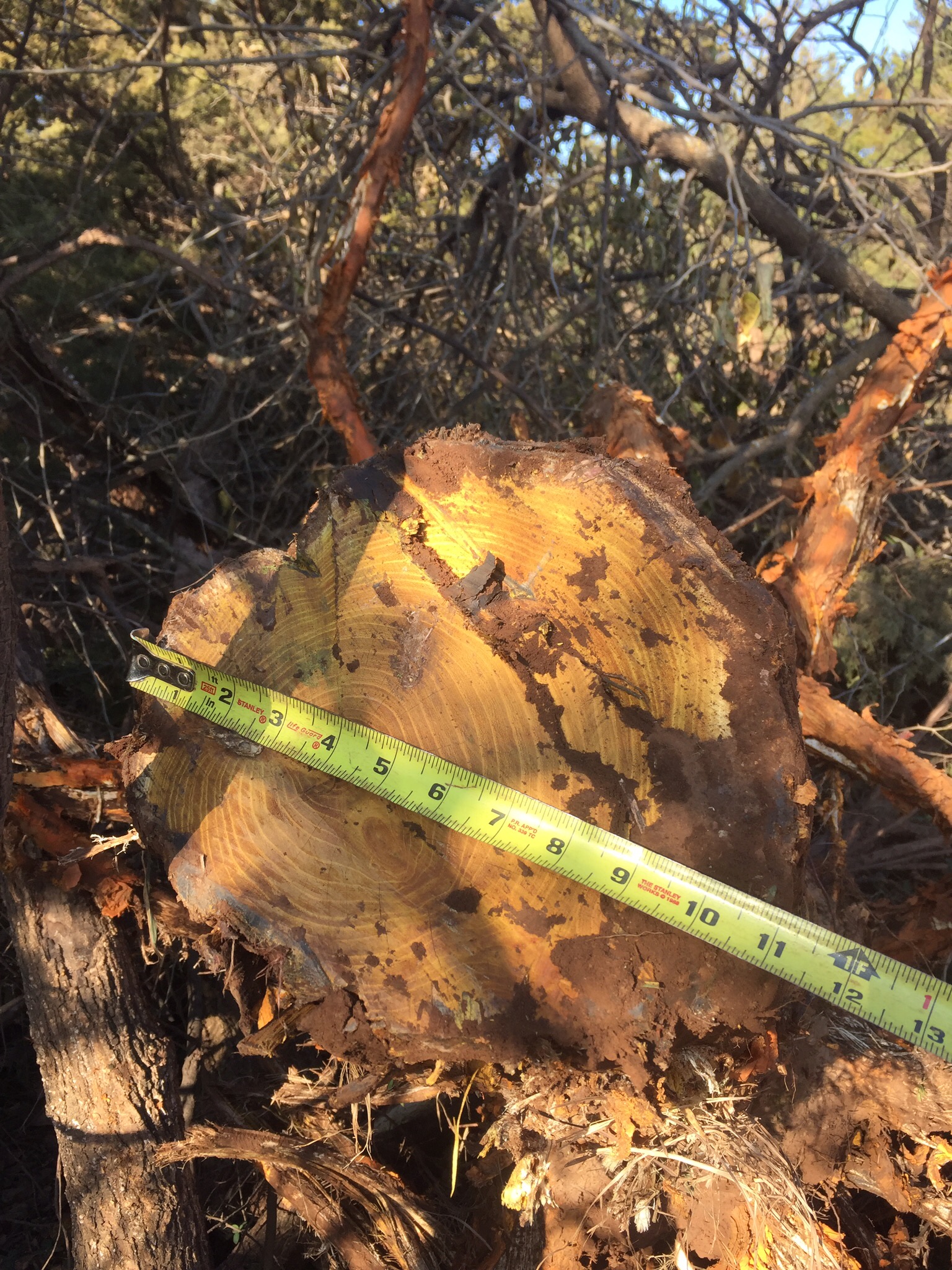

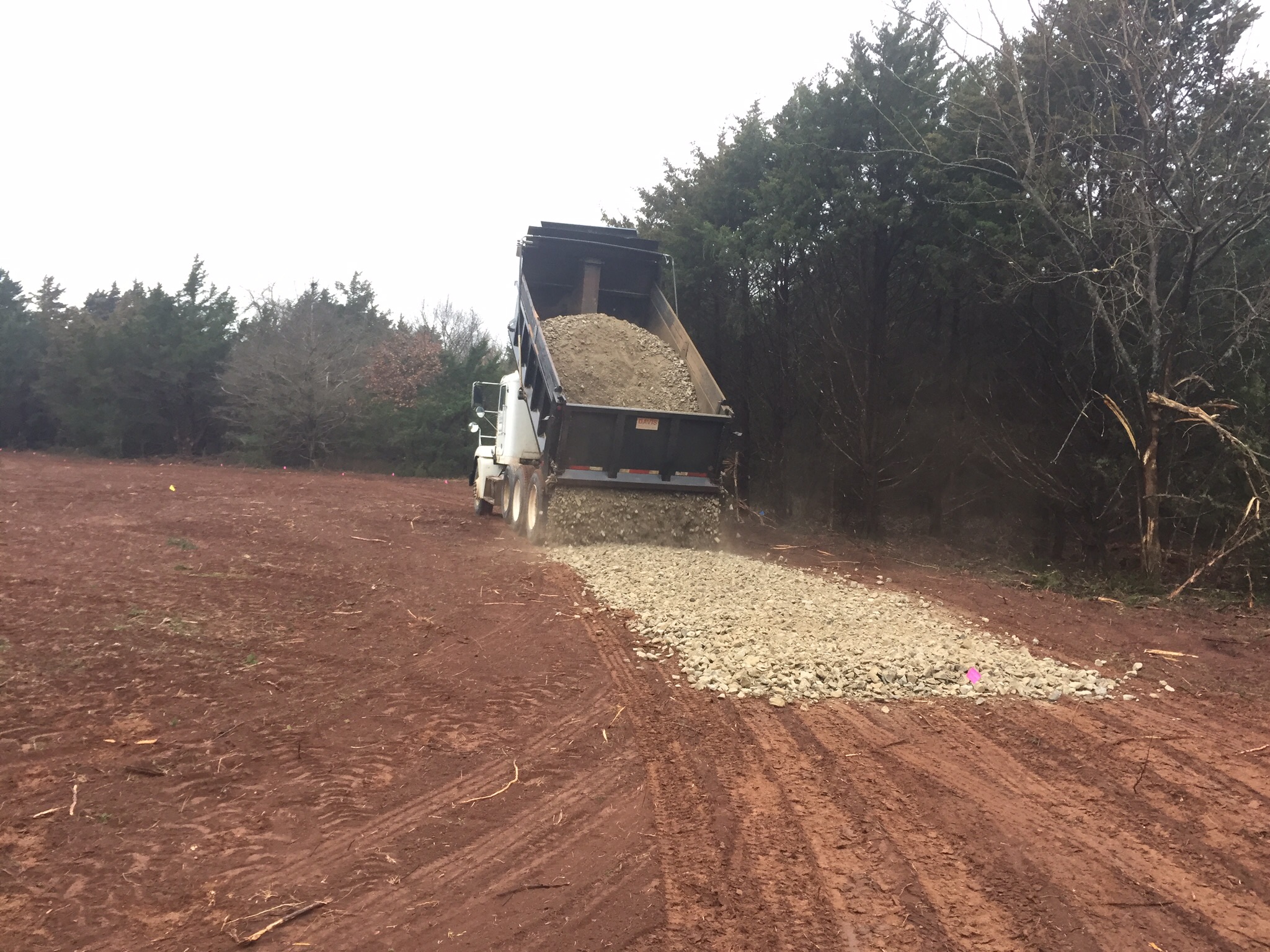

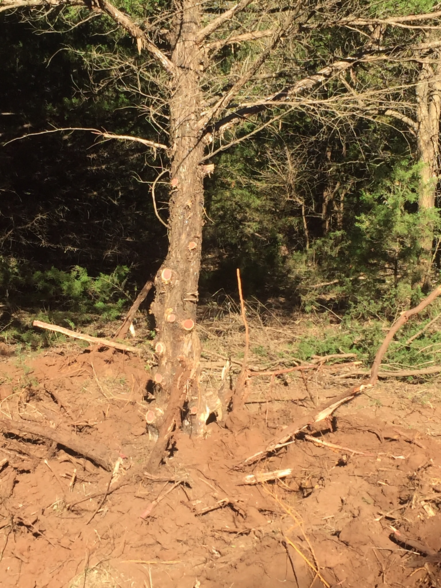

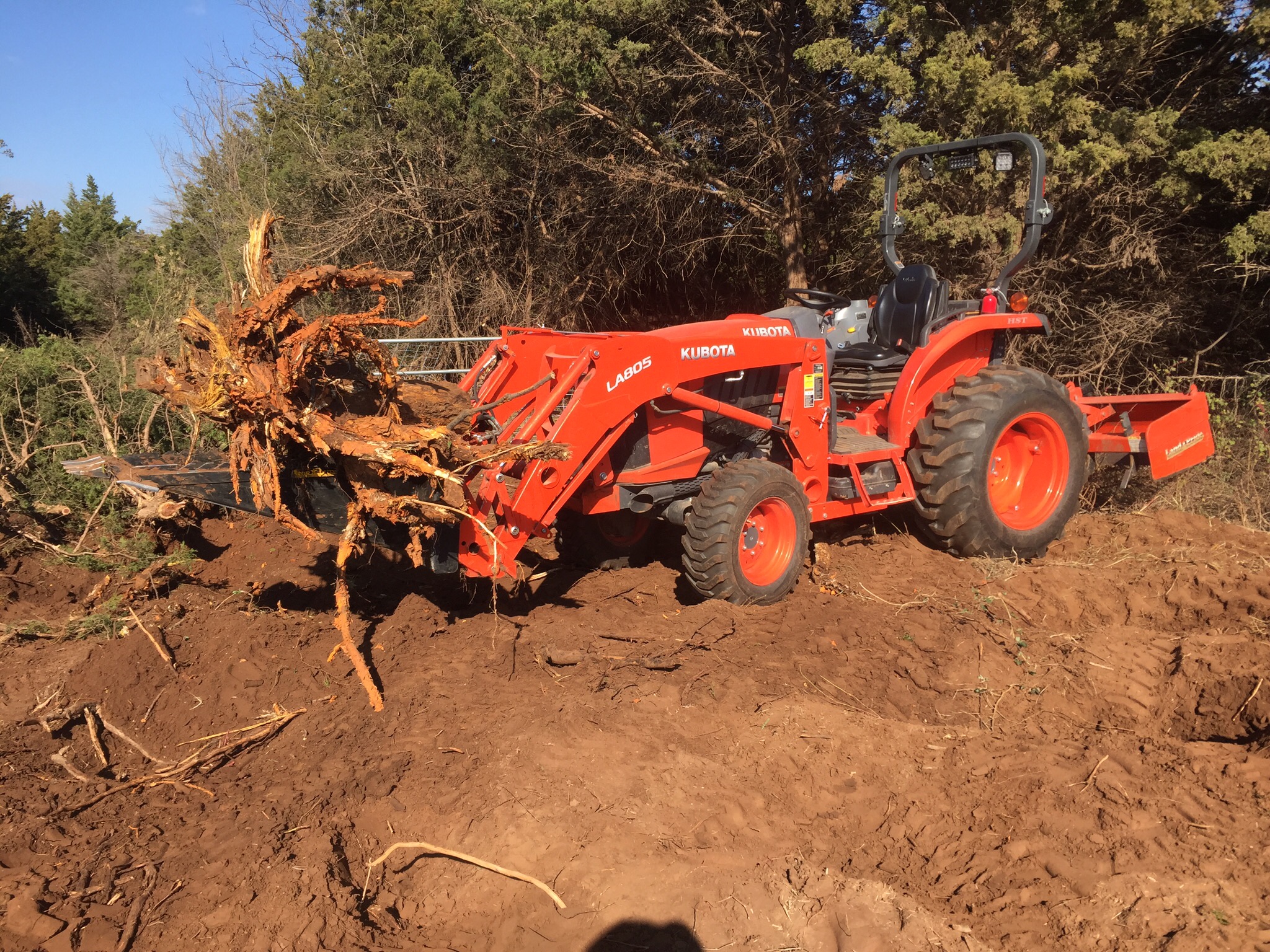

Using a Grand L 3560 with a LA805 front end loader and a worX-duty stump bucket from everything attachments. The bucket is overbuilt for my tractor and seems overbuilt for a 72 hp Cat 262D skid steer just fine so far. First project i used only the Grand L 3560 and cleared out heavy cover of cedar and quite a few bodark trees for a 475 foot drive 16 feet wide cleared and a 300 sq ft pad for a home.
Note the narrow working end of this stump bucket, about 9 inches i think.
Dig your first pass just past the tree, then scoot back a bit and dig in again toward the hole you made, do this several times on both sides of the tree. Then move around if you can to the side and push it over. Large trees will require you to dig all 4 sides. The picture shows a trimmed tree but you can use the stump bucket to knock down the limbs on the trunk as you work your way around. This saves time. No extra limbs to pick up, they are all still attached to the tree. You can dig up just the stump if the tree has been cut off low, just takes more time.
Not saying that a Dozer or excavator would not be faster. But a week of work with the stump bucket for the trees, grapple to stack em, and box blade for the gravel and dirt work and i had the bucket paid for and a nice paycheck leftover.
