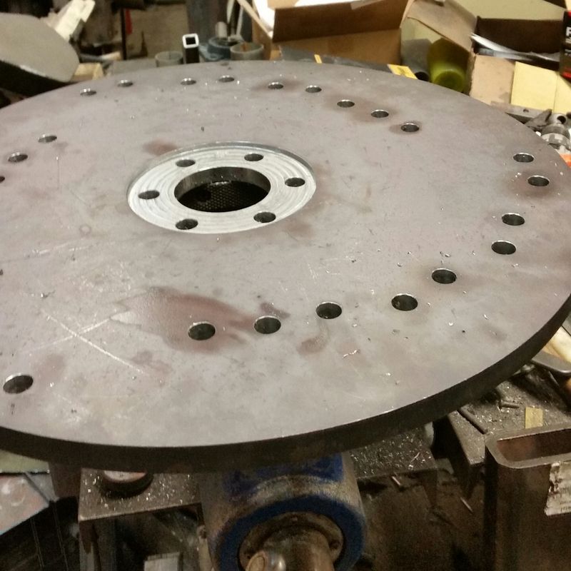

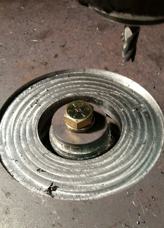

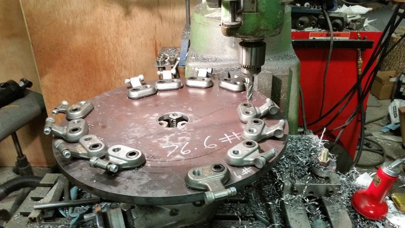

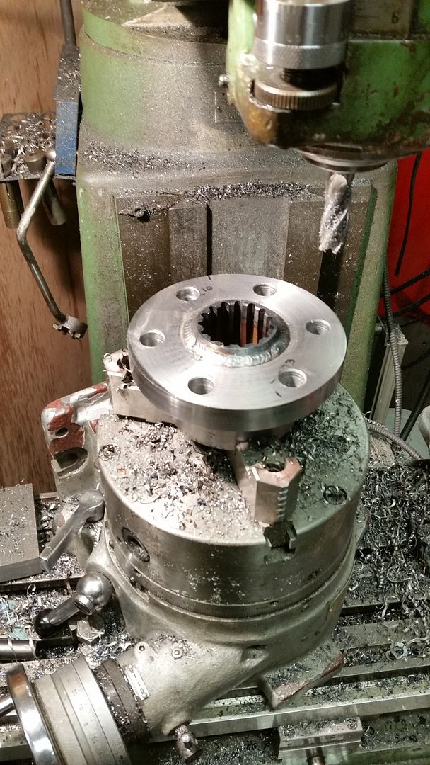

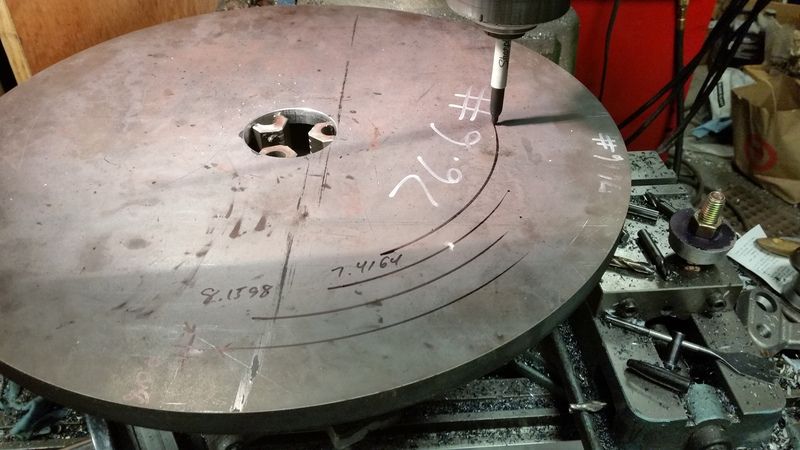

Those of course started as bar stock before being turned.
Frame taking shape
Dry cut saw doing one thing it does really well

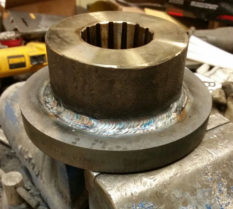

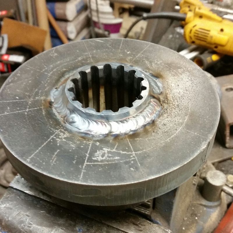

I use a temporary pin to hold things in alignment for welding
This is a different view of the hub flange before being assembled to the splined sleeve
That's pretty much it for build pics.
