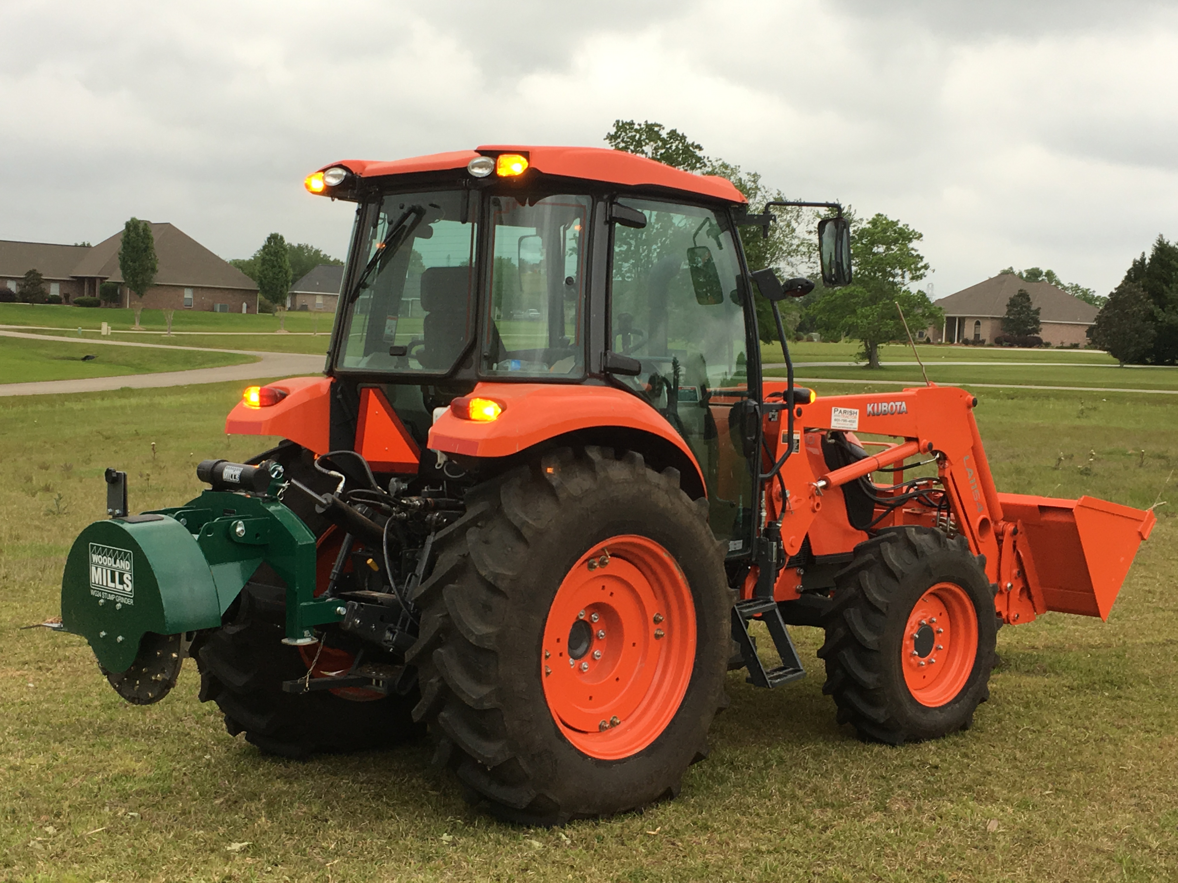

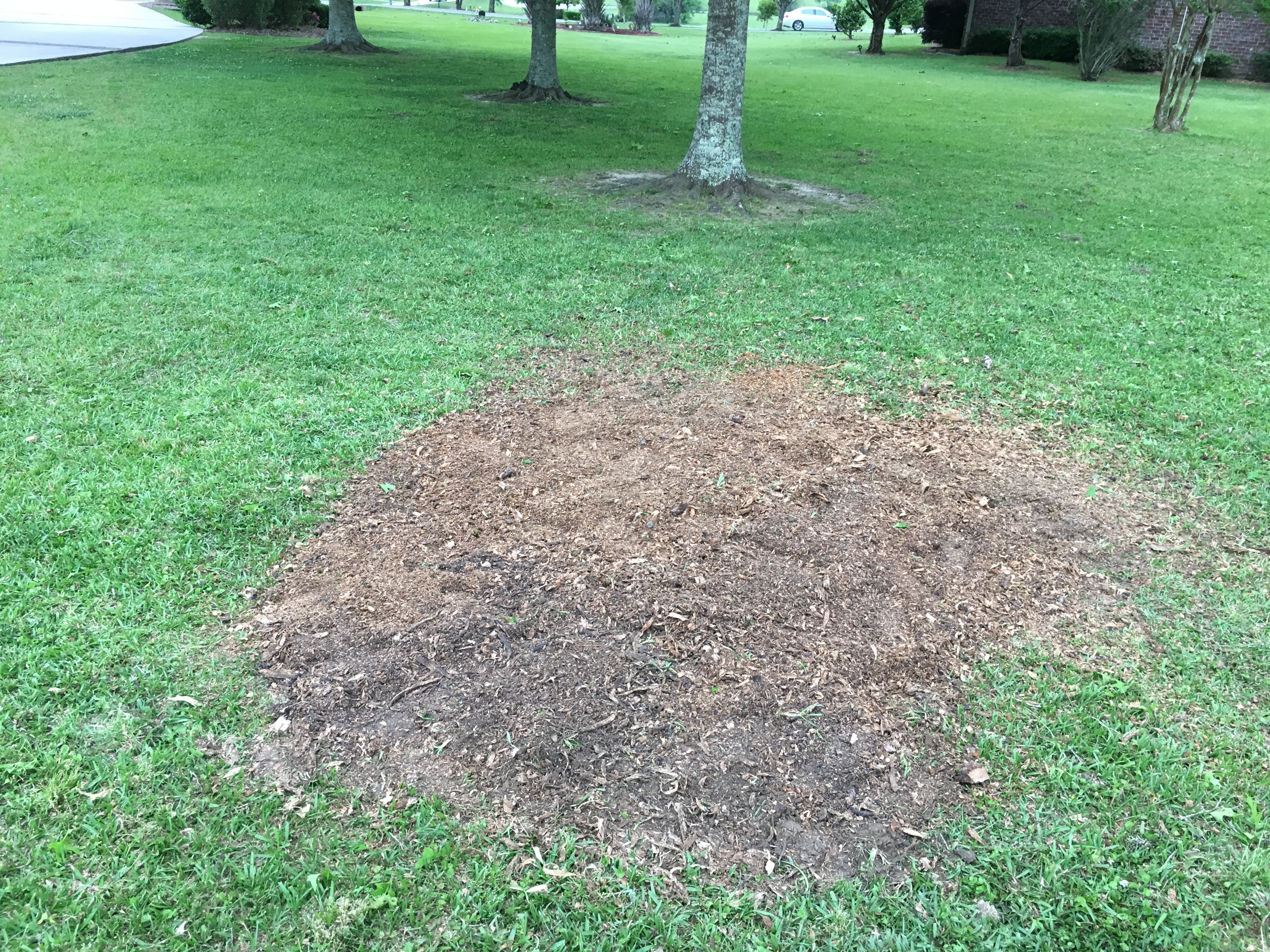

Used the WG24 to clear out some large rock hard oak stumps from a clearing job this week. I also chipped 3 dump trailers full of chips with the WC88 chipper. I am extremely pleased with both machines. The stump grinder is an absolute beast as soon as you get used to it. Not sure how anyone could complain about these units as they are extremely well made and perform great. The driveshaft twisting is either due to cutting the shaft too short (as appears to me from the pictures above) or operator error. If the shaft length is correct and the ship clutch set correctly then taking too large of bites or/and moving too fast. I drove 30 minutes each way to a job this morning and ground 3 large oak stumps and was back home 2 hours from the time I left:) The creep speed, shuttle shift and e-PTO on the M7060 is the cat's meow for this grinder.
