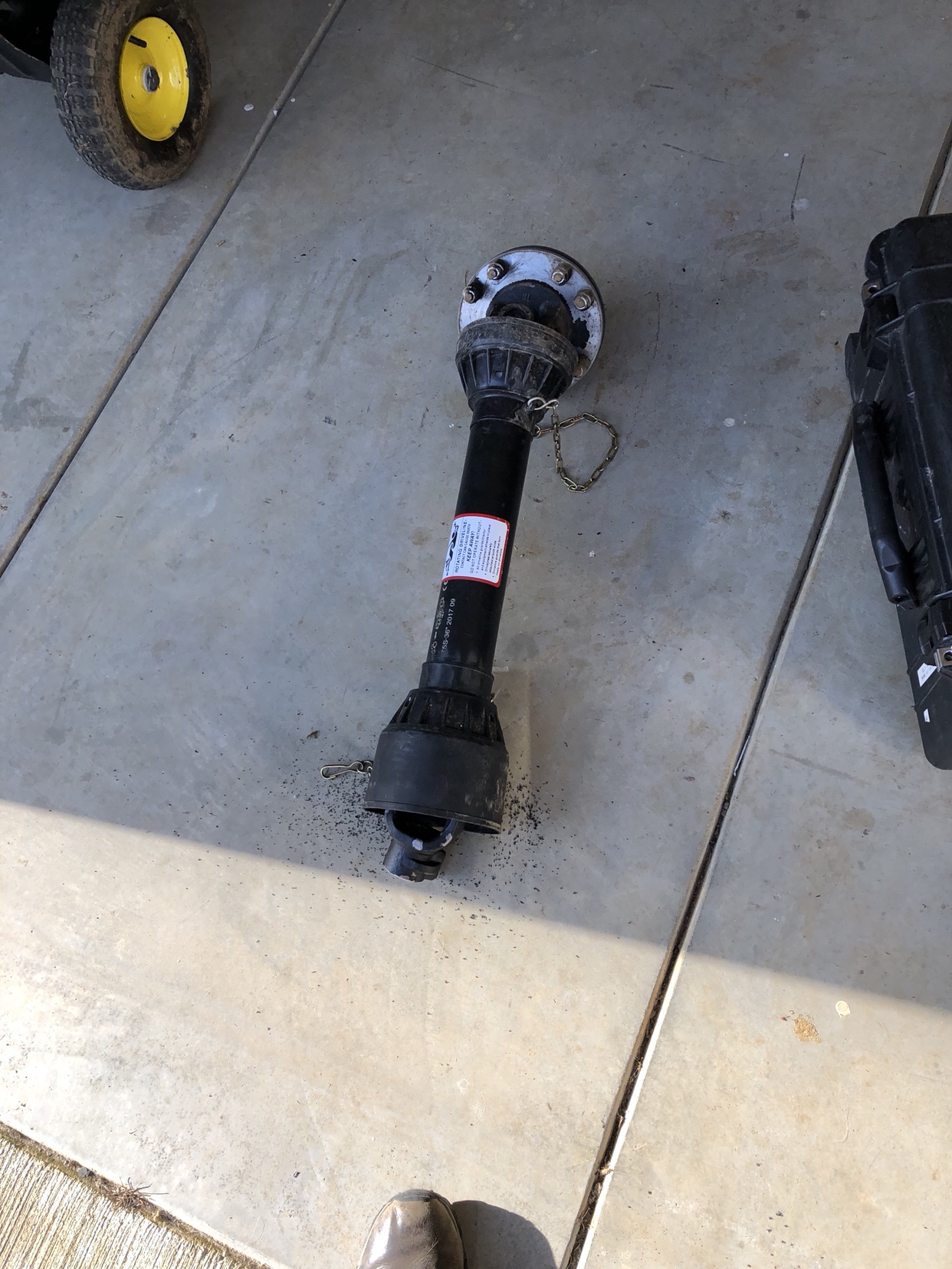

Clutch needs to be set super light on mine or it'll twist a class 7 tube set (I've done it). The class 4 actually went 120 degrees when it failed.
Say what you want about the price of green paint - Nebraska tested my PTO at 59HP, and it's got gobs of torque.
I only cut 6 stumps when I destroyed the class 4 shaft, and a couple of those were dinkers.
   / Stump Grinder Woodland Mills WG24? #202
IMG_0517.JPGback in business $45 later and trips all over town to find parts.

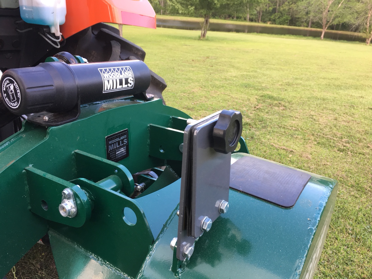

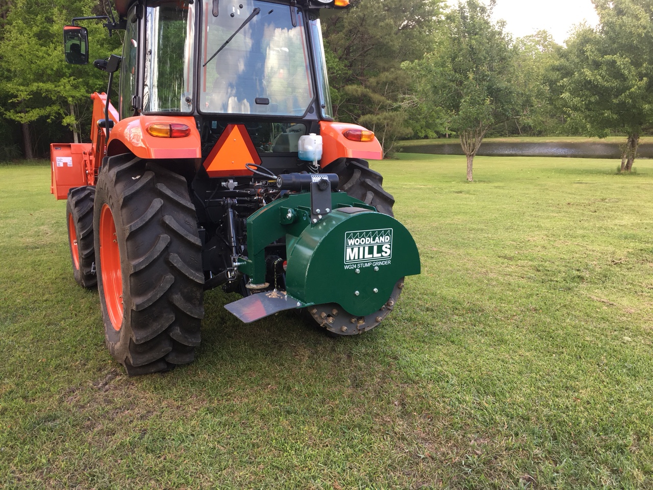

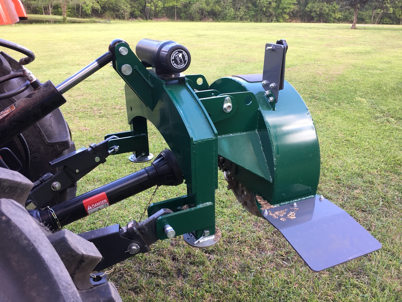

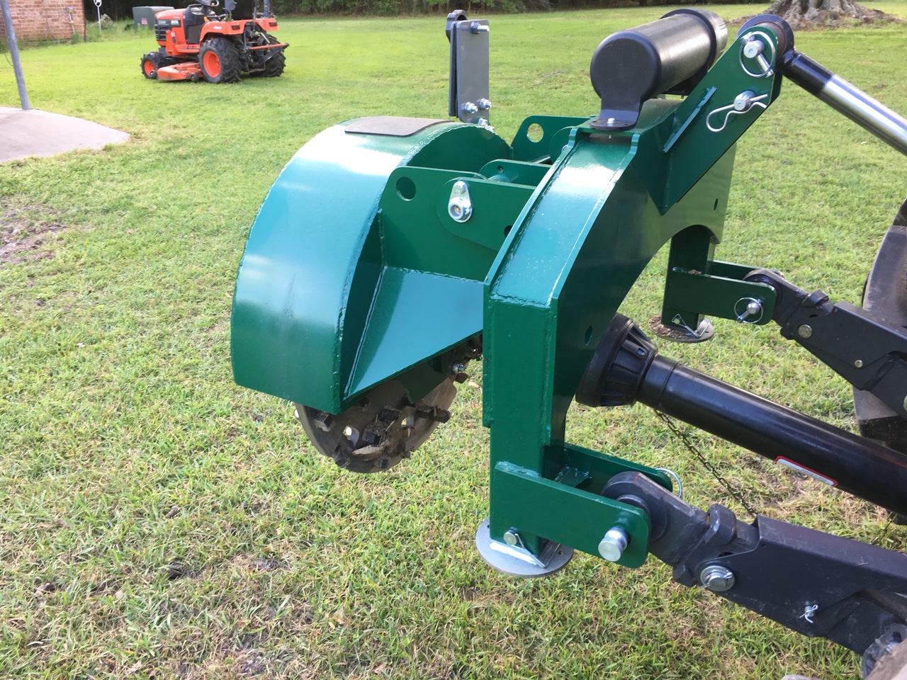

I received my WG24 last week and am thrilled with it thus far. Simple and robust design and it works great. I run it on my M7060 in e-pto as I have far more power than required. My tractor also has creep speed which works great for this grinder. Not sure what size my PTO shaft is but it sure looks and feels very heavy duty. Cutting the shaft length correctly is a big deal with these but this is very easy to do. The grinder works far better than I expected and even large stumps are turned to mulch in minutes. I would recommend this type grinder of the hydraulic swing type.
