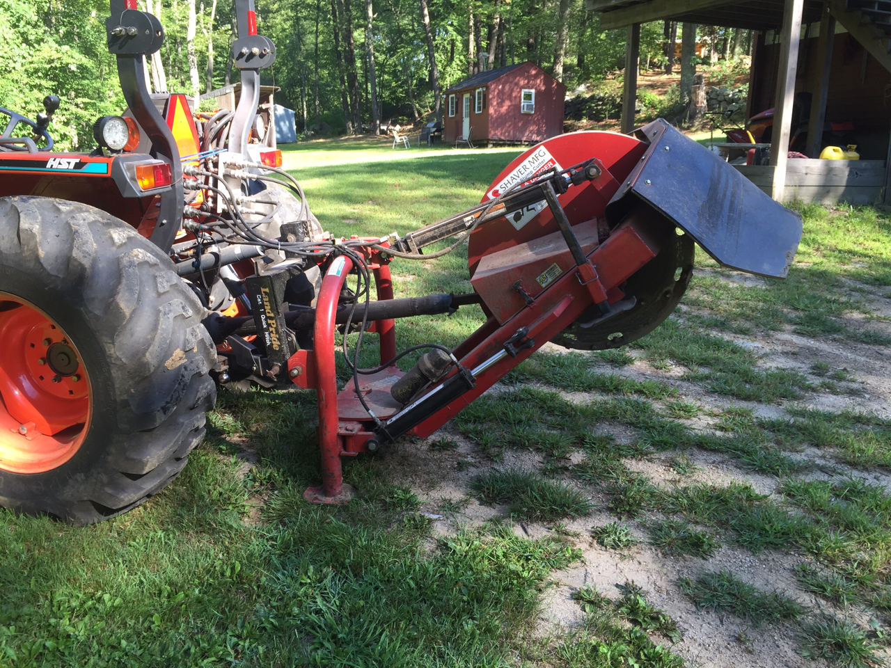

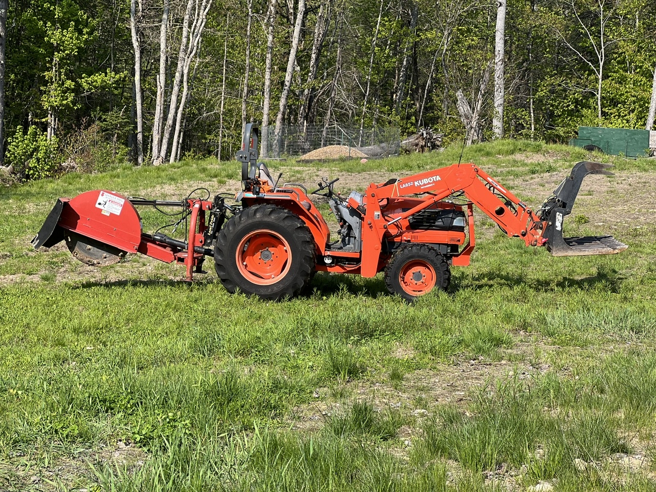

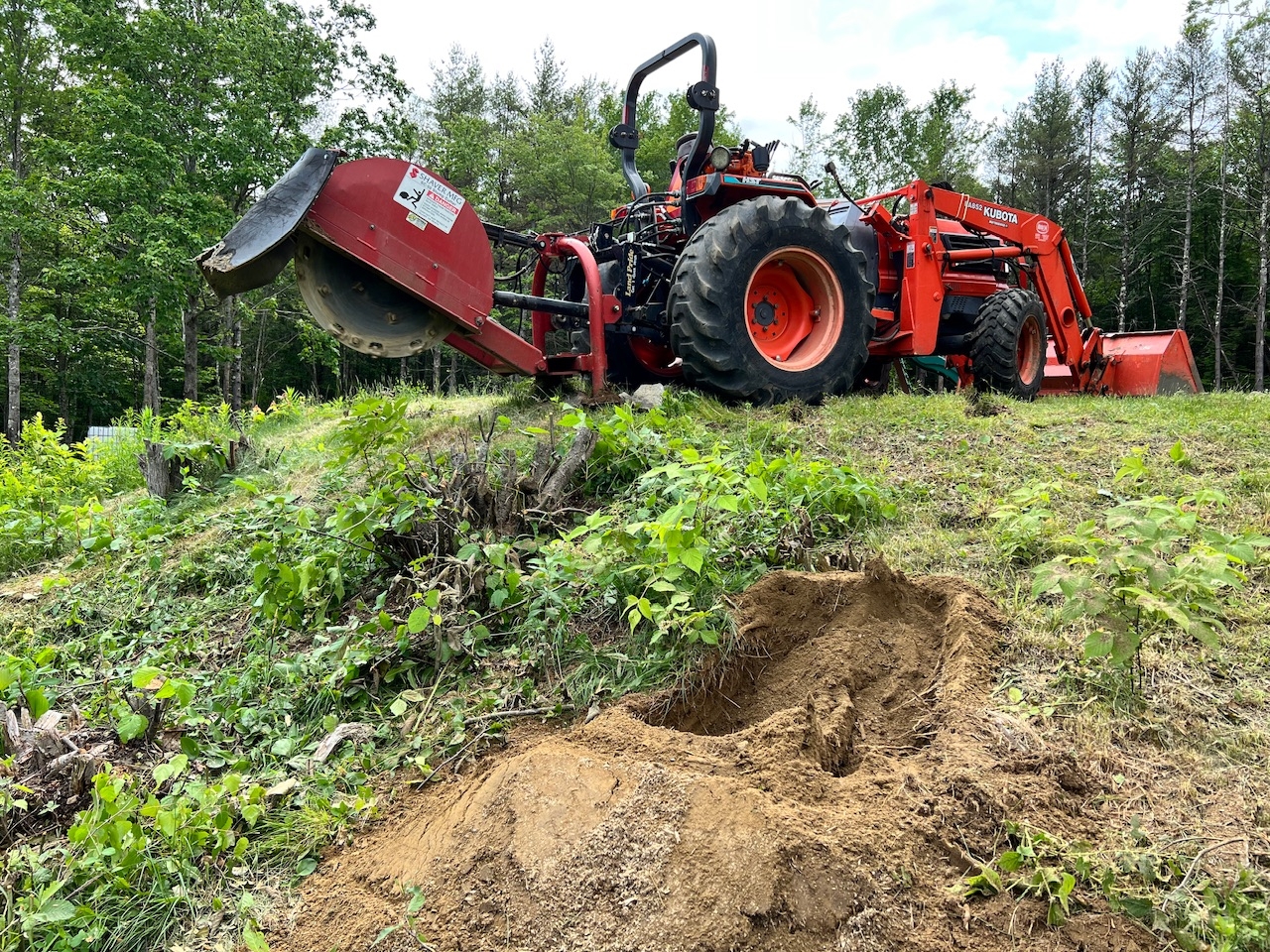

I have the Shaver SC50. It goes up/down and side to side.
I’ve been extremely happy with it and have made a fair bit of money using it on random jobs when it’s needed.
I think the cheap Woodland Mills stumpgrinder can do a good enough job for the average homeowner considering how cheap it is, and value wise, probably hard to beat. That being said, I personally wouldn’t buy one for my own uses now that I’ve had the Shaver for many years.
The terrain you will use it on may contribute significantly to your decision. However, with that much power and the fact that you have rear hydraulics, I’d highly recommend this style in various manufacturers.
