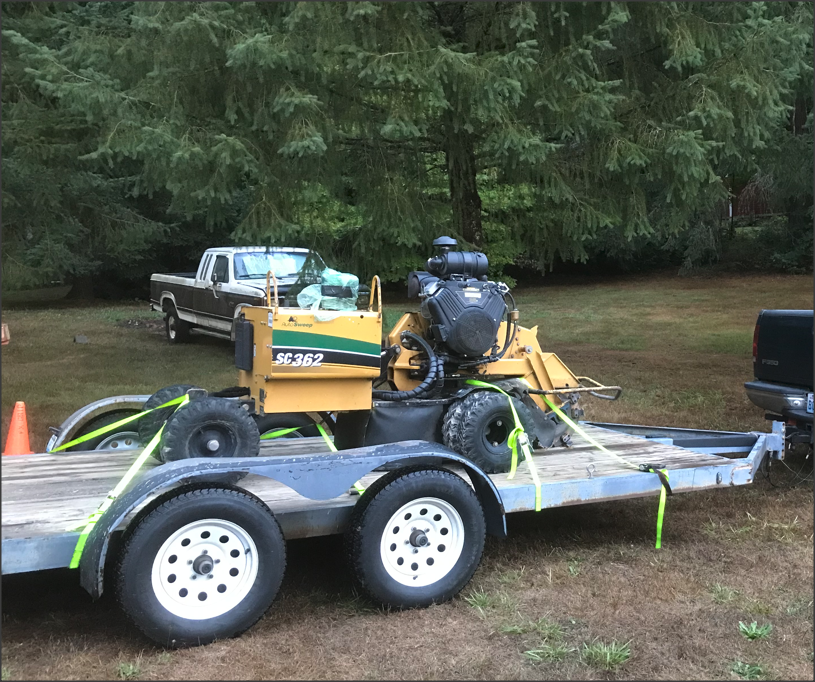

Same here, I bought used Vermeer SC362 last year.
Good machine for a homeowner, but I wish it had a Diesel engine...
What kind of cutter teeth are on the wheel? I presume Green Teeth, correct? If they are, they are indexable to 3 different cutting positions. What I run and Green Manufacturing is a local company for me and I can buy direct from them as well. About 20 miles from the farm.
   / Stump removal .. how deep? Or all? #29
It came with badly worn out OEM Yellow Jacket cutter teeth set, which I replaced with Green Teeth set last fall.
Since the machine came with a spare set of new OEM teeth pockets & Yellow Jacket teeth (and a wheel), I will install Yellow Jackets after the Green Teeth set has been "indexed" & worn out, just to get a fair comparison.
