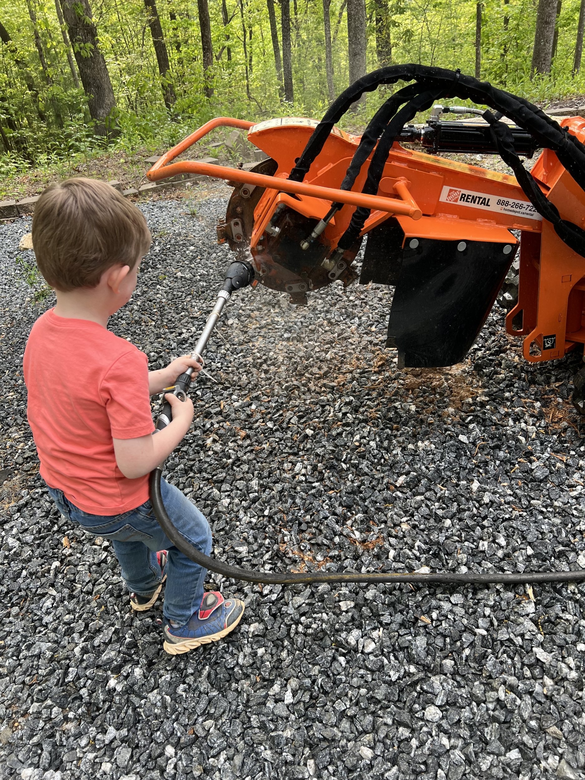

Update.. rented a stump grinder, used the tractor and dug down a foot or so lower than the current ground level, then ground it.. got this picture of my son helping rinse the grinder before going back to HD..
I’ll likely NEVER rent from them again..
$1k deposit.. and the have a $1500 deposit for mini-ex..
It did work well..
Wow, that seems like a pretty steep deposit. I am spoiled to have a Rentals Unlimited a few miles down the road. They collect my credit card info prior to the rental, but only charge the actual end rental amount on it.
Glad you got your stumps handled.

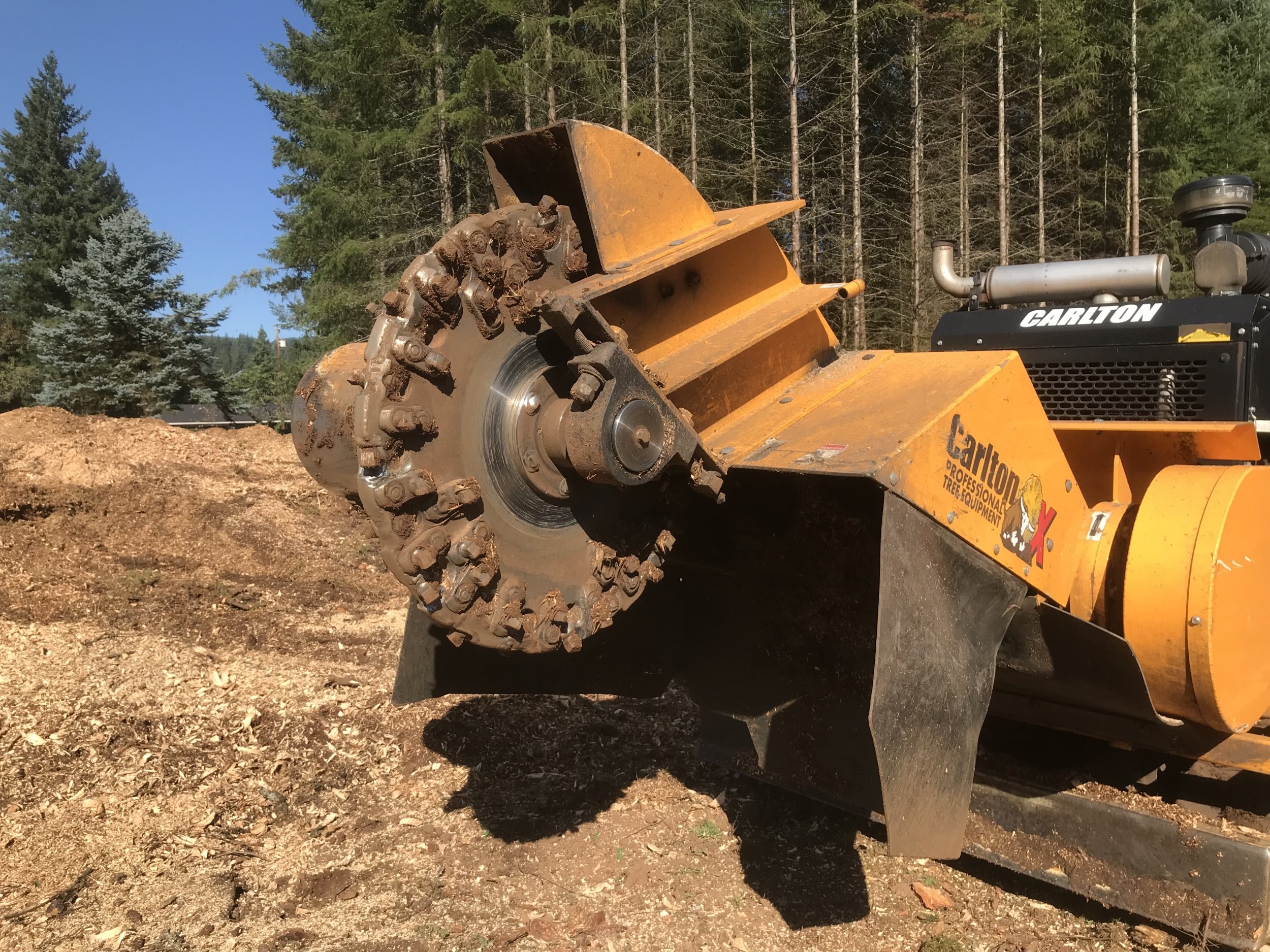

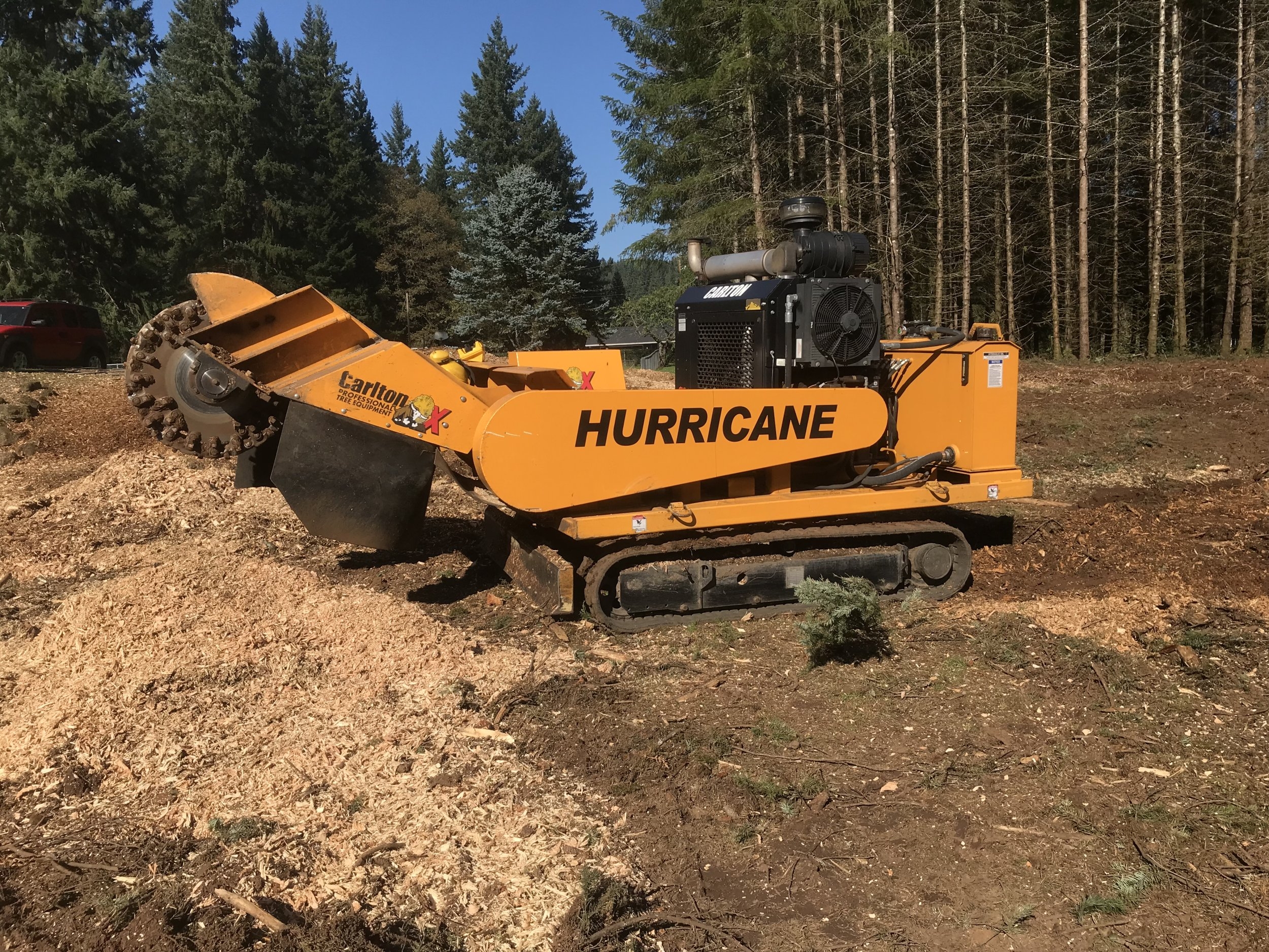

I own my own stump grinder and I grind all of them. Typically, I grind about 12-15" below grade and forget about them.

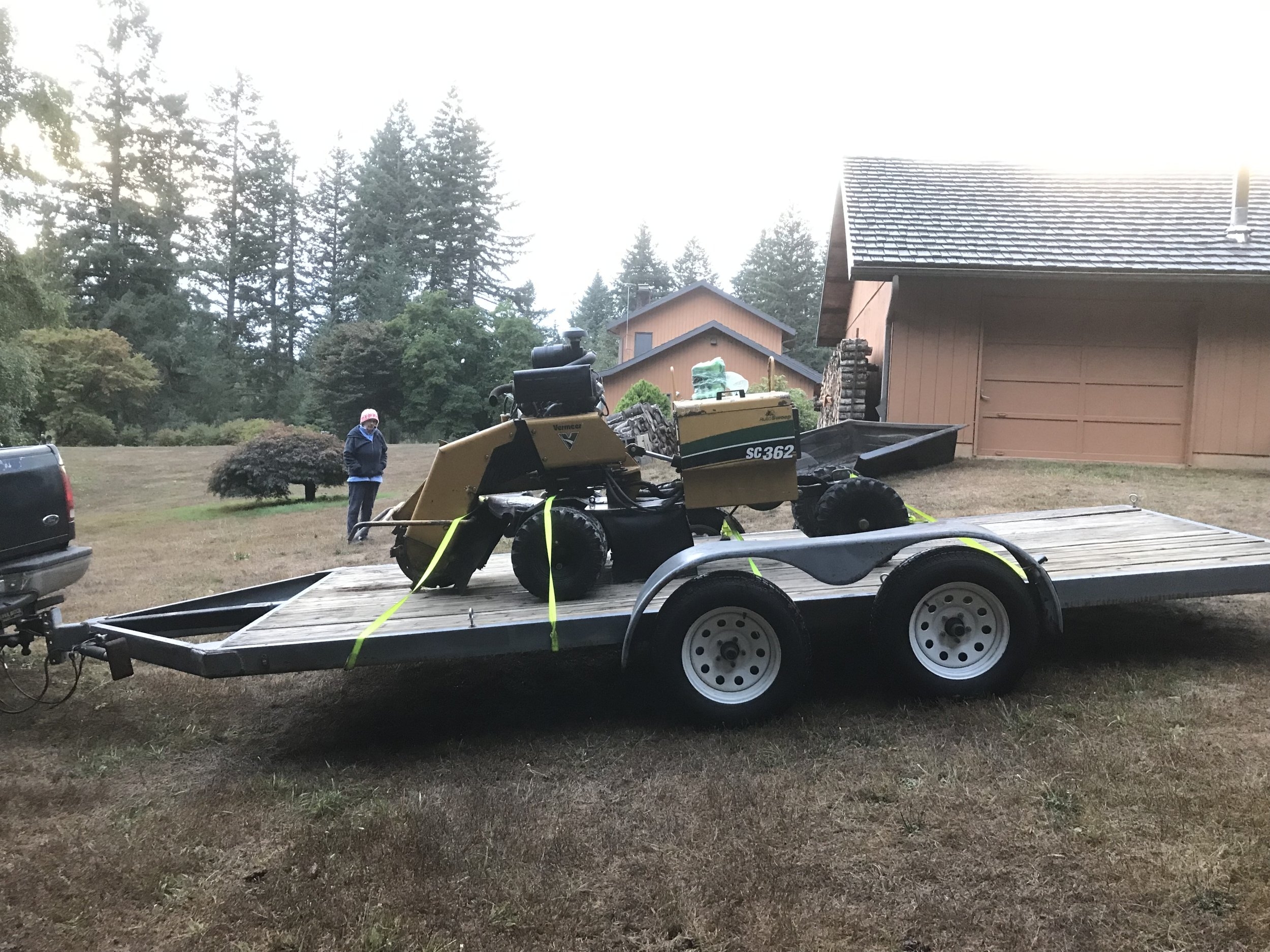

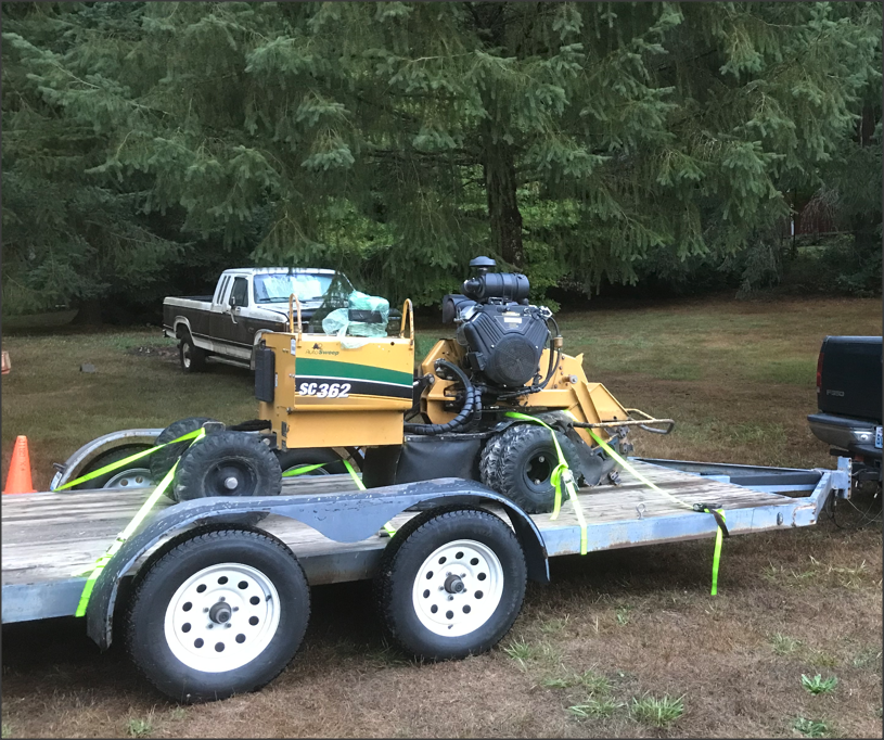

Same here, I bought used Vermeer SC362 last year.
Good machine for a homeowner, but I wish it had a Diesel engine...

What kind of cutter teeth are on the wheel? I presume Green Teeth, correct? If they are, they are indexable to 3 different cutting positions. What I run and Green Manufacturing is a local company for me and I can buy direct from them as well. About 20 miles from the farm.

It came with badly worn out OEM Yellow Jacket cutter teeth set, which I replaced with Green Teeth set last fall.
Since the machine came with a spare set of new OEM teeth pockets & Yellow Jacket teeth (and a wheel), I will install Yellow Jackets after the Green Teeth set has been "indexed" & worn out, just to get a fair comparison.
