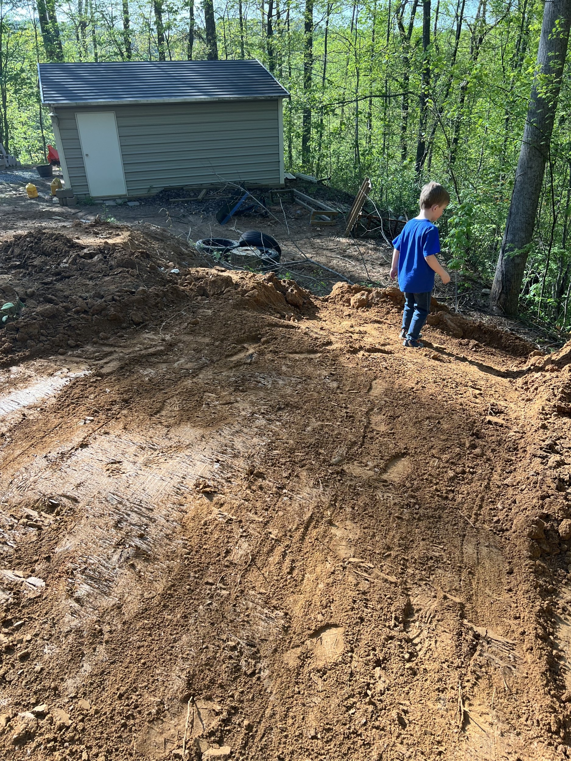

I’m working on regrading a bank and removing some stumps.
They are all 18-26 inch diameter.
Plans are one of the following.
1. Rent a mini ex and dig the entire stump and use the tractor and chain to pull it out.
2. Rent a mini ex and dig it deep, cut it and pull out whatever I can.
3. Hire/rent a stump grinder and grind it as deep as possible.
What are y’all’s thoughts?
The mini ex would be a 5k or so with an 18 inch bucket.

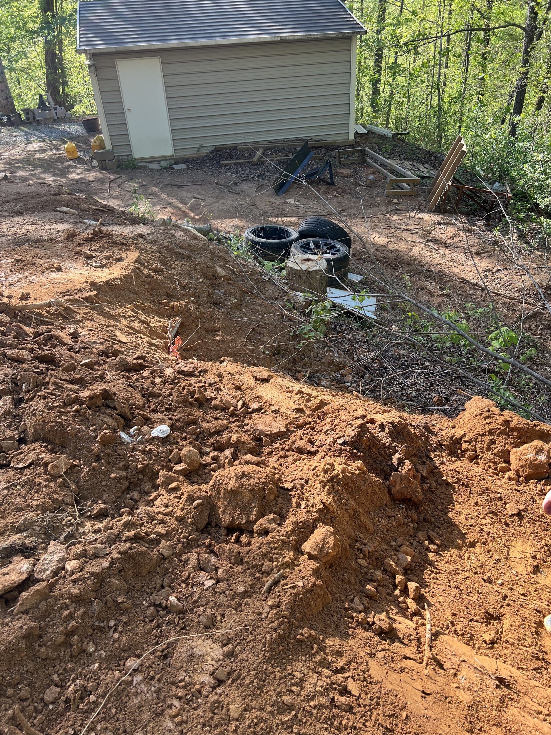

I’m actually going to be adding dirt and ramping this..

I should have also said that there is 1 concern… the water line to the well crosses right before the stump near the tires…

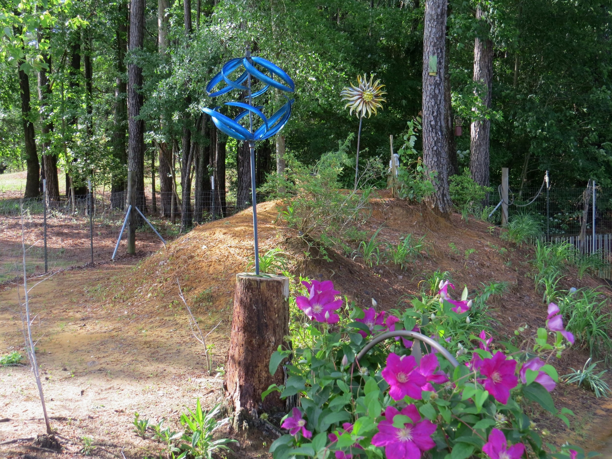

Out on my land, I dig out the stumps and get rid of them. It takes years to rot away, and I don't want them in my way when bush hogging.
Near my house, I cut them kind of long so the truck is sticking up a couple of feet. Then I drill a hole in the middle of it and place a Wind Spinner.

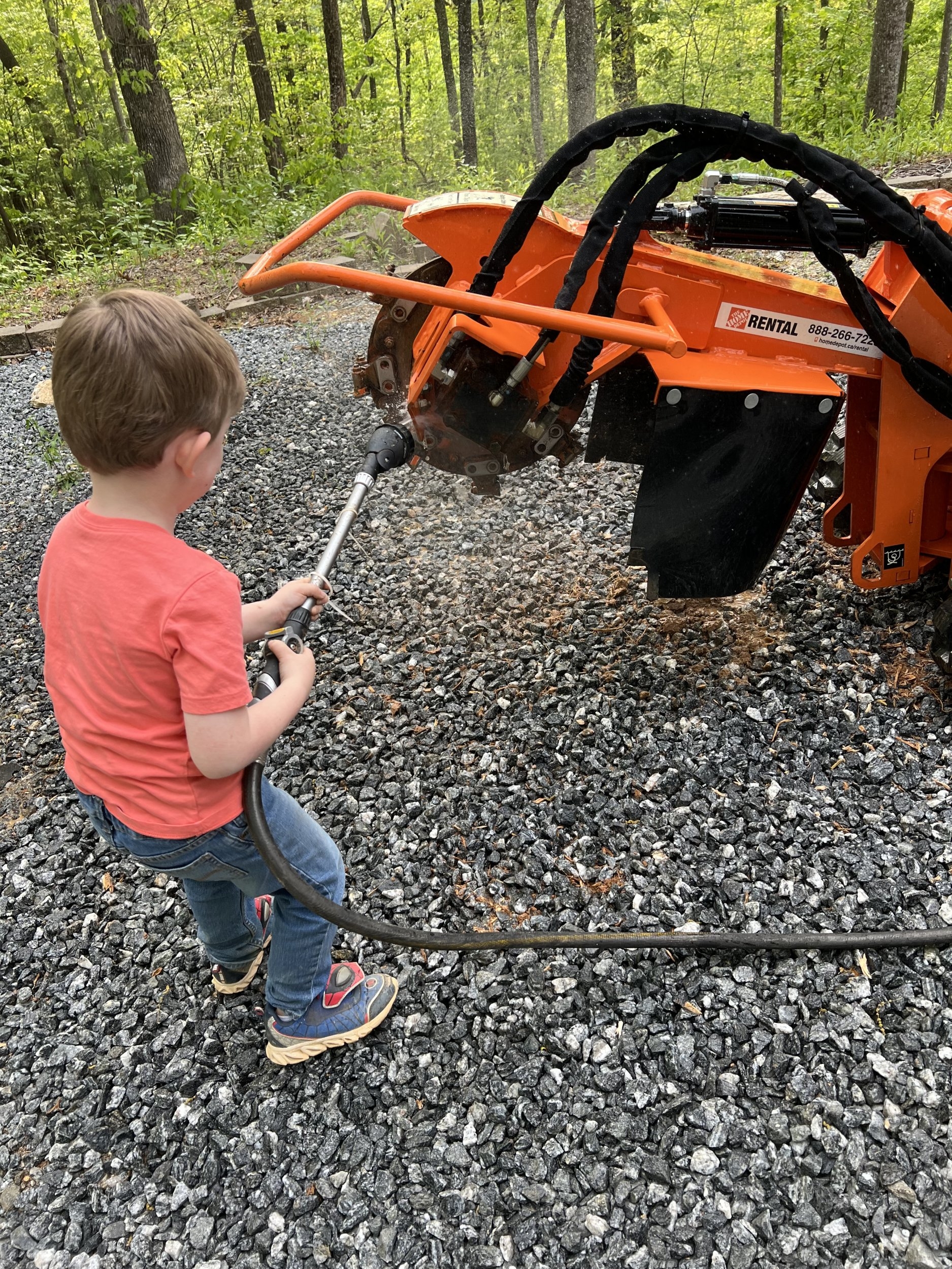

Update.. rented a stump grinder, used the tractor and dug down a foot or so lower than the current ground level, then ground it.. got this picture of my son helping rinse the grinder before going back to HD..
I’ll likely NEVER rent from them again..
$1k deposit.. and the have a $1500 deposit for mini-ex..
It did work well..
