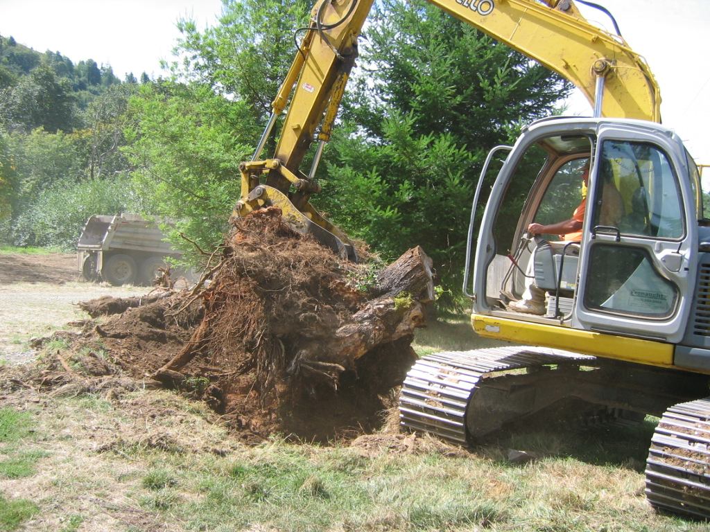

Like this? It took him about 3 hours to remove 6 large (over 40") stumps. I jest a bit about stump size but I have plenty of 20's that need to go....
This was done for us for free, but I know the next time he comes up it is going to cost. Lets say $125 per hour for an 8 hour day... 1K for his services and not all my stumps gone. Would love to just have a grinder...
Carl

Dear Carl,
Has anyone tried the hydraulic screw stump buster/pullers?
Sometimes renting or hiring out is the sensible solution.
We rented a commercial chipper over Christmas and in less than two hours reduced a 50' long, 8' high, 12' wide pile of trimmings to next to nothing. It ate 6" diameter logs with barely a slow down. Mind you, I was eyeing it for use on the PT, as it was hydraulically driven. However, the darn thing was so heavy that it nearly tipped the PT twice while trying to move it up a slope on muddy ground. Let's just say that it went to h*** in a handbasket pretty quickly, before I got out the dually and chains and towed everyone to safety. (PT under power, pushing, truck pulling.) The chipper had a hitch clamp that allowed it to apply a lot of torque to the PT at a very low tilt.
In my book, stump pulling/grinding about as gnarly a job as they get. Stumps are where brute force and mass can really win the day. Dozer, backhoe, etc. Even a moderate sized backhoe can snap most of the roots first, and then wrench the stump out.
Having said that, there are a bunch of old tricks out there on how to use a winch, a lever, and chain to remove stumps- but it is still tough, dangerous work. Stump pulling kills a bunch of farmers every year who pull too high, or make the mistake of adjusting their 3 point hitch while pulling.
Have you looked at surplus logging equipment? Then there is always ebay... I have seen some nice army surplus tow trucks on ebay that would get the job done- if you can drive to your stumps.
All the best,
Peter

Carl,
If you have trees to remove, you should just let the track hoe push the tree over, and the stumps come out with the trees, however, if you already have the stumps. Dozer or track hoe is the way to go.
If you have the time, and a good stump grinder with sharp teeth, it is almost fun to be doing such work. There is a learning curve in there somewhere, and the more you grind, the getter you get .
If the teeth are replaceable on PT's stump grinder, you can keep them sharpened, or replace them, or have them sharpened by a professional. You can also change the style of the teeth you have. They make a cup style that you just rotate up to 4 times, before it needs sharpened.
