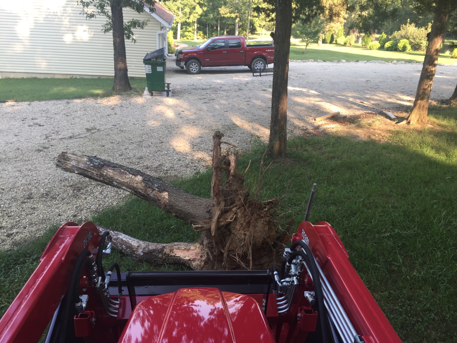

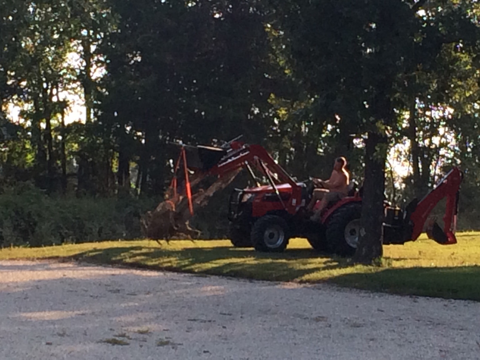

1st stump down and many many more to go.

dickfoster.....I am surprised that your backhoe is struggling with stump removal. I have spent the last few weeks digging stumps with my backhoe with great success and I believe our tractors are of similar size. From my experience I believe the best way to do it is to keep moving further away from the stump until you can rip through the roots with the bucket. I always end up with a very large hole that I have to fill....but at least the stump is out. On average the large 30 inch diameter stumps take me about 2 hours until they are spinning free in the hole.
The stumps that I am currently removing cannot be grinded as I plan on pouring a concrete slab over top.

I took me and 1 hour 15 min. I think I can get my time down considerable as I get used to the backhoe controls. I also plan on having my son drive me around the stump to cut down on the time to get it moved around. I also noticed that that the "big hole" method works quite well. I will start wide and work my way into the stump from now on.
