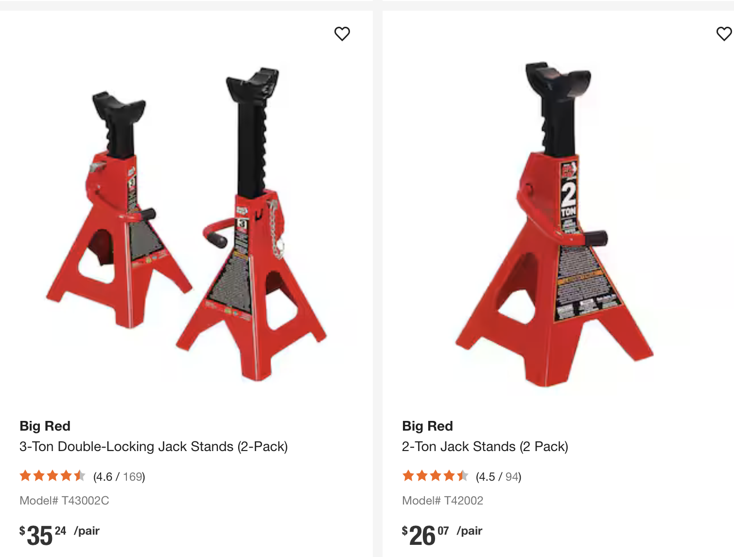

You're welcome. I bet it is nothing, but lets find out exactly.
Now Be Safe. No fair turning the tractor over... or working on it with unsupported parts suspended in midair. And I hope you have somewhere flat and level.
A pair of jack stands for usine under the axle is $30 at HomeDepot, Walmart, etc....although some use a couple of sturdy blocks of wood & that is fine for most tractors - and certainly for a subcompact.
AND you will want a "front end loader lift arm cylinder safety prop" if yours does not already have one built into it as part of the loader. Some do and some don't, but all should.
Here is a photo; frankly the online price seems high but I include it to show you what it is.
You end up using that safety prop more than you think. It makes opening the hood to check and clean engine filters and such so much easier.
It is common to have a prop on only one cylinder. The prop can be a simple piece of angle iron or channel iron cut to length and a couple of straps to hold it to the extended cylinder rod. I'd say to go with something thicker than 1/8" wall iron just to be sure. If lighter, use one on both lift arm cylinders. Even a piece of strurdy lumber would be better than nothing. It does need to be strapped into place against the cylinder rod or risks popping free.
To use, raise loader to about 3/4 full height, insert prop, turn motor off, lightly feather the control to allow the loader to come down slowly until it traps the prop. Then examine what you have with a critical eye. Yes, one end of the prop often rests on the end of the cylinder...that's OK, just make it miss the seal.
Now you can examine that front end.
