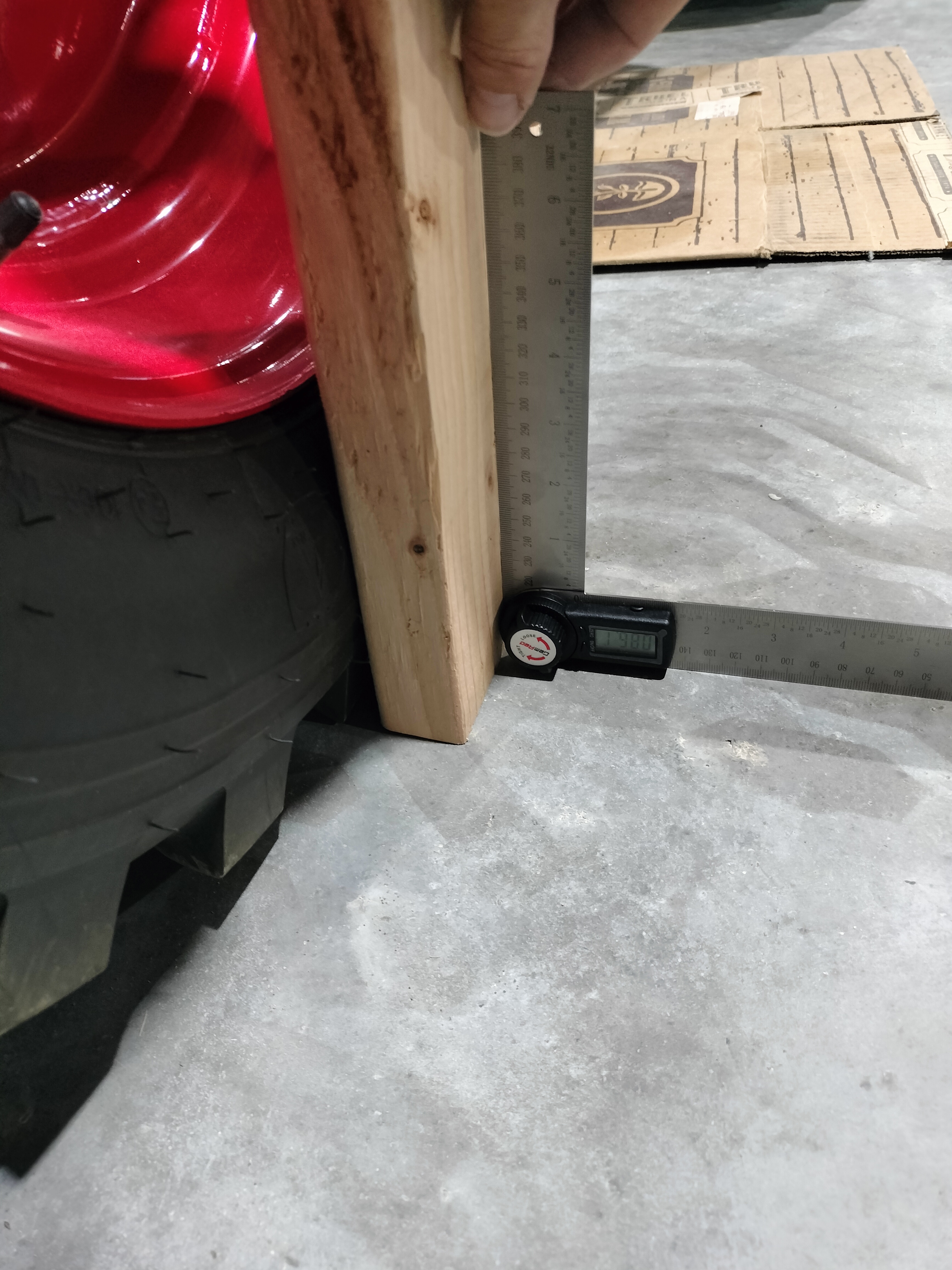

You can measure the actual camber like this. Mine has about 3 degrees.
