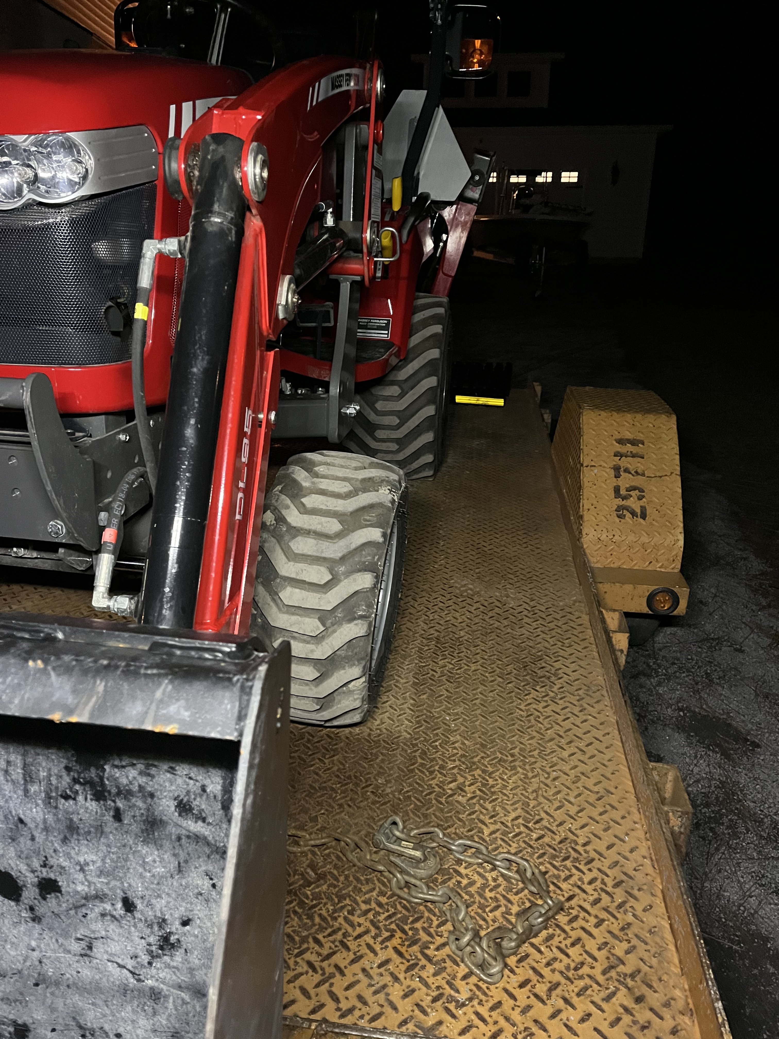

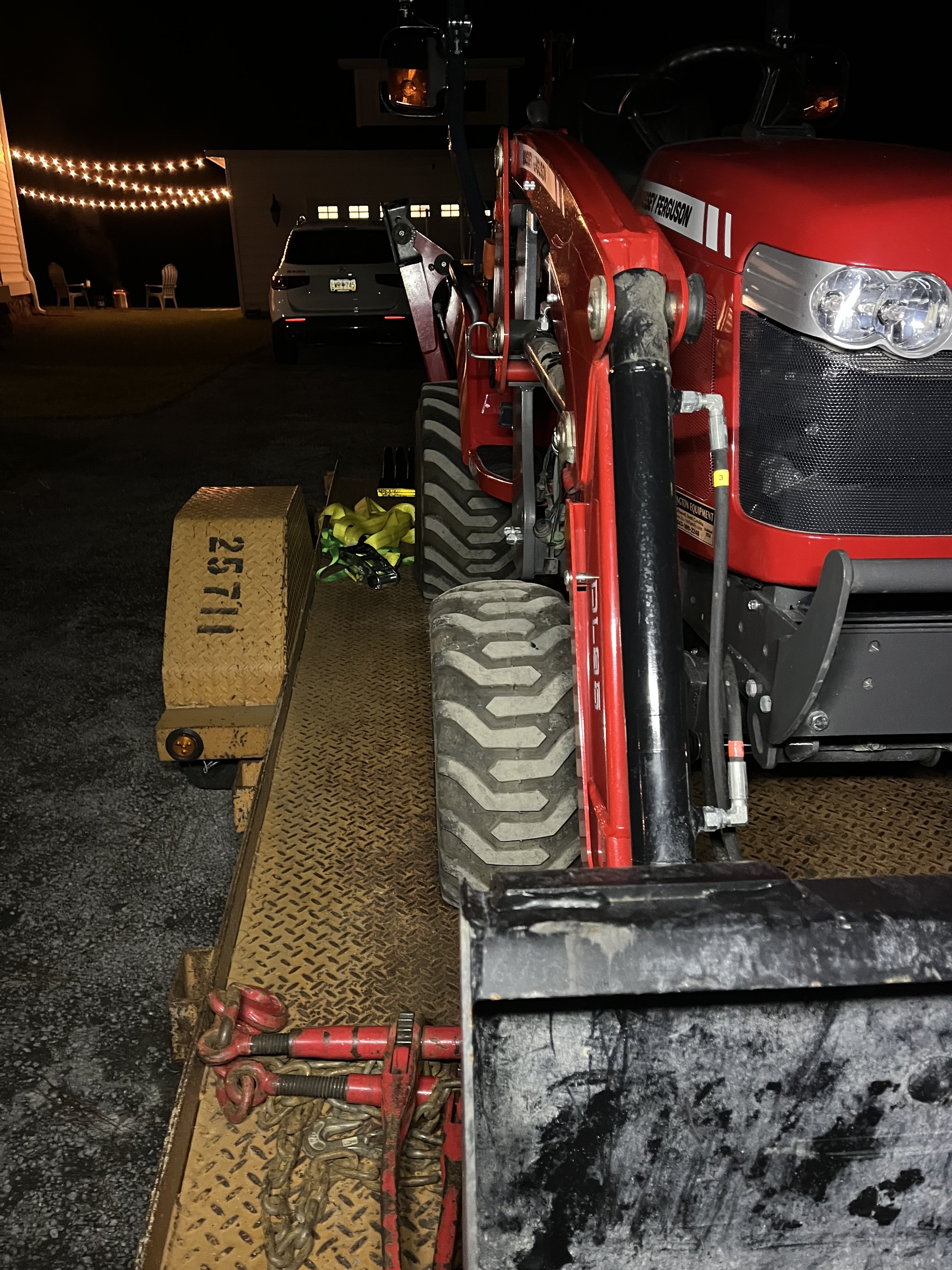

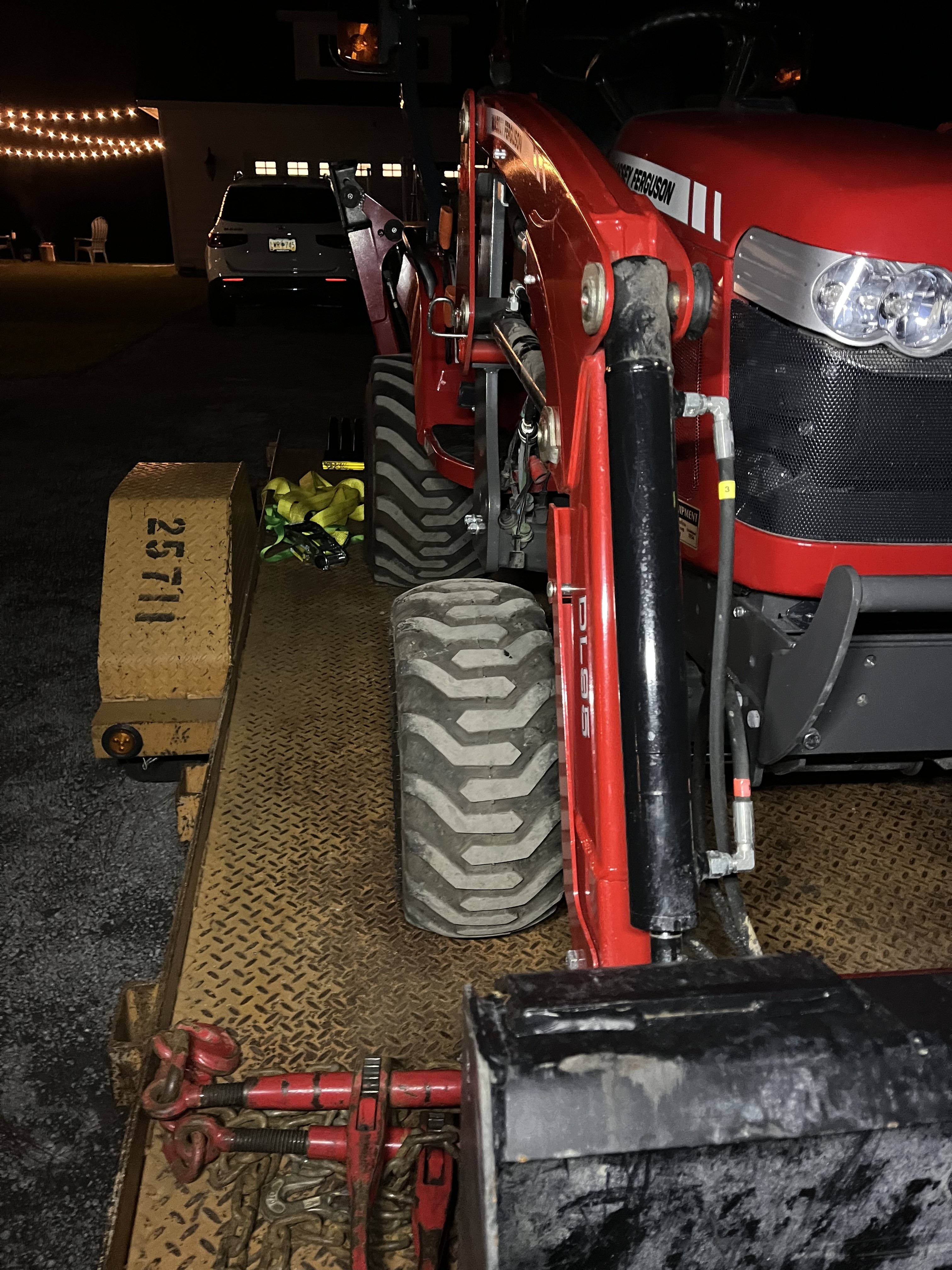

Hey there, I want to thank y’all for the advice. I pulled the trigger and went ahead and purchased the 2018 gc 1720 tlb. Quick question… as the dealer was putting the tractor on the trailer I noticed the left front tire was kinda kicked out and not on the same angle of the right front. When I brought it to their attention they expressed it was normal and not a concern. Could y’all please look at pics of the right front vs the left front and let me know if this something I should be concerned about. Any advice would be greatly appreciated thank you.

When you get it home, raise the bucket and take pictures from the front so we can see both wheels in relationship to each other. I couldn't discern anything from your pics.
Probably is nothing, it seems most(all?) tractors have some positive camber on the front tires. Pickup the front tires off the ground with the loader, and give them a shake in all directions, see if there's any play at all(should be none), give them a spin, maybe the one wheel did get a bit bent somehow? You probably would've noticed on the test drive. The axles are so short on our tractors that I don't think they bend very often?
Also with the tractor on the ground and off, lay a wrench on every nut and bolt you can. The wheels, and loader and hoe subframes all need a check every couple dozen hours for the first while, my tractor needed the tie rod ends tightened at the wheel at around 100 hrs. In short, if you feel something a bit loose or clunking or creaking you need to look things over. As you use the loader and BH you'll probably get some play in the pins, but keeping them greased every 10hrs should keep them happy for a long time.
Do you have a user manual? If not download one, it will give some tips for playing safe, and if you don't know, the loader and BH can drop with the tractor off just by someone moving the sticks. Keep your loader low with a full bucket, and find some threads here on safety tips. Go slow, try to go straight up and down slopes not across, and keep the rops up and your belt on, and you will figure it out.

Yes, I see what you are seeing and have no idea why. In a perfect world both wheels would be the same - but it may mean nothing or maybe just how it is sitting. We need more info, go ahead and follow the good advice from Indyfan.
Use down pressure on the bucket to lift the front wheels off the ground.
Then support the front axle in a couple of places with the wheels off the ground so that you can then lift the bucket back up leaving the wheels off the ground. There should be a saftey on one of the bucket lift arm cylinders as well - ALWAYS use that safety, or something that does the same function to block the bucket up too.
Never trust hydraulics not to fall. Not all FEL buckets will stay up reliabily. Most do, but failure is immediate. And many will slowly leak down to sneak up on you while you are under there. You do NOT want to depend on the hydraulics to hold anything up while for any length of time while working on it.
Then as Indy says, after blocking things safely you can shake, photo, tighten, and check. Grab a square and see what you find. You may want to swap front wheels side to side and see if that changes things - in fact that's a good idea.
