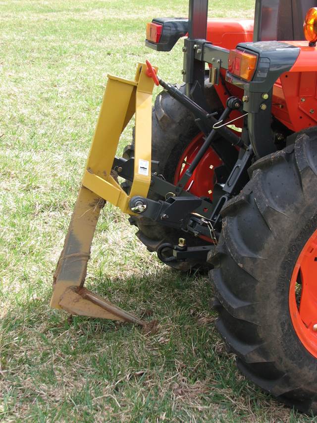

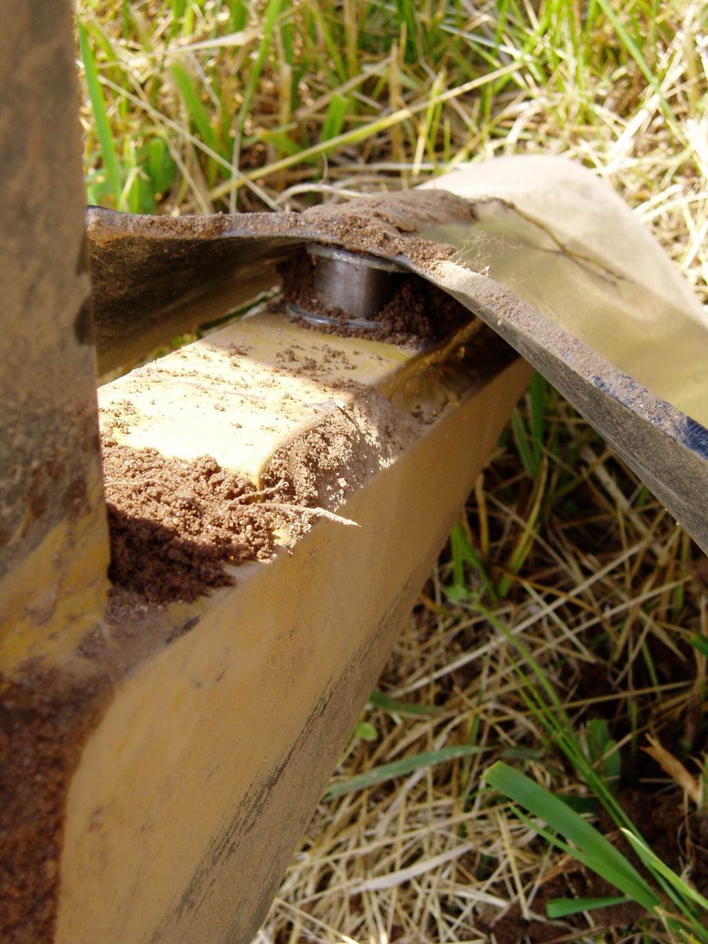

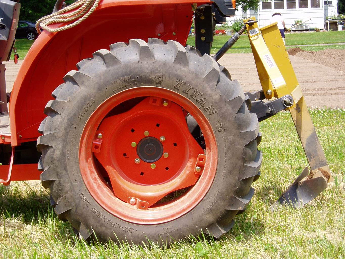

I have a Farm Force (TSC for Tarter?) yellow subsoiler that I also use with a middle buster shovel. Unfortunately, the point angle of the subsoiler (about 25 degrees) is not very good for the middle buster, which wants to be set steeper. My workaround has been to put a bushing between the middle buster shovel and the frame, at the rear bolt location, to get more "bite". Not an ideal solution, but it works:
