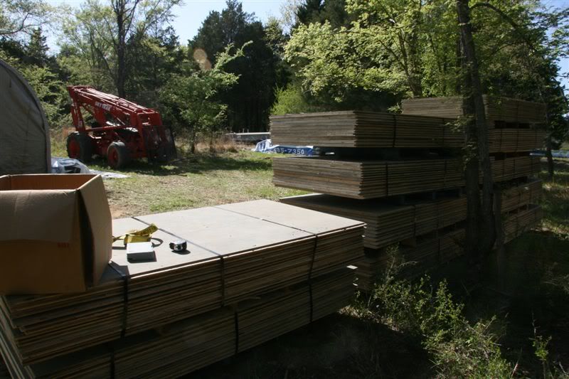

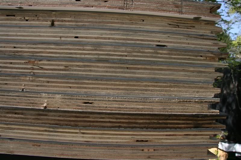

You said that ALL FOUR edges are T&G. Do you know if the panels are scant or full face? If they are scant face, they will quickly put a hurt on your I-Joist layout and in the end not fall properly on an end run designed for a multiple of four feet.
Some of the panels they had were grooved on all edges with splines for the ends. All the ones I picked up were T&G 2 sides only. The panels are full 4' x 8', not including the tongues. Thickness is a full 1-1/4". Only 1-1/8" of that is ply. These were uninstalled from a warehouse mezzanine that was heavy duty construction.
I ended up with 110 sheets for $1500.00. After seeing them, I believe the seller was truthful about the 100.00 retail price for each.
See if I can post some pics.
First one is warehouse where picked up. Next are the materials.
[/IMG][/IMG][/IMG][/IMG]
Maybe it will work.
