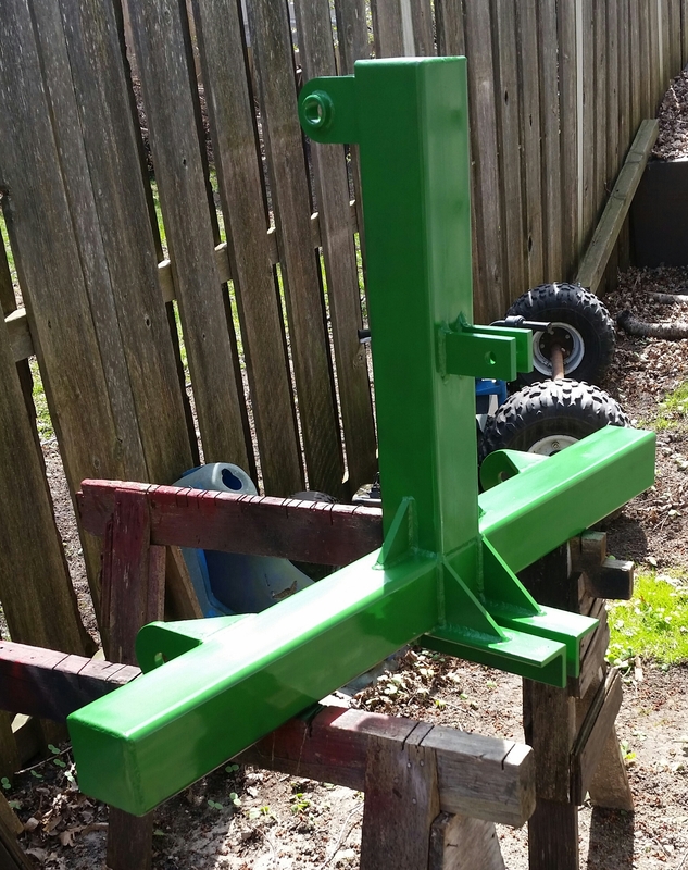

You mean like this?
It's hosted on Photobucket and embedded as HTML code instead of uploaded to TBN's server. I have this build on 3 sites, so it's a lot easier to just cut and paste the whole works over instead of uploading all the pics to the different servers 3 times each.
Sure is windy out there to be painting, but I don't have room for this thing inside.

Got it put together yesterday, but I've been working on the power SSQA upgrade and parked is as far as the subsoiler got.

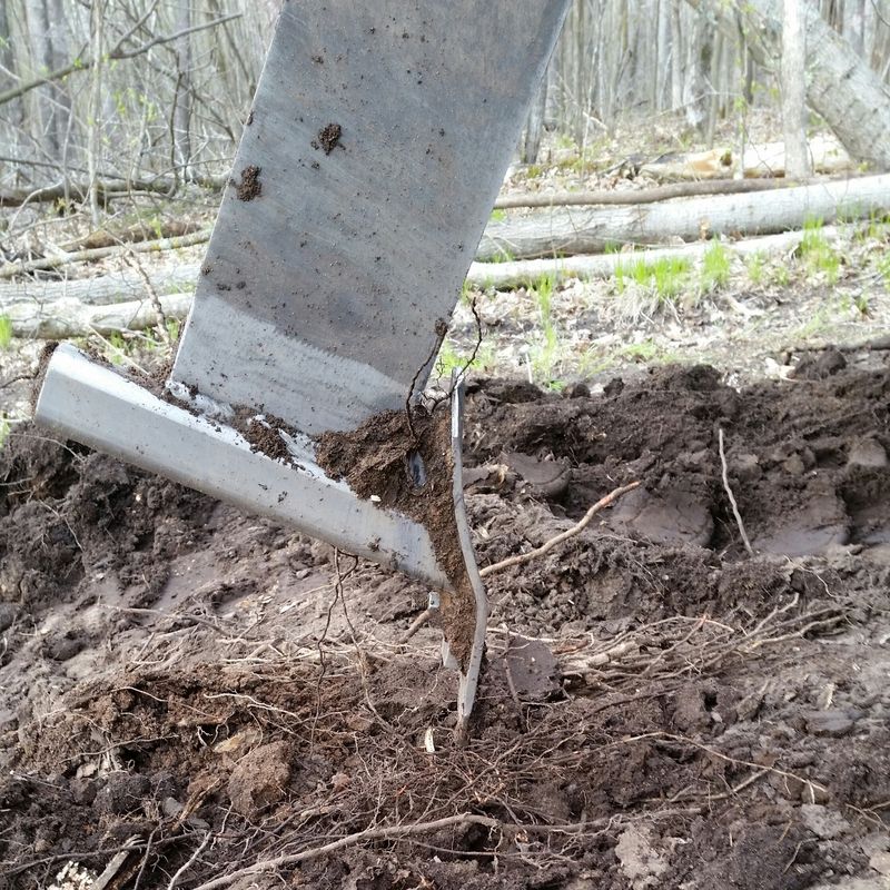

Put the SS to work Saturday.
First cut (hard to drive straight looking behind you)
Found some rocks
Lots of roots
Several stumps
Which eventually bent my cutting point
But that didn't seem to slow it down all that much. Then I tried tugging an oak stump that wasn't ground down, and wasn't all that rotten, and it broke the blade at the lower bolt hole. After that it didn't dive well at all, so I gave up trying.
I managed to bend my hydraulic top link cylinder eye during the pulling, so I'll need to fix that and as such, I left the SS up North this week. I'm probably going to get a ripper tooth for a excavator bucket to replace the cheap cutting edge. I had a feeling that one needed more support, more mass, or both.
And some action footage in 3rd gear:
I could've gone faster but I was on trails barely wide enough for the rear tires, so piloting the machine dictated the ground speed. :)

I'm going to see if Zeigler has any used excavator teeth I can grab, and if not I've got a good bit of 1/2" AR400 drops from cutting out IPSC targets that I can use to fab up a new one.
